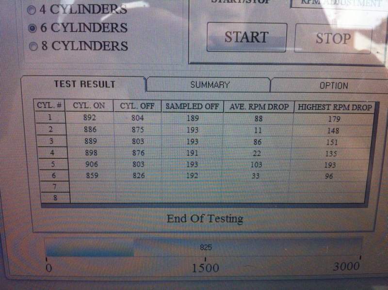

Still got this horrible running issue, seems to be worse from cold, would a turbo on the way cause this? im not smoking or anything and neither is the car, if im coming to a stop it bunny hops at low revs if my foot is off the clutch, still have this strange rotating rattly type sound at low revs with the clutch engaged as well, just a few things i missed when putting up the original post. :(
Ok finally found out what the issue was, car is now smoking like Thomas the tank engine as he chuffs down the track, seem to have a naff turbo, cylinder 6 is also dropped due to the vast amounts of oil build up in the upper plenum, hardly any boost at all not that i was trying. smokes from idle, clears under normal driving, but smokes on boost (all 3 psi of it lol). guessing seized turbo.
or the rings / piston has gone on cylinder 6. need to comp test the engine again. wondering if the comp test i did a few weeks back, was showing fine due to oil, but not enough to cause smoke.
