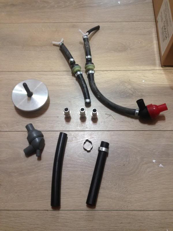

Thanks for all the help so far guys. My tester arrived this morning. But it looks more complicated than I was expecting.
What do I do with all these parts??
Many thanks

Tonight I have compressed air into the system and got 0psi. I removed the front bumper and have checked the placement and tightened all the clamps and then rechecked, again 0psi.
Thanks, just tried again and still zero. How long should it take to see any pressure there?
what are you using for your air supply
