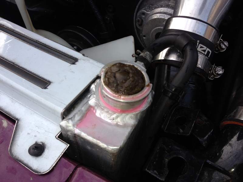

Need some advice here....... this is what it looked like coming out of the top of the rad.......
IMG_0285.jpg........... looks like chocolate milkshake.........
Trying to think of anything else that could cause this....... clutching at straws here...... right going to dig out my compression tester........

Is it oil and water, or is it rust, if yours has been sitting a long time or not had anti freeze could be rust from inside the block...
Does it feel oily between your fingers...
Doesn't feel oily...... just flushed a bit of water through and is now gone....... it could be from the crap inside engine as water level dropped a lot......

If your car has been sat for so long, I wouldn't give up on the engine quite just yet. Get your rad flushed out again and bleed. You probably have a lot of silt and shit in there. Try and identify which of the cylinders is down and check the connections on these. Injector connectors fur up easily and often as well as coil-pack connectors. If those aren't the problem, try another coil pack. Just try and go through a process of elimination. Have you cleaned ALL the connectors out?
Edited by Funkysi
Only just saw the photo. Looks like rust/silt, not oil. Take the rad out and flush it through completely. Your engine has just pushed all of the years of silt into that part of the cooling system - it does it with them all.

It'll take a good few miles to get the car running right if it's been stood. You may have got a bit of bore-wash too. I don't think that's a gasket failure mate. TBH, just stick a hose pipe into the rad to flush that top silt out. The rest of the system will have enough anti-freeze, you can do another flush after you've made sure it's running right. The only trouble with doing coolant flushes is that sometimes, it can dislodge previously undisturbed corrosion that could lead to a leak.

If it had blown the head gasket to turn your coolant into froth then it would have been smoking like a red arrow aswel.

It looks like Si and Terry were spot on..... flushed the rad and refilled with clean water and not getting the bubbling brown crap no more........ phew.....
