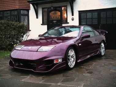

side skirts, rear bumper and boot spoilers are C1 veilside were imported from veilside and cost a small fortune.... these....
The front bumper was an original C1 but was replaced by my old insurance company twice after someone reversed up my driveway to turn round and smashed it to pieces..... twice!!!!
I was told they had got the repairer to order one from veilside...... turned out they got a copy and then refused to order a genuine one as they had put the car back to how it looked prior to the accident....
Ombudsman agreed that the insurance company had fulfilled their obligation and I had no case to force them to use veilside when a copy/pat. part was available at a cheaper price.....
I was not happy...... but had no choice.......
Bloody insurance company screwed me.....
Easy spot is the indicators on copy and original they are not there......
