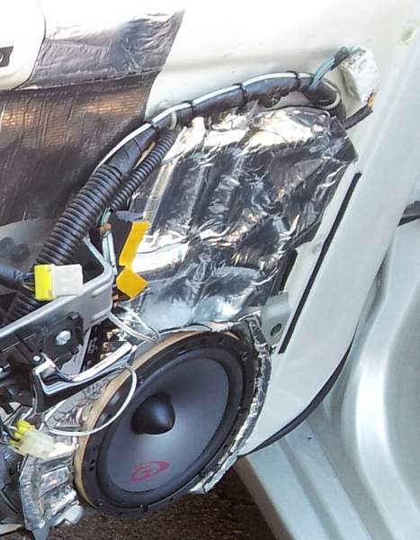

After buying these I wanted the rest of the system to be beefed up. I wanted a tiny amp, but something that would give me enough RMS to power a set of components which, from reading I discovered to be the best thing you can do to the audio in the Z as you raise the sound stage....so I bought these. I matched the speakers' RMS as close as possible to that of the amp.
Firstly, the amp. This little gizmo had an excellent review from Talk Audio's Adam Rayner and received strong reviews out in the market place, it's which is another Alpine product and is a booster pack/digital amplifier giving the output of my head unit another 2.5 times the power! I didn't want increased volume, I wanted increased clarity and paramount to this was package size! Small is best as I wanted to hide it and the wiring well away; it's all plug and play and ever so neat (I like neat). This pic, next to my hateful Blackberry gives you an idea on size. It's 4 x 45w RMS, so enough to power a new set of component speakers to reasonable clarity.
I stripped the passenger footwell out for access and unhooked and moved the main car harness which gave me enough room to fit the amp behind the lower strut bar. So it's very neatly hidden and still has relatively good access to ambient air - it's a digital amplifer, so it doesn't really need it. Alpine give you long enough looms and connectors for you to be able to run this amp to pretty much anywhere in the front of the car.
I haven't finished installing the cabling, but it's routed, just not secure. I wanted to power the unit before I did all that! If you see the metal bar at the lower half of the pic, you'll see a little black box behind it, that's the amp! You can see the cable feeds too and from it.
That cables are then routed back to the centre consol area and you plug the Alpine HU loom into it (which mates with the ISO connector) and then you plug the other lead which comes from the other side of the amplifier directly into the back of the head unit (which is the only flying lead that you need to utilise). It's all plug and play and actually frees up a lot of space behind the head unit. I was then able to strip out any unnecessary wiring and tidy up the speaker cables. I also added some edge grommet to those horrible metal reinforcement spars to protect against cable chafing. I actually want to ditch all of those bullet connectors - but not too sure whether I want to hard-wire the ISO loom to the Alpine loom.....
The beauty of this set up also is that there's not an RCA lead, signal lead or power lead in sight! I was able to strip out all of that too and it made me feel goooood!

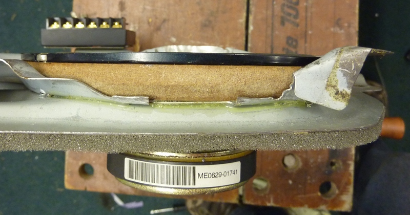

This is the stuff I used as edge protection - pretty decent stuff to fit and is pretty secure.
Now I have powered the head unit up and with only the rear speakers connected, it sounds so much clearer with more defined mid-range. I might get some slightly better rear speakers too at some point - the coaxial versions of my components. The current Alpine coaxials are slightly over powered and could do with something with a slightly higher rating. I can't wait to wire in the new component speakers!

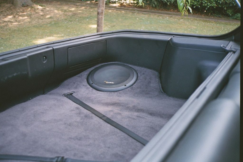

So what are you doing for bass?
As my spare wheel is going to be completely useless to me when my brake upgrade is completed, I was thinking of fitting a small sub into the wheel well. A little 6 or 8 inch sub or something. This way I can retain the full boot space but indulge in some bass heavy music from time to time without over loading the components
Amplified components appear to offer me the bass I need. I am not wanting anything more bassy to be honest. I got rid of my sub and don't want another one. I really only wanted clarity and volume of what you'd find in a reasonable new car.....the audio in my Leon FR+ being as good as I need it to be. Basically a quality VAG system.

Thanks Andrew; alas no, I have been trying to source some, except the foam/neoprene I always seem to encounter is too thin and/or to compact/dense. I am still on the hunt!
Here:
http://www.ebay.co.uk/itm/BOILER-CASING-FOAM-SINGLE-SIDED-4MTR-HAYES-BRAND-NEW-/151255570525?pt=UK_Home_Garden_Hearing_Cooling_Air&hash=item233788d85d
There are other vendors on ebay selling the same.
I actually did mine with 12mm foam sheet cut into 12mm strips.

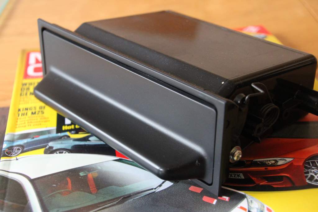

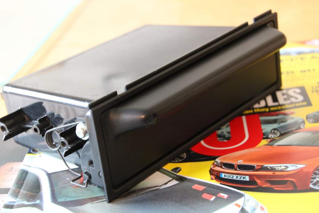

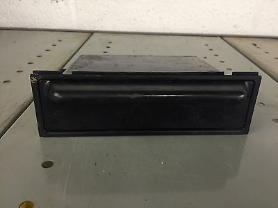

Anyone know whether the lower compartment with the door is still available?
Correct Andrew! Wondering whether they're available new?

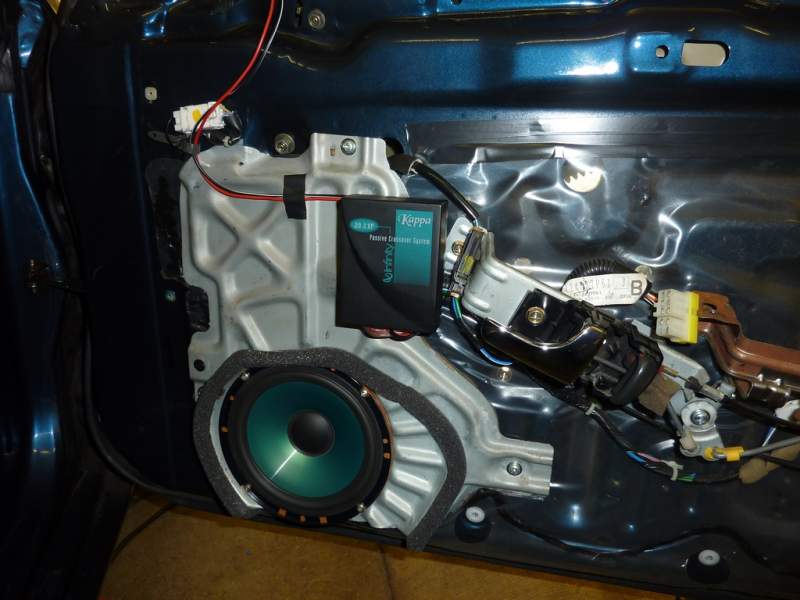

To fit these main drivers to the brackets, I followed AndrewG's advise and got myself some MDF speaker spacers, excuse the crappy quality of this photo!
Andrew has very kindly routed a 45° chamfer at about 5mm depth so that they'll fit the current brackets, but now allow larger speakers - I will need to do some more sanding to get them to fit, but this gives a great point on which to work off of.

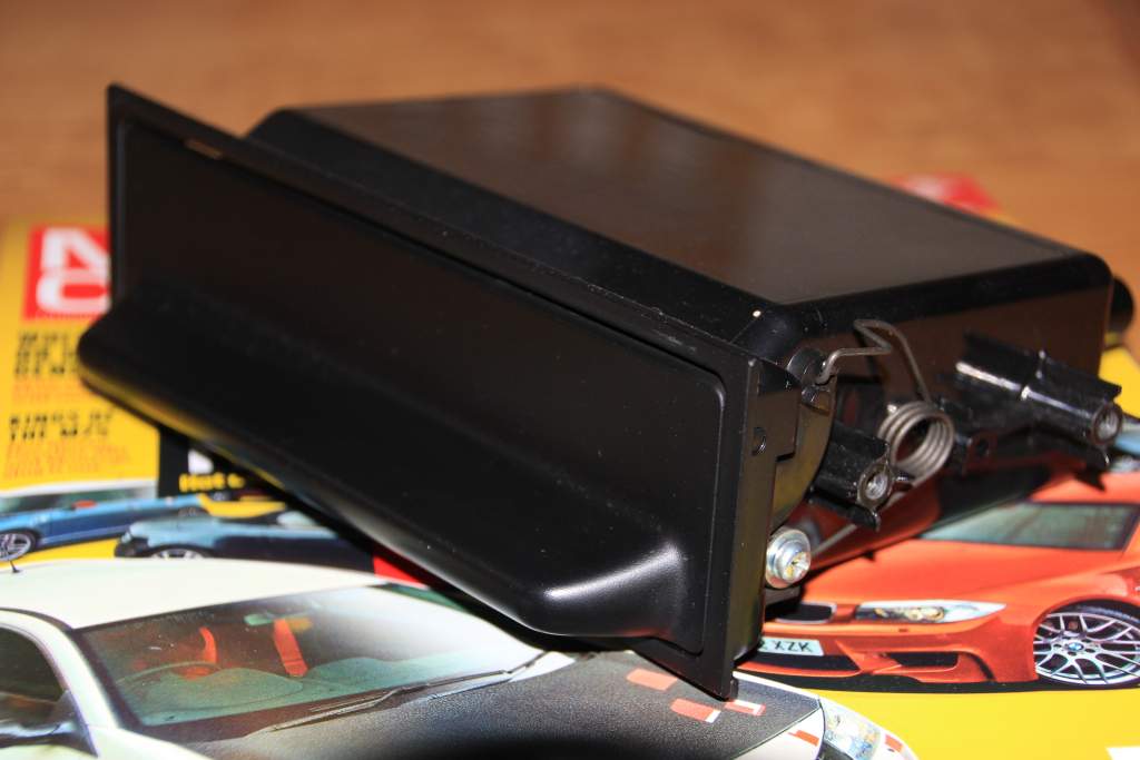

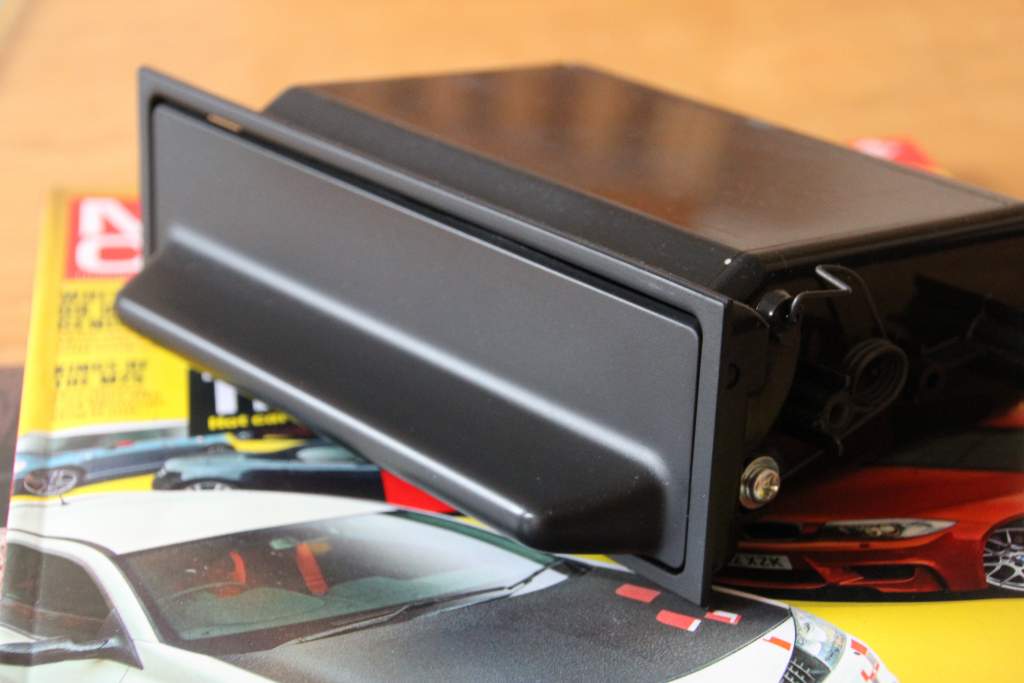

Hey Si,
I have one in "as new" condition - I bought it new myself about 5-6 years ago and it has seen very little use..... Plus I'm also pretty anal about looking after my things:wink:
I was planning on keeping it, just in case I ever decided to return to the 1-DIN set up too, so I'm undecided about selling it. If you have trouble finding one to meet your standards, I might let it go to a good home.... After all, I'd probably only put it back now, if I ever sold the Zed!
Richard:cool:
Hey Si,
Richard:cool:
If it's in pristine condition and free from wear/marks I'd love to have it! Thanks dude! Do let me know how much.

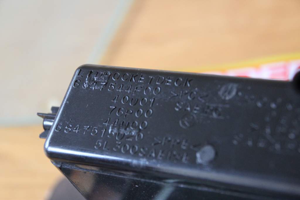

I have since found out that this part is used in the Almera and X-Trail models around 2001-2003, however I can't locate a part number for it. Would yours happen to have a part number on it?
I shall take a look and let you know!
Talk soon Si,
Richard :cool:
Talk soon Si,
Richard :cool:
Any joy Richard? :)
Thanks Richard, if you do decide to sell it, do please let me know, I'm very interested.
