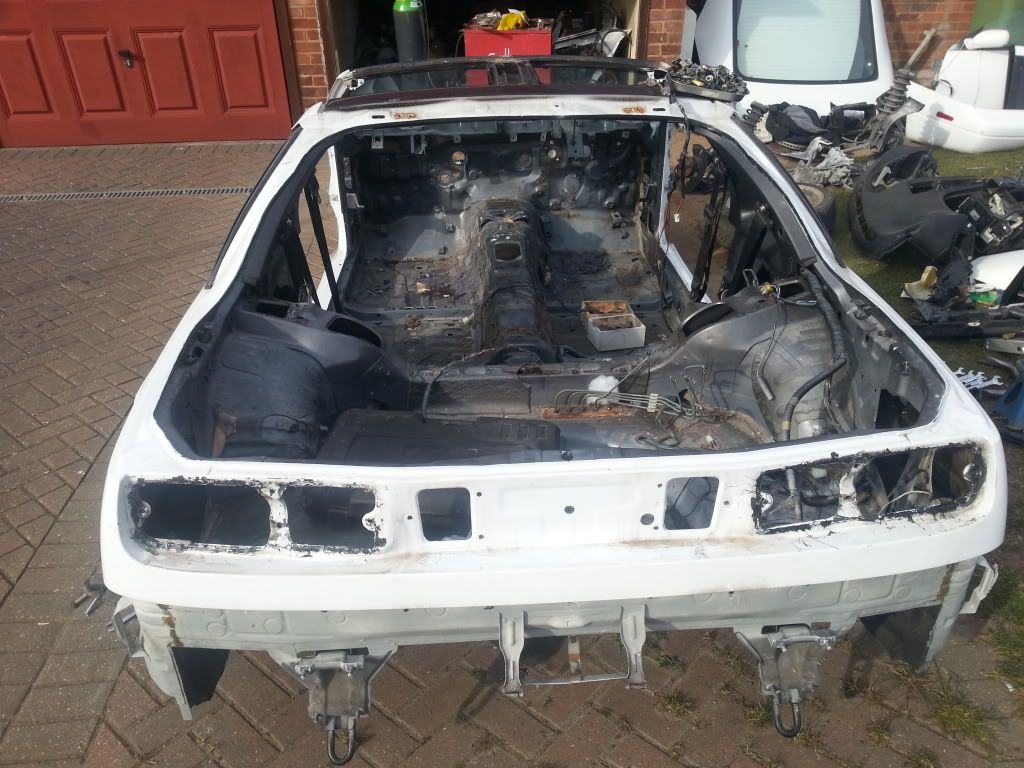

I've re shelled mine twice,
Its not that bad, even sprayed the whole thing before putting it back together.
When I had my unit took a week, strip it paint it and put all the parts from my uk zed on it...
So even the dash everything was off stripped to the shell...

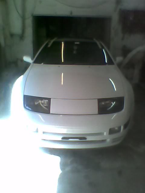

This was it finished
and I must have enjoyed it that much im doing it again lol
This is it now, its taken me a long time this time cause I've done it at home, I stripped it all then re under sealed it all,
Had to send it somewhere else to be painted.
and rebuilding engine and having to save up the money...
Im a mechanic so I work on cars, so it was ok for me to do the nuts and bolts, I allways mess up on the bodywork side of things and I've had to get others to do that.
But if u have the space and time go for it, your zed will mean a lot more to you in the finish...
