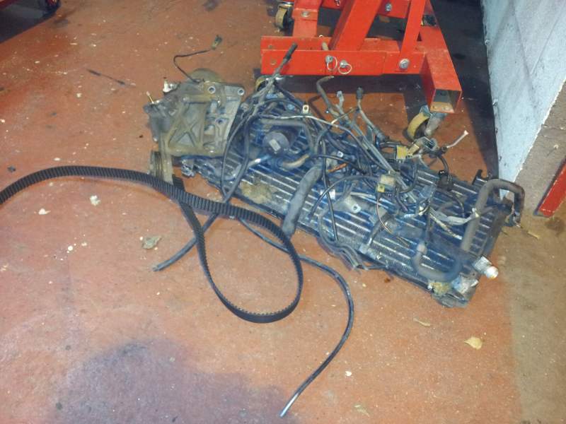

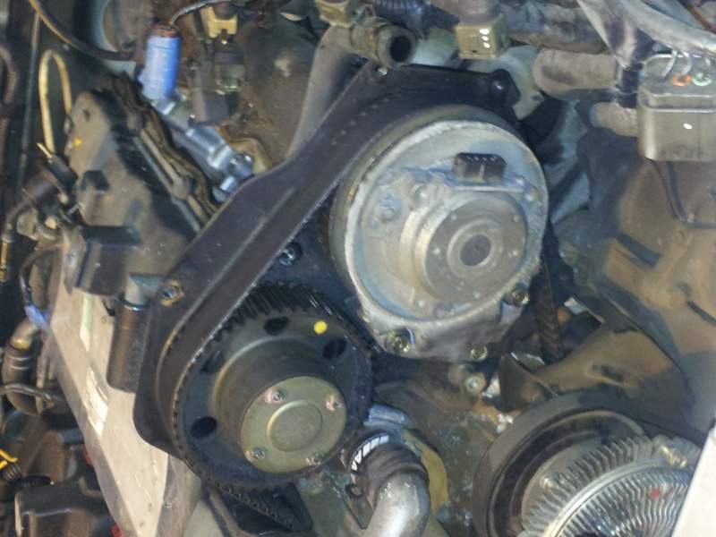

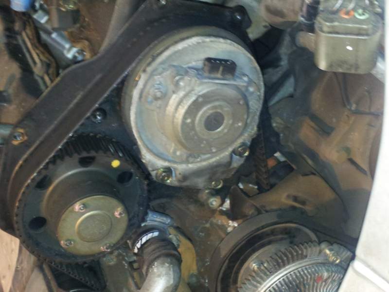

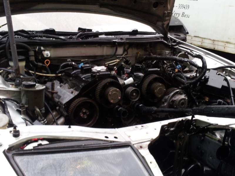

After another great day at Mr. Lee Dent's place today, where he is busy working on my Zed, when we took the timing belt covers off, this is what we found: -
More next post.

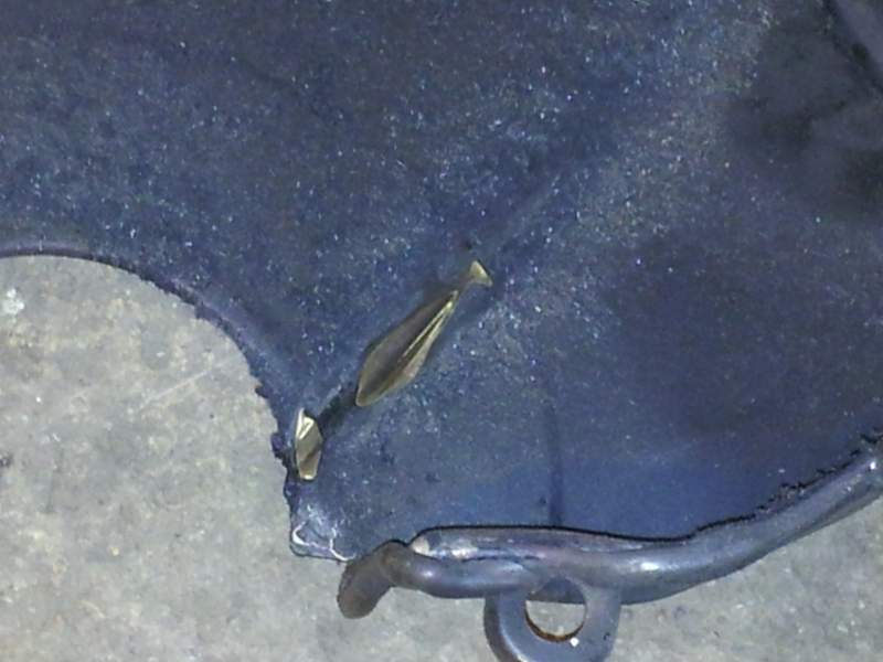

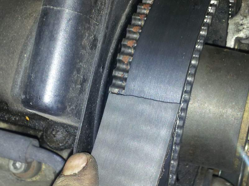

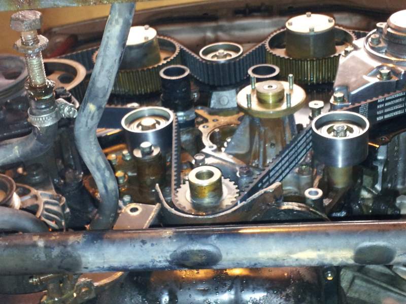

As you can see the belt is wearing very thin, and is a lot narrower than it should be, see pic of standard width belt and mine!!! We only just caught this in time, so please heed the advice of our Zed experts and keep an eye on your timing belts, as this could have ended up a lot worse for me.
No problem Gary, just shows what can happen, we reckon a few more miles and I would have been looking for a new engine. Always worth getting the timing belt checked if the history is unknown. My Zed was making no strange noises at all. So all new Zed owners take note, if you don't have a date of last timing belt change, it's worth having it done for peace of mind alone.

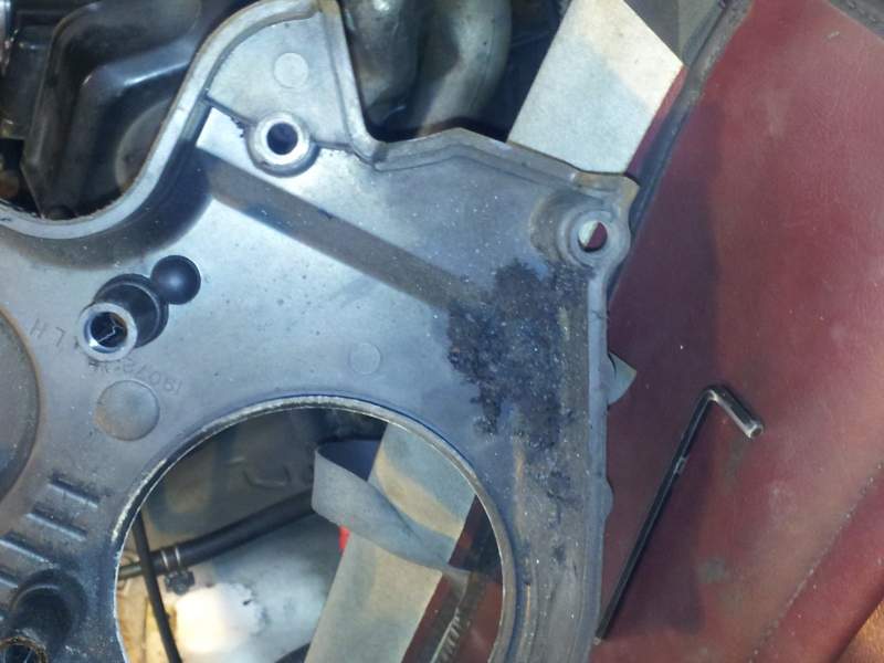

Very lucky to find this before it was too late . I will post up the cause on Monday once I have the crank pulley off:)
I also think its a blue print belt.They are awfully made and will cause problems like snapping before they are due to be changed..

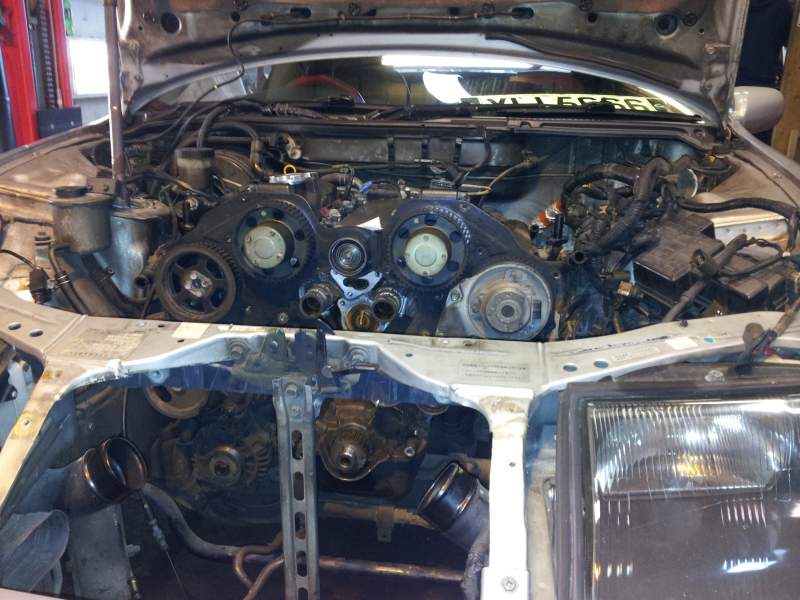

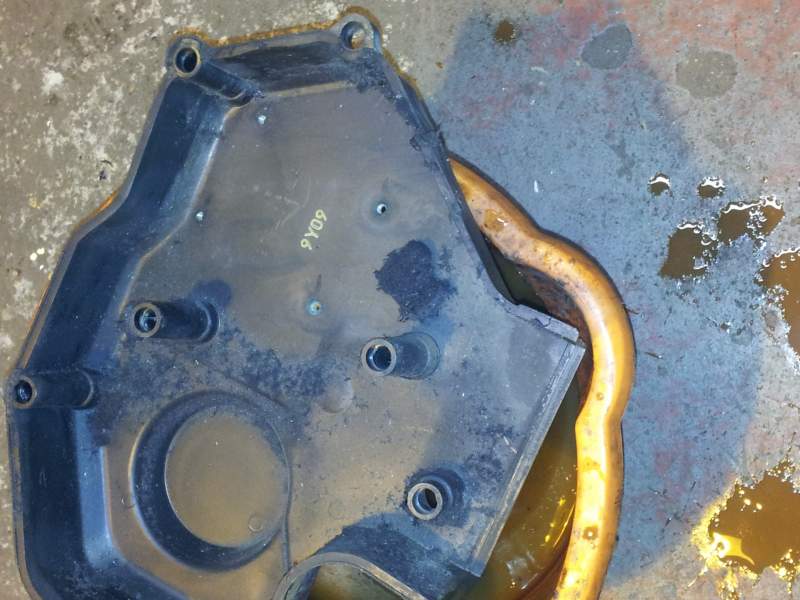

After removal of crank pulley and various covers, we found that the timing belt had been rubbing a nice groove into the cover, as you can see i n the picture. This was likely caused by some idiot prying the cover off at some point, bent it, but just refitted with a nice dent in it, hence causing the damage to the belt. Lee Dent, I salute you sir.....:bow::bow::bow::bow: Thank you for saving my engine.

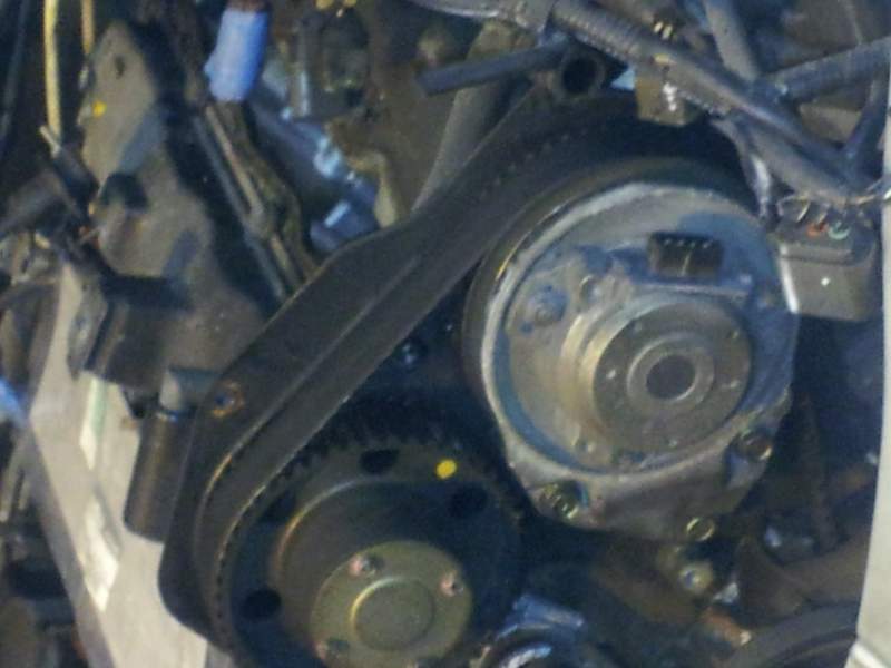

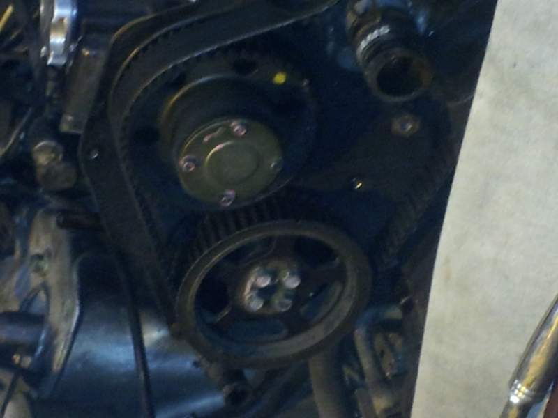

Engine bay being cleaned up nicely. The new timing belt in place now too.
