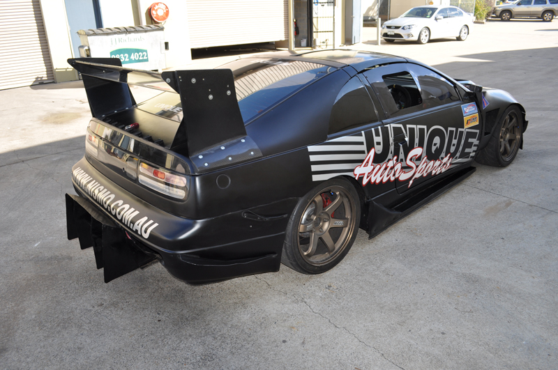

Unique Auto Sport Nissan 300zx
Time Attack
Wakefield Park - 1 min 4.65 sec
Oran Park South Circuit - 47.99 sec
Eastern Creek - 1 min 42.67 sec
Phillip Island - 1 min 45.84 sec
Oran Park GP - 1 min 15.16 sec
Western Sydney International Dragway - 10.709 sec @ 139.67mph (Street Tyres)
Engine
VQ30DET
Estimated Power
509HP at Wheels
Approx. Weight
1185kg
Power To Weight Ratio
0.42 HP/Kg
Engine Modifications
-UAS Valve Springs
-Daley Engineering Dry Sump And Integrated Pump
-Custom UAS Throttle Bodies And Plenum
-6Boost Custom Manifold
-GCG GT28RS Turbos With Stainless V Band Tial Turbine Housing
-Turbosmart Compact Gates
-Custom Ross Racing Harmonic Balancer With Trigger Wheel
-ID 1000CC Injectors
-Custom UAS Stainless Fuel Rail
Suspension & BrakeMods
-Custom UAS Adjustable Control Arms
-Roll Centre And Pivot Point Changes
-Bilstein PSS9 Coilovers With Eibach Springs
- UAS Chrome Molly Front End Brace.
-Front AP Racing 6 Piston Billet Alloy Callipers
-Front 375mm Alcon Rotors
-Rear AP Racing 4 Piston Billet Alloy Callipers
-Rear 330mm Alcon Rotors
-Willwood Pedal Box With Balance Bar
-Hydraulic Handbrake
Driveline Modifications
-PPG Straight Cut Gear Set, Custom Scraper Plate, Oil Feed. All Chryogenic Treated
-Custom Bell Housing Adapter
-Xtreme Chrome Molly Flywheel
-UAS Motorsports 5 Button Clutch
- One Piece Tail Shaft
- Custom Short Shift.
-Custom KAAZ 1.5 R200 Differential.
Chassis Modifications
- Extra Chrome Molly bracing
- Custom rear end and front end Roll Centre Pivot points changed
- Custom alloy fuel tank
- Perspex front windows
Exterior Modifications
-Custom UAS Rack Off Rear Wing And Rear Diffuser
-Front Bar, Bonnet, Targa Roofs, Mirrors, Canards And Side Skirts Made From A Combination Of Carbon Fibre, Plastic And Alloy Composites
Wheels & Tyres
-TE37 10.5 and 9.5
- 295 and 265 tyres
Interior Modifications
-Cobra Carbon Seat
-Grooverider Fabrications Roll Cage
-NASCAR Ballistic Blanket
-Electric Power Steering Pump
-Dry Sump Tank (Ex-NASCAR) Enclosed In Custom Box
-Turbosmart Eboost And Shift Light
-Push To Pass Button.

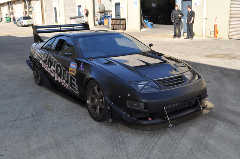

i like the rear lights and only cas they look whiter than norm even the top ones . woulnt mind that motor in mine when she blows.
It's Australian it's it? It's a pure out and out racecar iirc function over fashion sorta job. Bloody light though.
Not a pretty thing, but it is an out-and-out track car. I've seen a few videos of it and it's mental!
