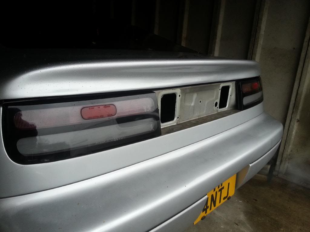

Here is how far I've gotten so far...
The heating for 5 mins didn't work for me.
I went for a bake of around 7mins in the oven itself.
The lights glided apart like butter.
No marks on the lenses and no cracks etc.
Well happy.
Watch this space on the mod I'll be doing.

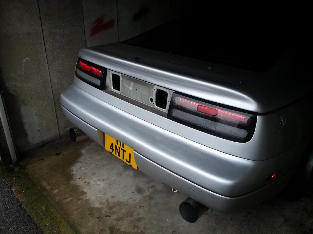

Look great ant, looks like your garage is a squeeze too I have to climb out the bloody roof lol...
I likey those. Just gotta get that black strip on the top half to mirror the curve on the bottom half. :D
Ant id say if i may if i was to be really picky , the bottom spread of defused light looks great with what ever u used but the top ,if i may u must of have used the norm red defuser thingy for the top ,id say see if you can get the same stuff that u used in the bottom clear with orange lights or clear lens at top with the red lights , u know what i mean do the same uptop as u done down the bottom. that said good job and love the bootom defuser
Thanks for the interest.
I would of loved to of done the tops in the red but I think that would of been a bit too illegal and the LED strips looked really tacky butted up right against the frosted.
I did get away with it for the inidicators however as they light top down.
I couldn't hit the brake light for obvious reasons but it is around 25% brighter than the top strips.

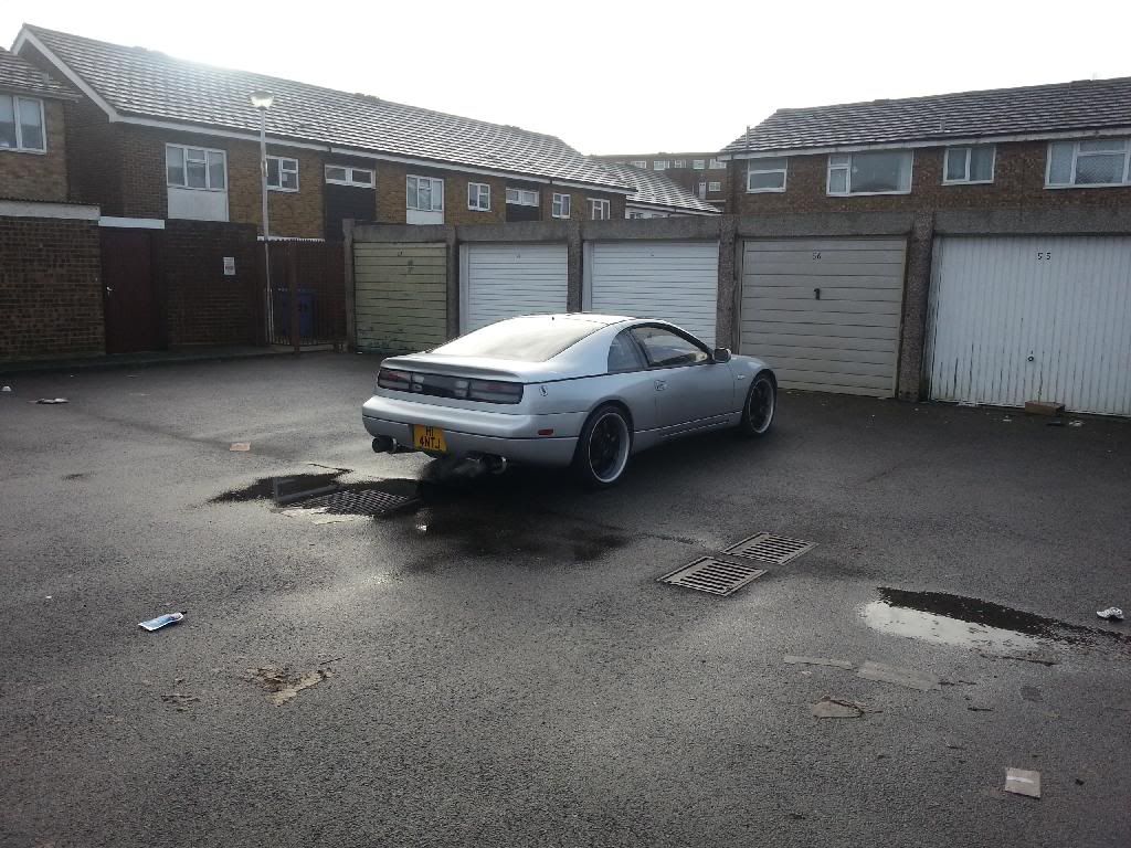

My car is loud, It's Japspeed divorced downpipes into an SS Billet 2.5" test pipes (no H or X mixer) and full decat (tailpipe also SS Billet).... I need my exhaust tailpipes levelled up with each other on the rear however. ***It was MarkyB's old twin exits***

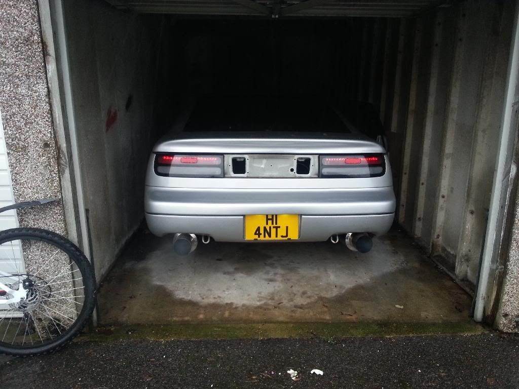

I hate my garage, but only one the council had in my area... A piece of cardboard is up the wall on the drivers side to stop my door whacking the wall lol.

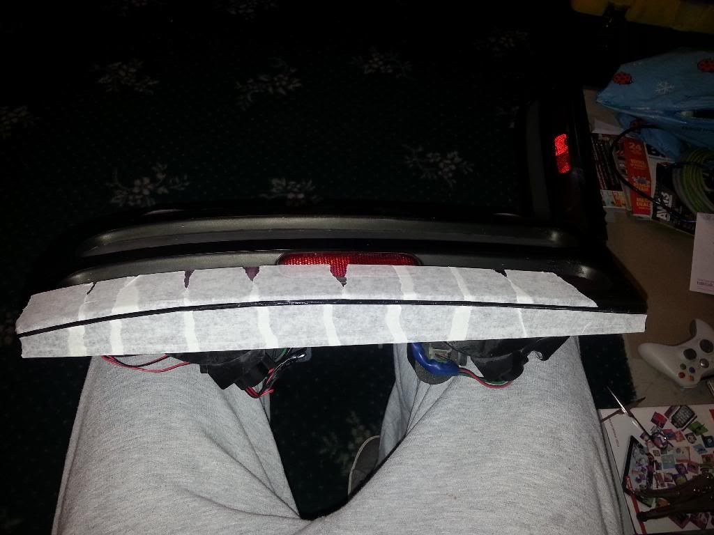

As requested by Phutumsch....
These have been cut down to size and duplicated so they go opposite ways behind the 300zx rear centre panel...
It's going to be my reverse light.
The fog and reverse are being converted to red LED fogs (so the original reverse will become another fog)
