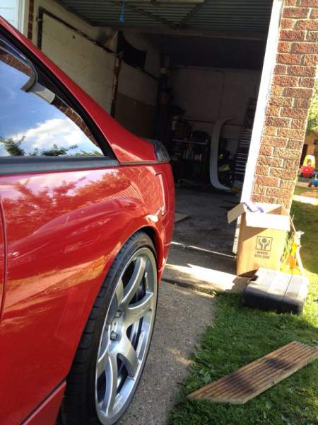

For reference, here's mine with 9.5j ET25 and arches rolled flat (tyre just misses arch by a whisker on compression). Yours will protrude an extra 24mm from that position... That's wide arch territory IMO.

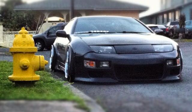

what about this.
Not for me though.
Horrendous! There are more photos on SoCal Z32 facebook page. The dude that owns it lives in Hawaii. Car looks completely ridiculous not to mention, dangerous! It's on airbag suspension. Just a joke if you ask me. The whole car is a heap of dung, the only decent part of it are the rear lights. Those wheels would work with a wide-arch kit if you put correct fitting tyres on it.
We can all pray that this stupid fad of stretched tyres and stupid camber will be over soon.
Look at the whole thing. Looks like it's been put in a microwave and melted. Just plain minging. Traditionally, this appeals to dub-loving hipster types who wear flat-peaked baseball caps, baggy 'below the arse, but with a belt' jeans and those strange hoop things in their lug holes.
