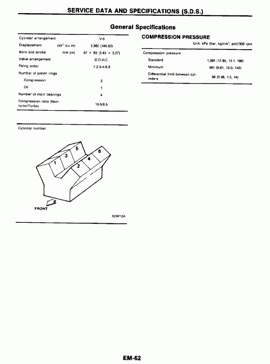

Can anyone tell me what order the cylinders go in if im standing in front of my car?
Cheers
Other way round if you're starting at the front of the car
Left. Right.
1 - 2
3 - 4
5 - 6

Just to clear it up.
Cylinders 1 and 2 are closest to the headlights. 1 being on the drivers side.

That's what I said wasn't it :confused: Unless the engine has been put in back to front...lol
