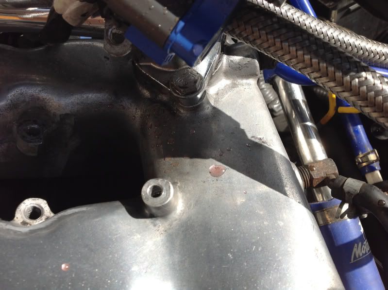

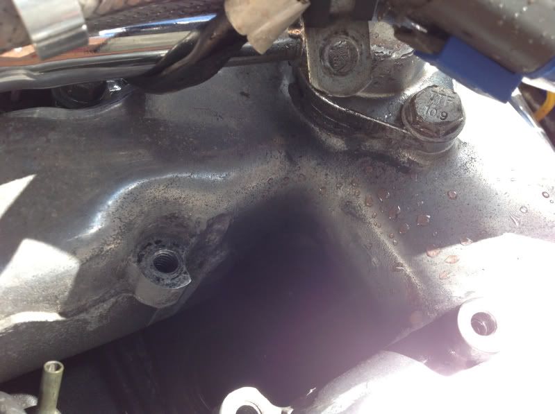

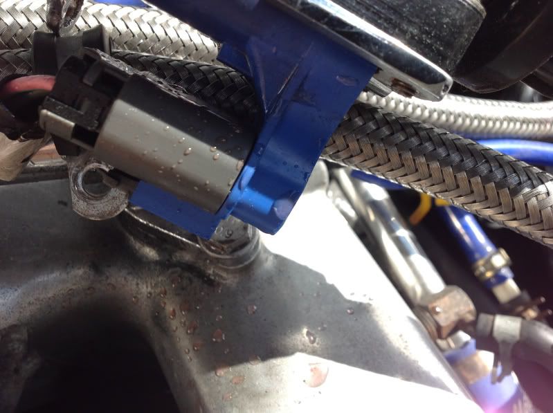

where was the drops of antifreeze you saw?
That plug looks wet... was it covered in petrol?
Yeah it was a little wet mate.
The water/antifreeze looked like it was on the plenum next to the where the coilpacks go. I'm notompletely sure it it came out of the cylinder tho
Membership No 0780
INSURANCE GOOFA
No as it wasn't wet when I started, that water would be blue too

That last vid to me mate looks conclusive evidence of head gasket gone across a water gallery....its pissin coolant out and it will be this water thats shorting the plug out and making it a plug down.

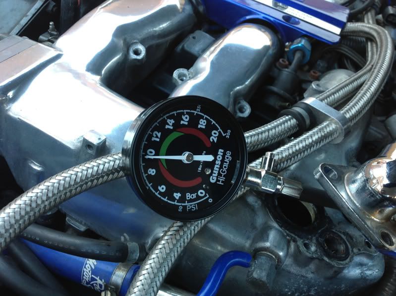

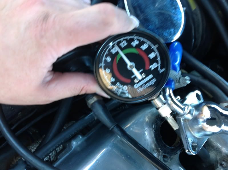

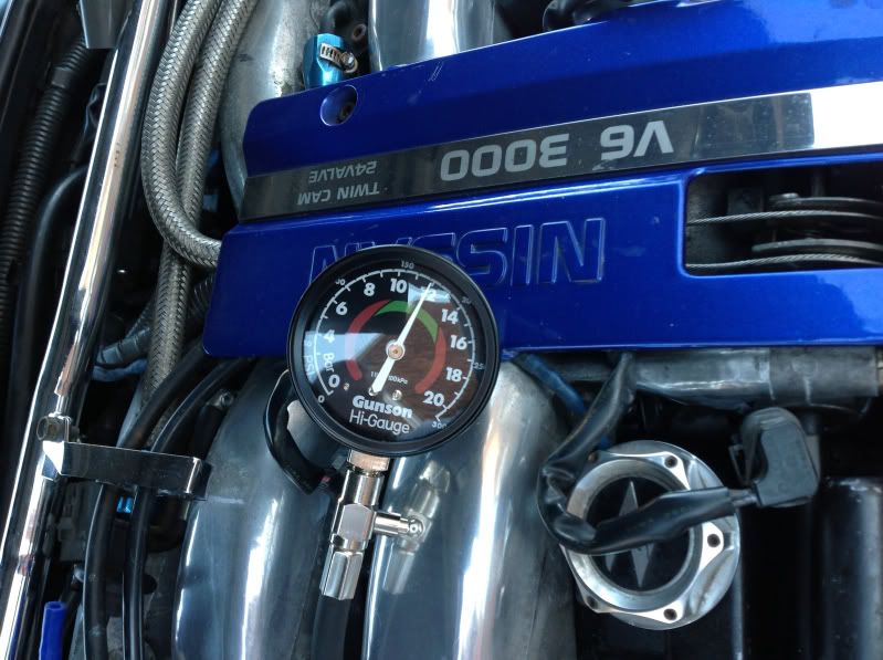

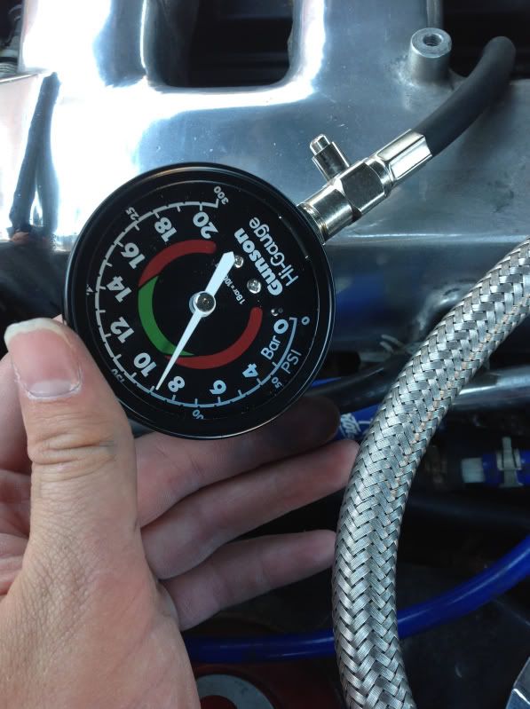

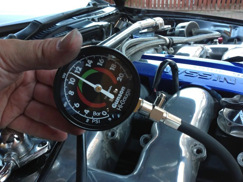

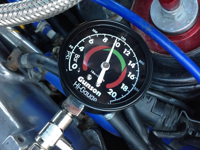

Compression test done (on a cold engine), I've put it in order that I did the test and I've taken a picture of each result
Cylinder followed by the result:
4 - 9 bar
2 - 9.5 bar
6 - 9.5 bar
1 - 11 bar
3 - 12 bar
5 - 11 bar
