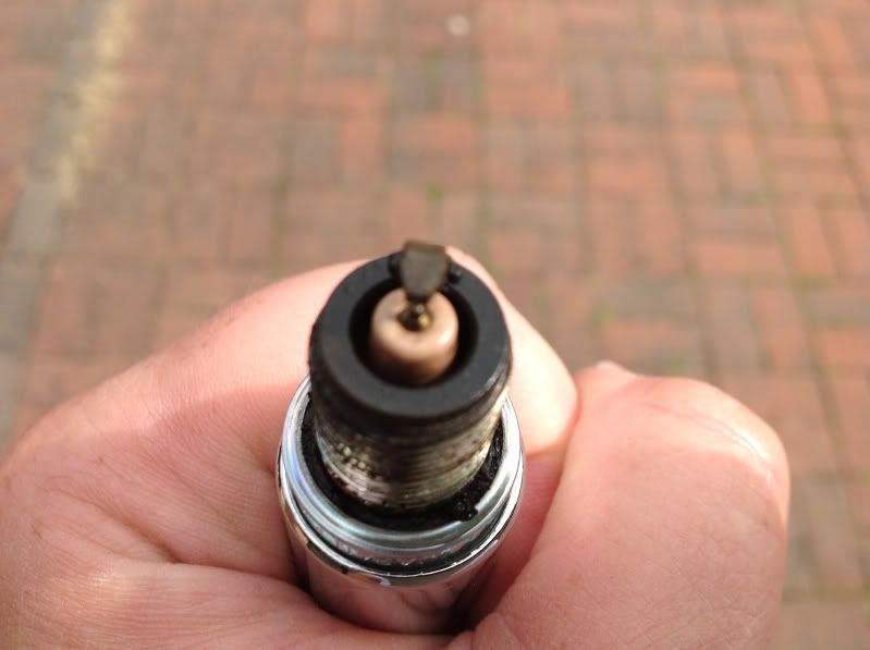

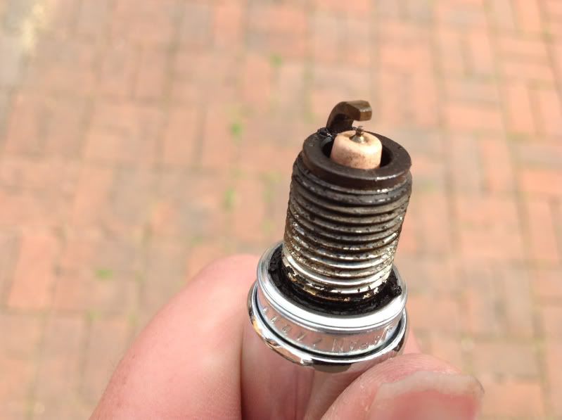

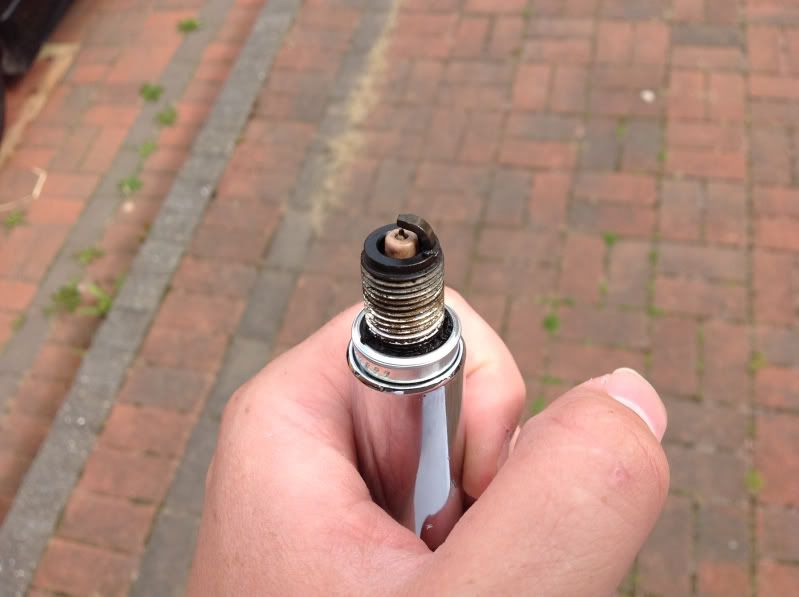

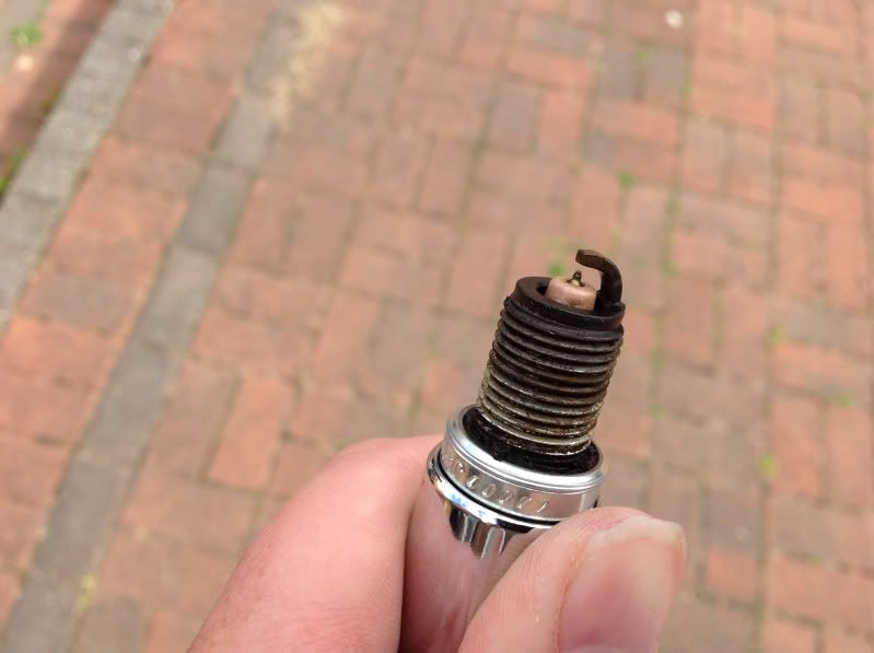

So when I took this plug out, I started the car with it out to try and ground the plug to the plenum. When I did the plug wasn't sparking at all. Just seemed dead.
There was also a bit of smoke came up and I could see what appears to be drops of antifreeze that I'm guessing got spurted out.
Anyway, I've found another plug and put that it. But then when I started the car I saw the top rad pipe little rally pissing out so I'm not sure if those drop I'd saw were from that cylinder or just getting blown up. Anyway, I took the coil pack connector off and the revs dropped. I guess I can't really check further until I fix the rad pipe out which when I squeeze, i can hear air coming out.
Any ideas of the bit of smoke that came up and potentially the antifreeze drops. I'm just wondering if its possible head gasket probs
