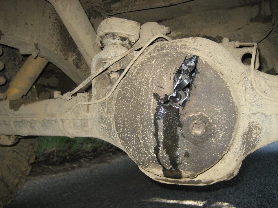

Does it look like this..........
[sIGPIC][/sIGPIC]
