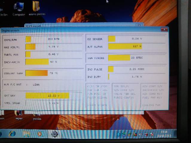

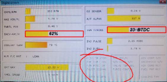

So as jeff had explained to me the goings on with the electrical issues and how they corrupt readings for other parts i firstly started with changing the maf which improved the hesitation but didnt eliminate it all.
so next i rechecked all the connections and adjusted the tickover.
next was to do the timing. It was at 22° btdc on the gun and around 24btdc on the consult. So i adjusted it to 15° ont the pulley and this made it very very laggy on boost.
Came back retimed it to 20°btdc on the pulley and it runs really well, full 1bar of boost no problems and no hesitation at all.
So a big thanks to all for your comments and help.
Edited by davezx
this is whats showing on consult now shes running well.
