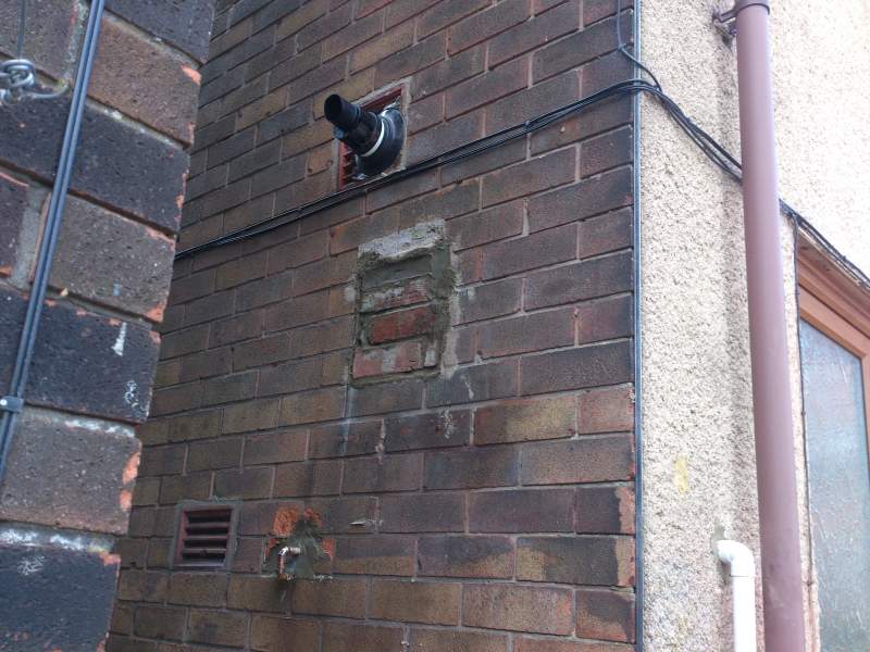

neighbour just had a new combi boiler fitted, got it done cheap apperently lol
cant believe some people would knock out work like this and that others would actually pay for it, terrible work
nope, filled the air vemt where the flue comes through with silicone lol
terrible work aint it
Unbelievable! And know wind prevention on the flue... The fumes will blow straight back in... You might want to move house!! Lol! Surely gas regs breached and unsafe installation to others?
not sure on the regs as im not gas safe, its my neighbours house and british gas wouldnt do the work as the flue blows out and hits my house, its not a prob as its only condensation more or less
my main concern is the blow off (15mm pipe that comes put the wall) its about 5 foot up the wall, it can have very hot water coming out if there is a fault, if charlie or anyone else for that matter is walking underneath we could get seriously injured, i use my alleyway a lot (its my alley and not thiers), im sure the blow off should come down the wall on the inside and come out a certain height from the ground?
as said its been so long since i doone any plumbing im not sure on the rules and regs
that's poor should that have a wind reflector on it and if the plumbing work anything like his brick work I wood be concerned
All joking aside, if you have that concern you need to speak with the council to get advice, the flue will emit gas fumes which in a narrow high corridor such as the alley, will build up especially in Winter, the flue should have been placed at the front of the house and if the Alleyway is your property and his wall is the border then he has built or modified his property over yours!
I am not a gas engineer so someone's welcome to pull me up if I'm wrong but I am sure this installation is wrong/ illegal on so many grounds.
What relationship do you have with you neighbour and did he discuss this work with you because his cowboys ( sorry builders fitters ) would have been working on your property.
On your own safety concerns to the family. I would reccomend a few calls to gas safe as well as the planning depertment of the council.
wheres the condesate pipe??? would,nt be supprised iff thats run into the cavity. That fella wants reporting before he kills or hurts someone
