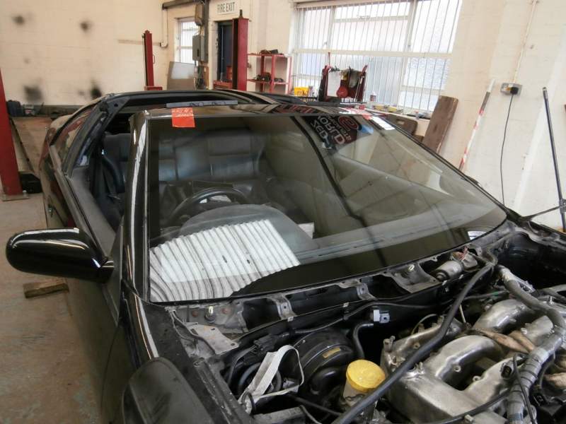

Not exactly exciting but a sparkly new windscreen just looks so good.....

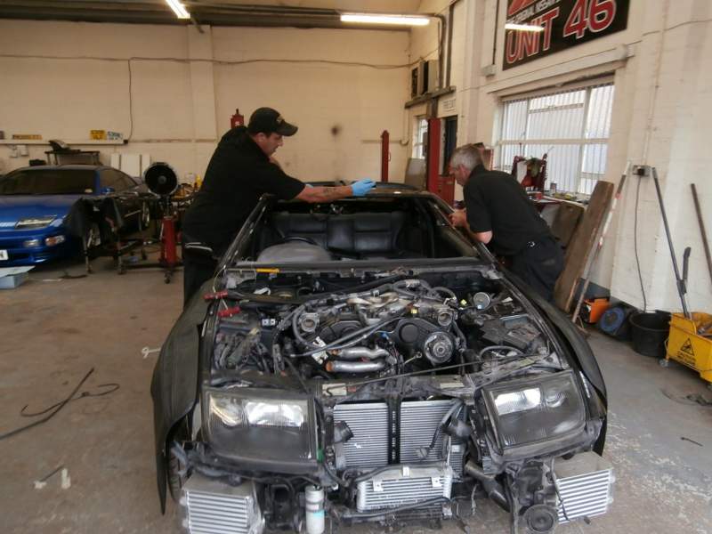

Sure did. I had all the glass taken out for the paint job. I didn't get all new, that would have been really costly. The rear screen for example is over £850. The rear quarters are £175 a side. T-top glass (which also varies in tint) I think is something stupid like £500 a side. Not too sure what the door glass is, but I spent a LONG time trying to find the best glass I could find and the glass my Z was taken from 5 different cars! haha. Windscreen is of course brand new as it's now manufactured by Pilkington.

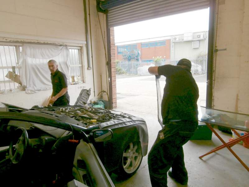

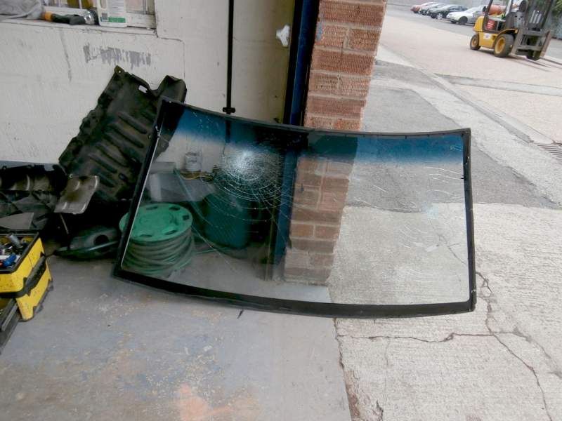

Both screens are bonded in, so it's a case of cutting the bond out. (My old windscreen broke, but the both rear screens, bronze and blue, came out fine.)
To cut the front and rear screens out, this gadget was used, it's called a Wibotec. Ingenious little device that you stick to the inside of the windshield with a huge sucker. It is a rotating tensile spring which pulls back after you pull it. I've had windshields replaced before and all they do is cut it with a knife. But this thing is ace and never seen it before.

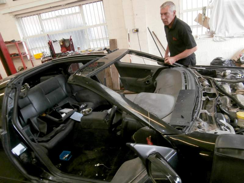

Threated a wire through the top of screen after peeling back the top seal, rigged it to the Wibotec and pulled it all the way to the bottom.....
...and then went round the top and down the other side.
...and finally, the whole screen can be removed. Excuse the dash, it's a combination of window spray the fitter uses and dust!
