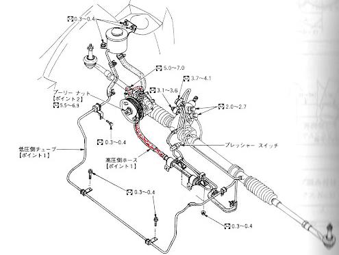

After stripping more out of the zed today I noticed that the power steering pipe work that goes
from the pas pot down and round was in fairly bad shape so I've removed it all.
Question is can this pipe work be ordered new or can I simply replace it with rubber hose.

Iff you mean the fatter of the lot then its only a gravity fed pipe to the pump...i needed one and was shocked at the nissan price for it (cant remember now) so i just used generic rubber hose with the same inside diameter size..perfect.
