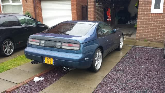

Not really new, but finally a Z32 owner
After a 500 mile round trip I now finally the owner of a Z32!
Taken long enough I know. weddings/ house/kids kept getting in the way.
Picked up a SWB, manual, na, slicktop yesterday.
Many thanks to Tel (bartfaster) for the warm welcome and easy transaction.
Couple of wee niggles to sort pre-mot. Anyone got a front washer motor going spare?
Anyway. some pics.
Apologies for crappy pics. taken on a mobile and its lashing down.

Spent the day sorting out the MOT issues.
Washer pump turned out to be a loose connection.
Moved fog light switch to a more sensible position.
Rear number plate light was a loose fitting bulb.
Just the emissions to worry about now. Got underneath for a good look at the decats today and they don't have lambda sensors fitted. I purchased the old cats with the car and the sensors and snipped wires are still attached.
Gonna be a pain in the arse to wire back in if she needs the cats for the test.
Anyway. Tuesday is test day so cross some fingers.
shouldnt need the cats for the test... good luck with it anyway.. sure it will pass with flying colours...
As said it shouldn't need cats, the O2 sensors sit up near the block. The two little cables near the box are cat overheat sensors and do very little.
Ahhhhh. That makes more sense.
Couldn't see that far up as only had it on a single axle stand to get the under tray off. Learn something new everyday
