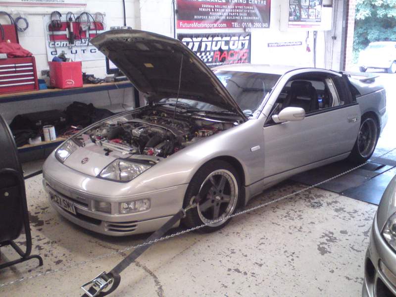

507bhp what do I win? :)
what happened at the end of that video, seems your rear wheels kinda just stopped dead.
im guessing for 514bhp

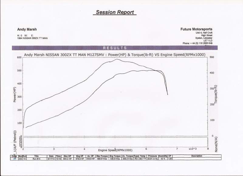

Well having just slapped an off the shelf chip and you could see the results of this on the youtube vid in the lead post, it just goes to show that you need someone like Noz to map a car properly, he also set up my EBC, so thank you sir for your efforts on the day, the car is certainly much more responsive as you'd expect.
So here is the dyno print off he gave me, this was run 14 it seems :yes:.
We have therefore 579.9HP at the engine and 504.2HP at the wheels - not bad at all and I'm delighted as I thought I'd be in the mid 400's somewhere, I've practically doubled the power from out of the factory :biggrin:.

I bet your pleased with that! What a power figure on such a good looking zed. Best of both worlds!
Fantastic result matey!!!!!!
I'm now looking forward to my visit :)

I have been waiting nearly a year for the day I could rolling road my car as it would tell me what these tubs were or are like, I think reports and general opinion are that they are pants, 'they must be because they are not 2k' :tt2:.
This is the reason I haven't been shouting from the rooftops over them, and even a reluctance in this very thread in fear of being slated but I love them and what can speak cannot lie.
Results will be revealed a little later but it seems some of you now are barking up the right tree :clap:.

Nice result, was the fire extinguisher just there to stop the pipe rolling away, or were you worried about the flames, lol.
if you've had them a year and they are behaving, few track days aswel hasn't there been? then its sounding positive.
Yep, had them in for over a year now and when you consider I enjoy the boost very much every time I go out then I'd say 'come on in the waters lovely' but people wont and that's fine with me !!
Not had a track day with them as yet, not sure I even want to thrash my car around a track, my last track day was with the stock ones and a slipping clutch, so hence before the engine mods, one final hurrah you could say :laugh:.
Both of the above I suppose :biggrin:, but yes it did keep rolling off to the side :yes:.
