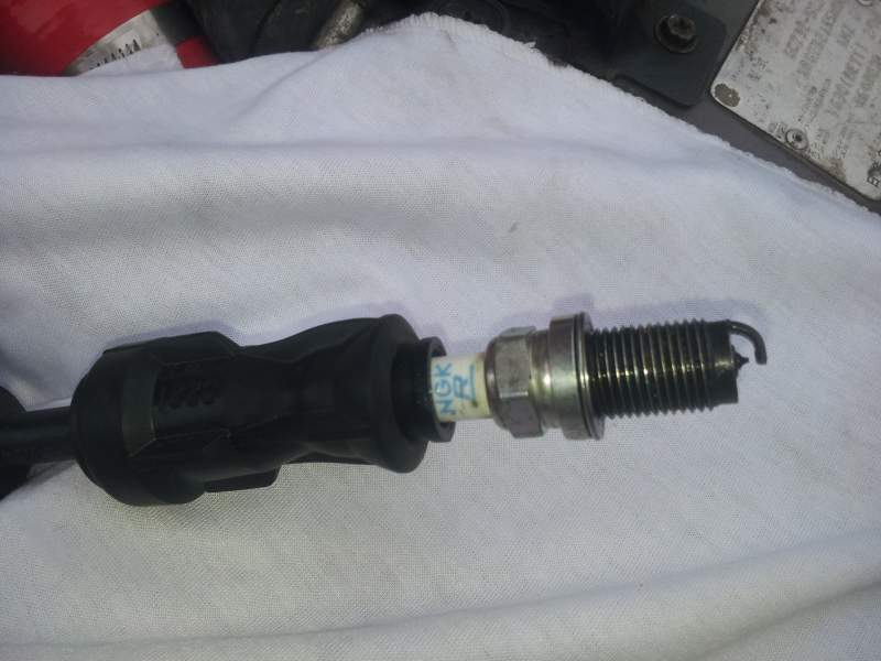

Right then: I didn't do all the tests yet, but it is now the front cyinder nearside that is not firing. I'm not sure how the cyinders are numbered, is that number one? I didn't remove the plug yet but I will bet it is blacked up.
Got a pic of the plug I swapped out of the middle cylinder neaside (number 3?) on Friday So here it is

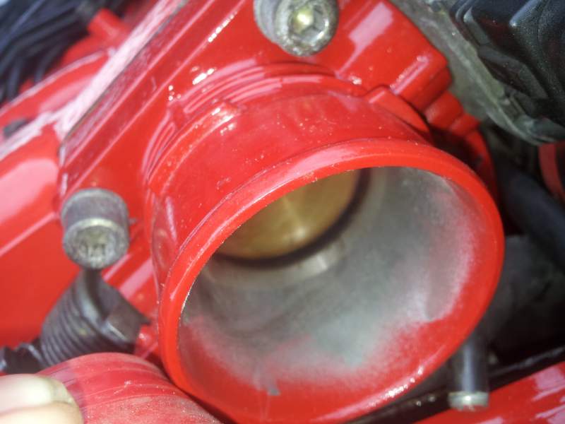

Took off the intercooler pipe nearside (the smoky side) and got some pics. It looks pretty clean in there to be honest.
