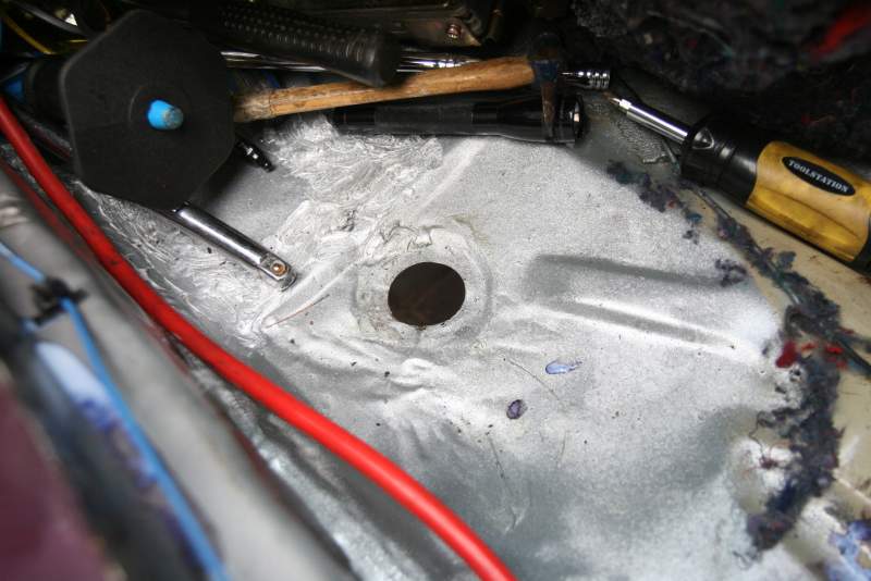

I got underneath the car to do some sealing and rust preventative and managed to make 2 holes using the wire brush and a paintbrush covered in underseal.....
Can anyone advise me where to source section of panel I need ?
I want to cut out section and replace.......
I am trying to track down anyone I know who can weld.....
I am going to clean area up later with drill and wire brush to see how far the rot has crept......
Is this sill section or floorpan?
any idea of thickness of metal to use to make replacement section if I can't get replacement?
I even thought about aluminium mesh and JB weld for about half an hour......( I was a bit depressed when finding this so please forgive me!)......lol
I am getting more and more upset finding how many things need doing now.......

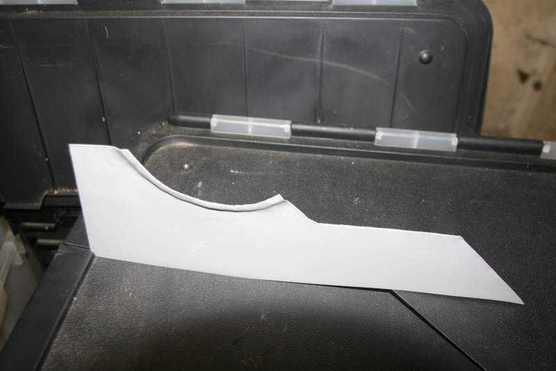

I started by bending by hand round the former I made and then went to the shot filled hammer to help a bit.....
I decided to try as few a cuts as possible and managed to get away with 2.... once I have tacked the cuts together at the ends I am going to try to shape it a bit better....lol

Well made the closing piece for the inner sill and tried to replicate redwine300's panel from his repair..... The pictures helped me loads.....
I have cleaned the piece up with degreaser and sprayed with Upol weld 2 high zinc primer......
It's ok but may try to get a better flange on the hole as it still shows the tooling a bit.....

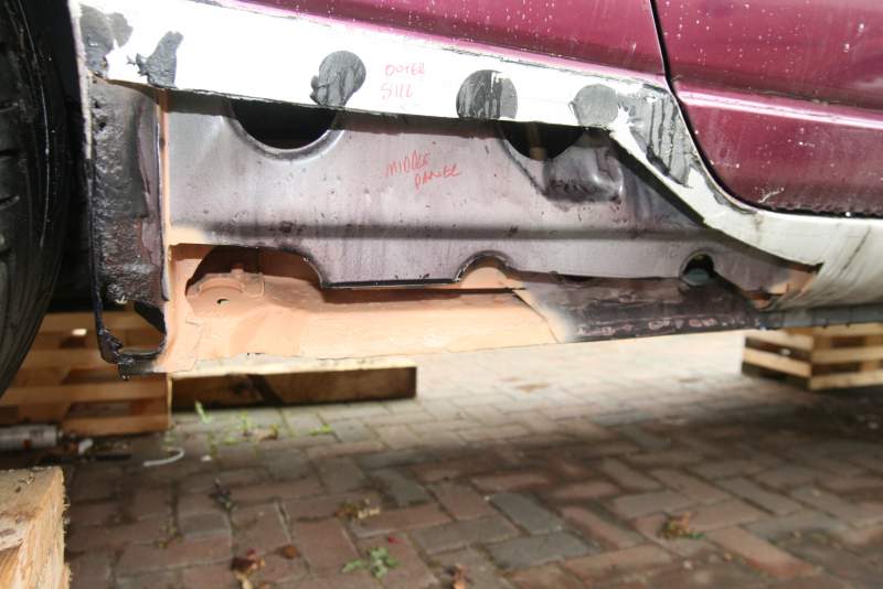

Looks like I can get away with just the rear qtr section as the rot stops before the join with the front sill section..... yay some good news...... lol
It is a case of making section for the centre strengthening sill pieces with the flanged holes in them and a new rear quarter bottom piece, that is covered by the skirting kit anyway....
I am lucky it's covered, so if the welding isn't too pretty I can make it solid and sealed, paint it and then cover it.....lol
It would be a lot easier if I had a shaped piece for the rear quarter from the swage line downwards....

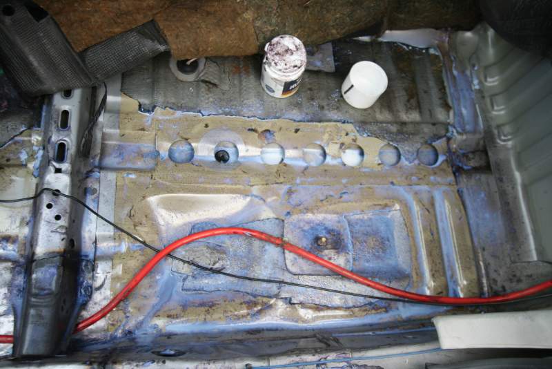

Right, finally my son is asleep....So I pulled the passenger seat out and found loads of surface rust and old welds from accident repair as expected.......
I vacuumed out and cleaned the floorpan and then covered everything with Kurust to kill the rust off.....
I am letting the rust treatment dry out before I get to work with some hammerite smooth silver to make sure that no rust returns for a while....

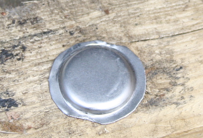

Then I test fitted my homemade floor bung... I made this from some 0.9mm steel formed between a 42mm core plug and a 38mm core plug, using a 36mm socket to press the shape into the steel....
then I flattened the plate round the indentation using a small hammer and trimmed to a circle....

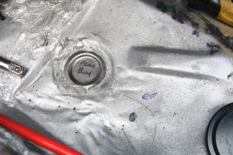

Now all I need to do is paint it and fix it in place......
Nice work mate but did you take a wire brush and remove as much surface rust as you could first?
Hi Steams, yes used a drill with wire brush on it.... then hoovered all the loose stuff out and then wiped with clean cloth.... lol
Now I have found the rust.... It's gonna die...... lol
