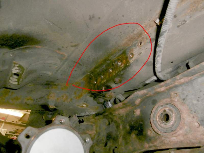

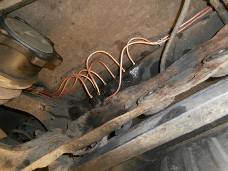

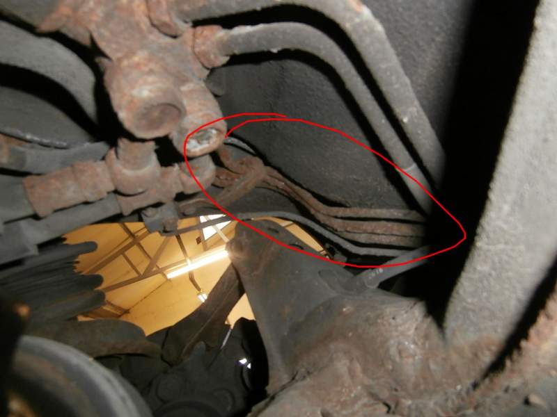

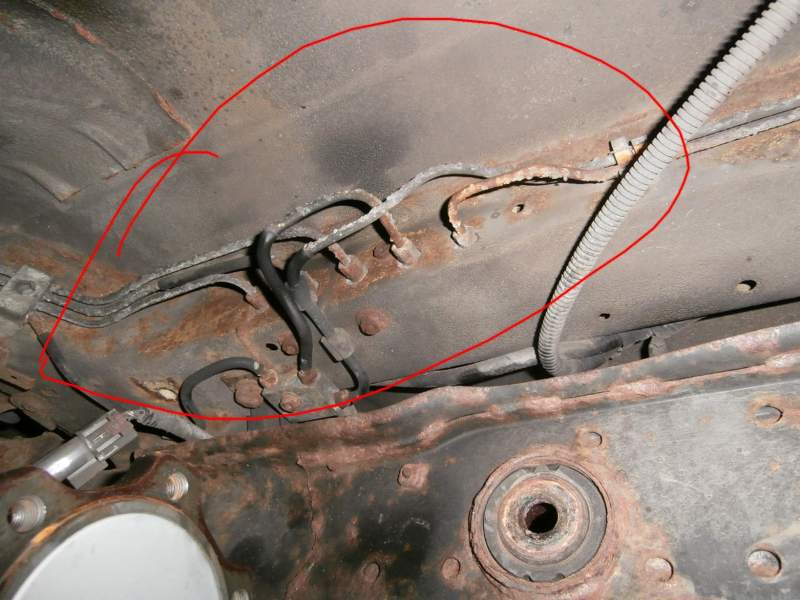

Not a bad job, much easier on a ramp of course, done many of them over the years and remember the diff needs removing.
Jeff TT

[ATTACH=CONFIG]71058[/ATTACH]
[ATTACH=CONFIG]71059[/ATTACH]
[ATTACH=CONFIG]71060[/ATTACH]
[ATTACH=CONFIG]71061[/ATTACH]
[ATTACH=CONFIG]71062[/ATTACH]
