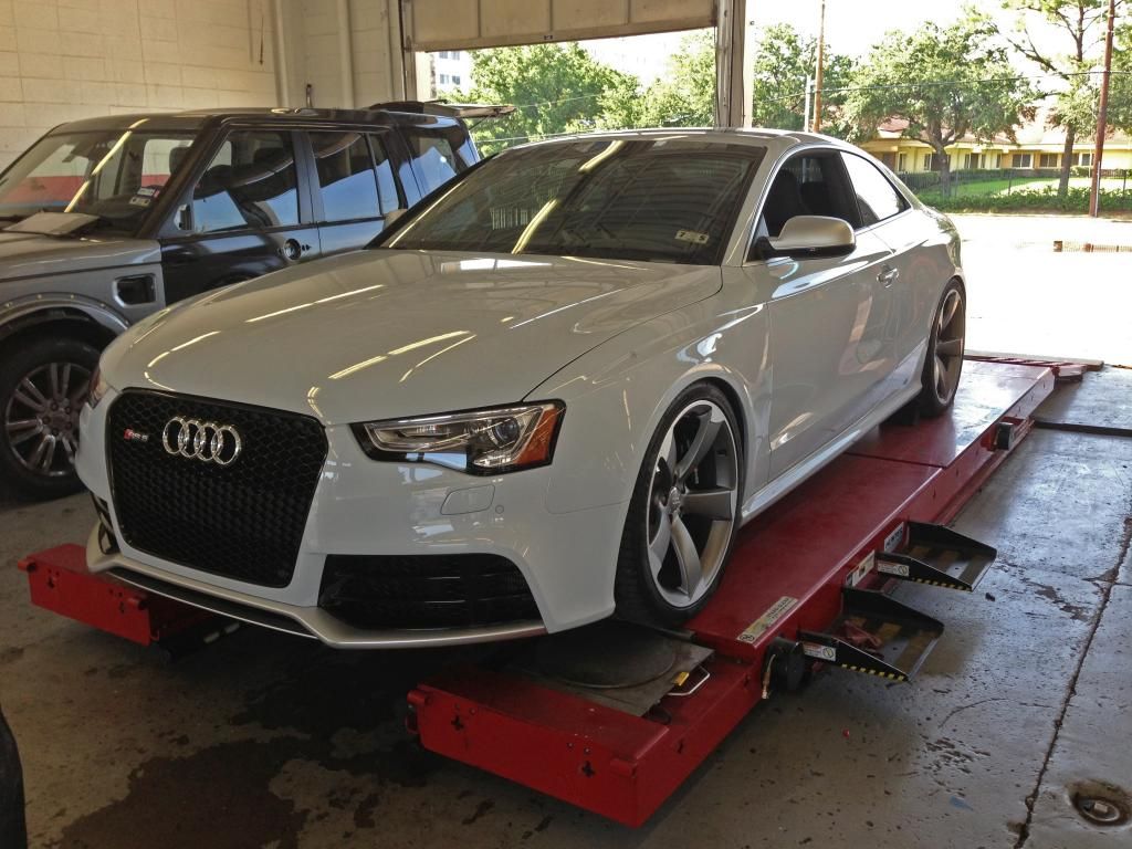

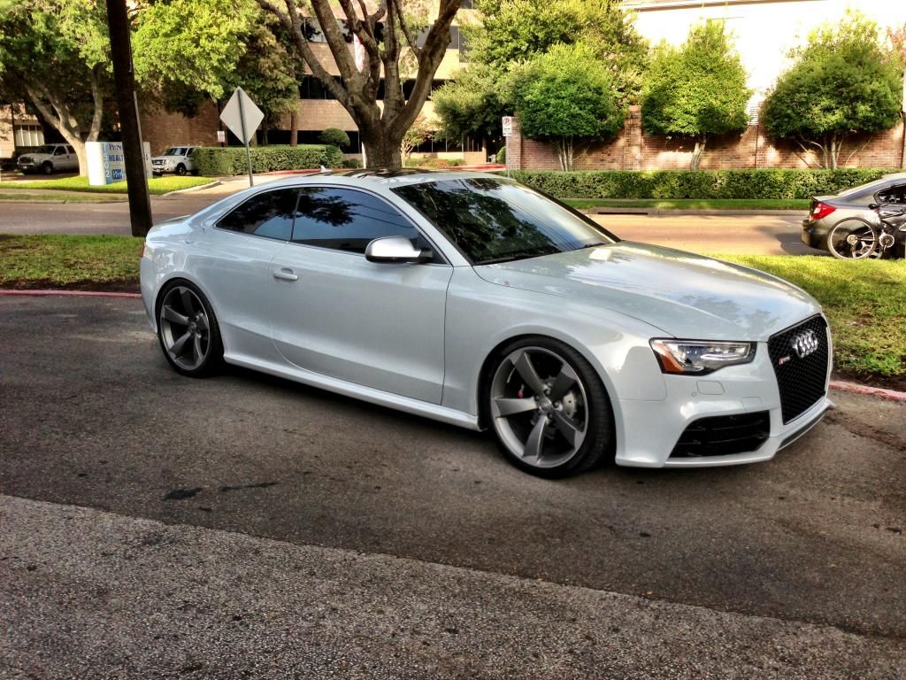

Heres a couple of pics, I'll put some more up tomorrow.
Hopefully couple weeks it will look like this again..

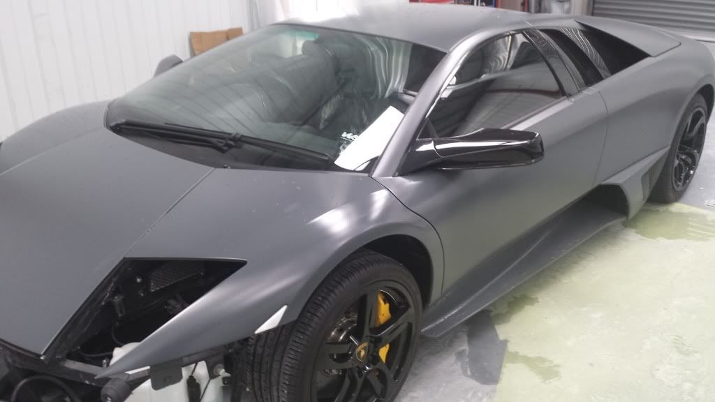

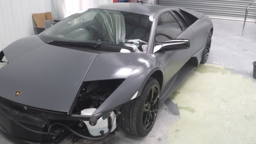

Went to my bro in laws work today, sorting some bit out for respray,
And this was what I found...

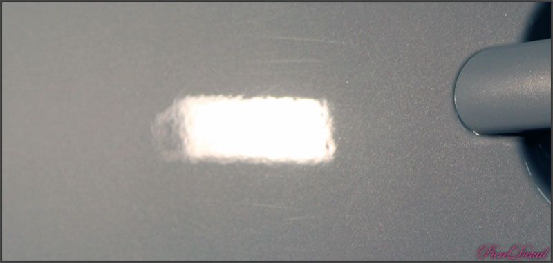

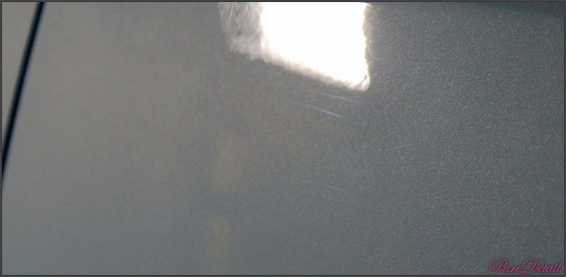

but have a couple more pics of the colour I've chosen;
Suzuka grey,
Hahaha Jesus.
Nice one
