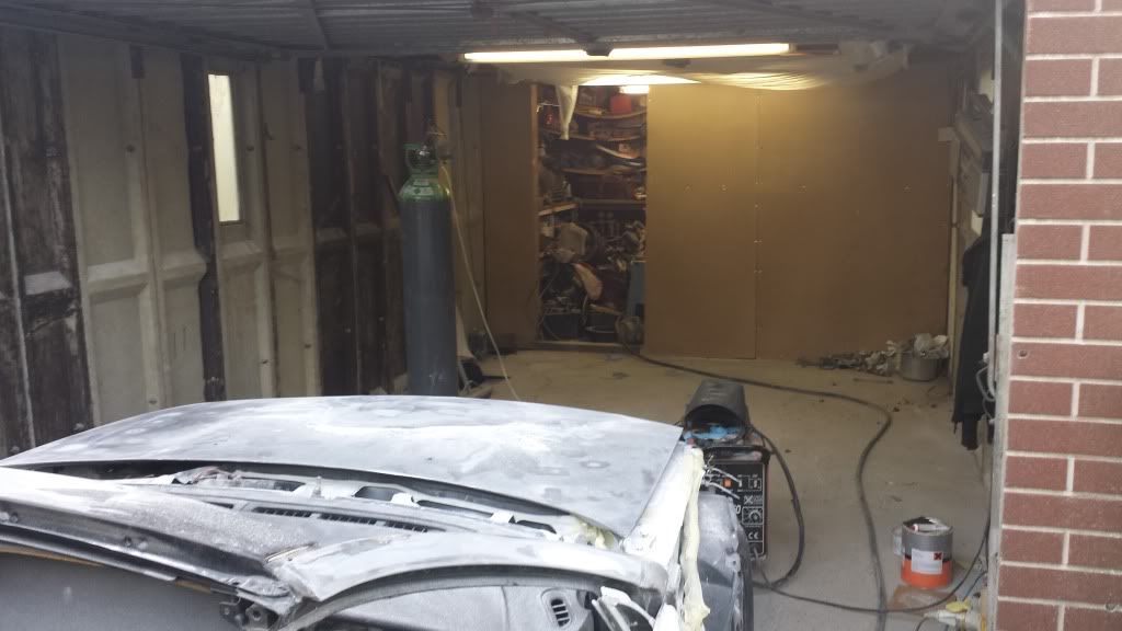

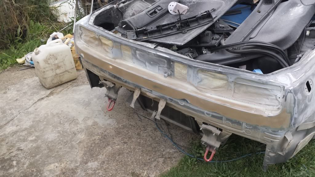

Hi guys,
My new shell came today, from sussex stu.

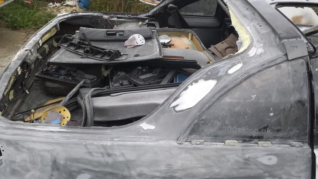

so got on a mission, took the doors, bonnet, wings, tailgate off.
swapped them with my ones.
stripped the engine bay, got to jet wash it tomorrow.
Removed rear diff, subframe, got to remove front cross member in the morning thrn stonechip arches and underneath the whole car.

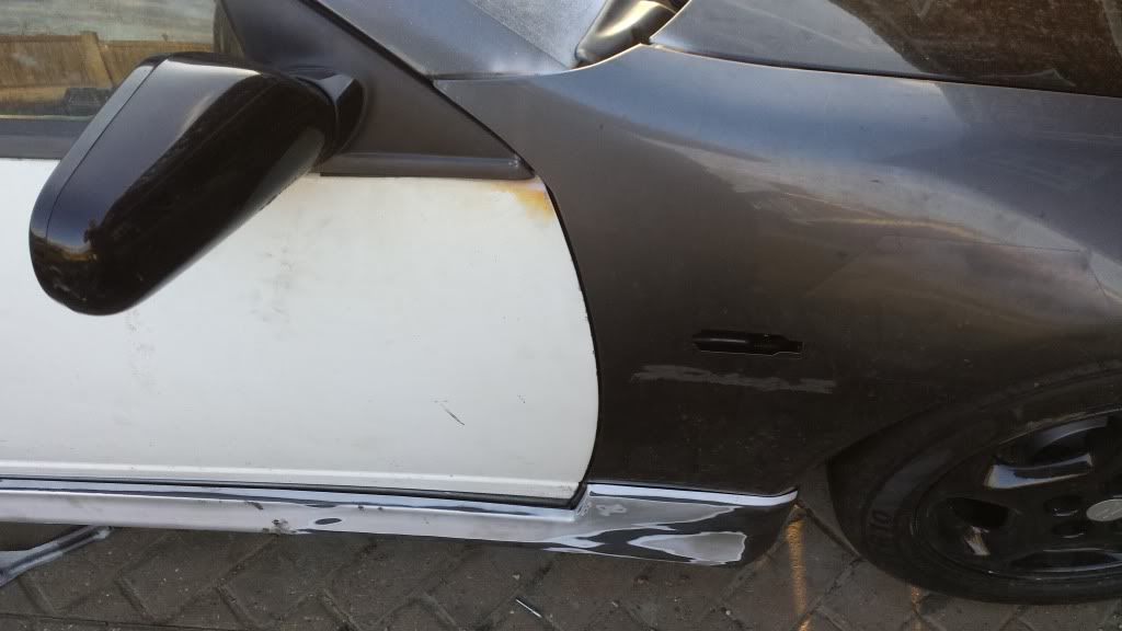

one of the sills were dented, from a jack and I've sorted that.
Heres a couple of pics, I'll put some more up tomorrow.
Hopefully couple weeks it will look like this again..

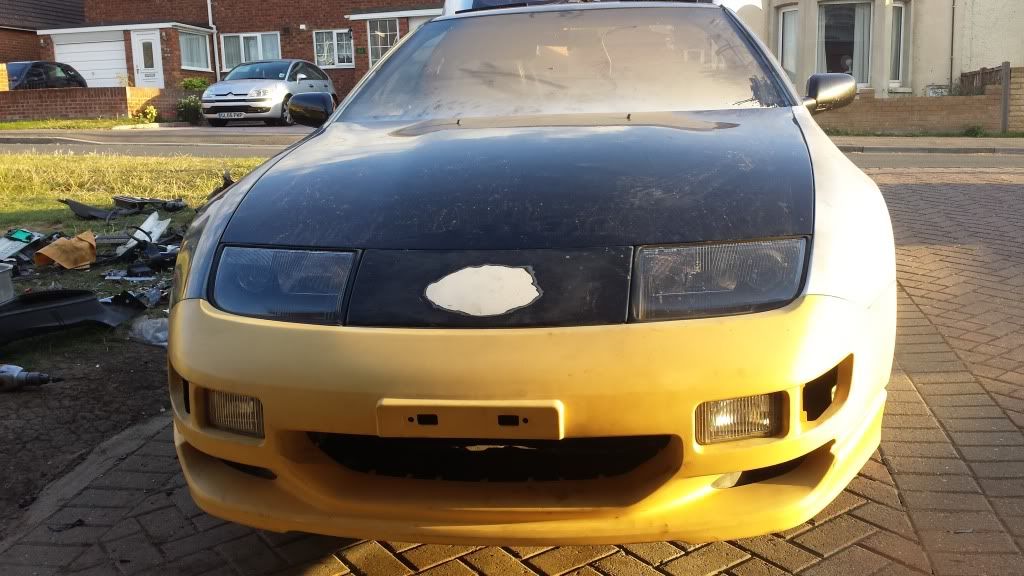

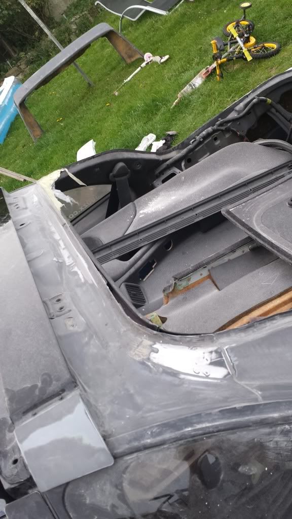

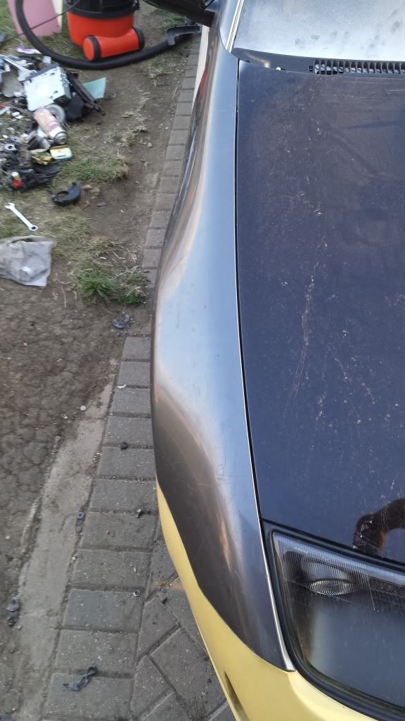

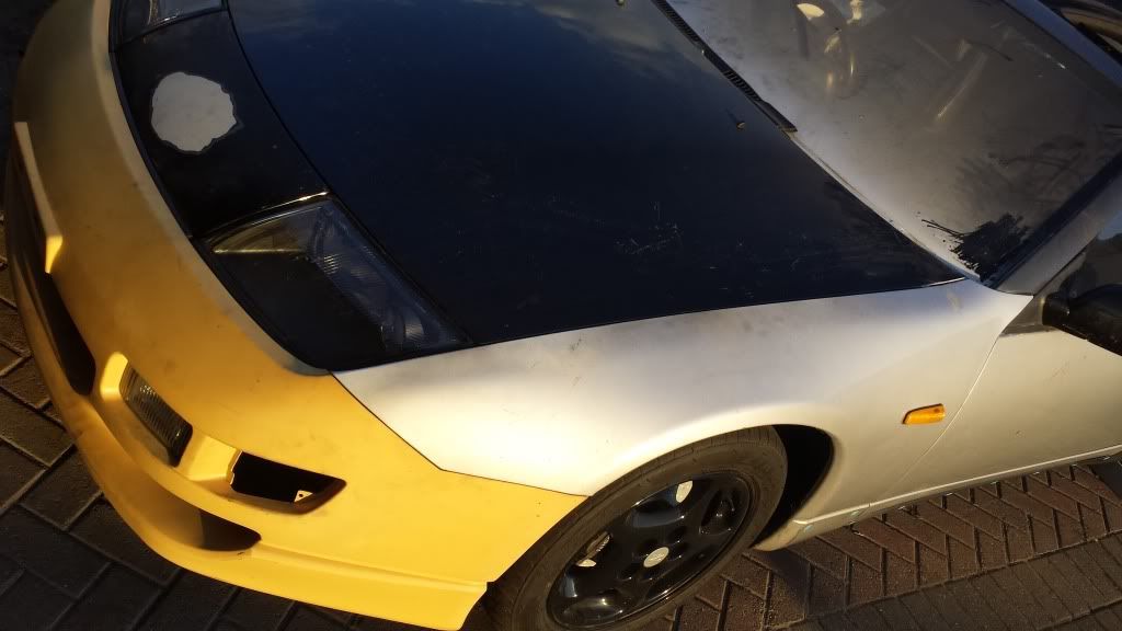

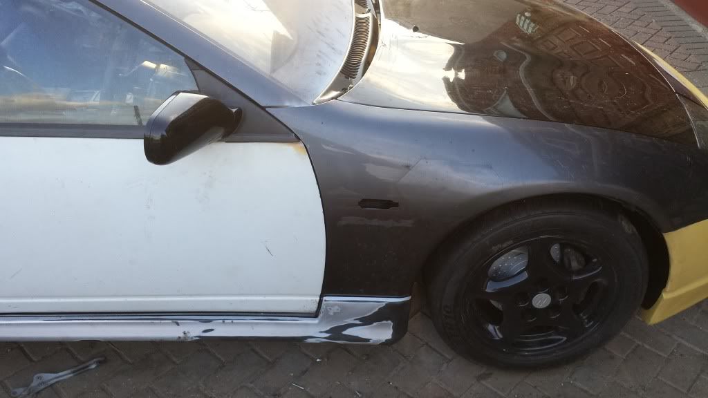

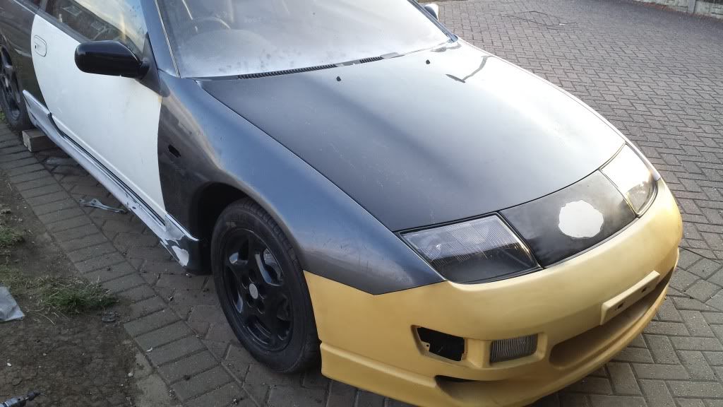

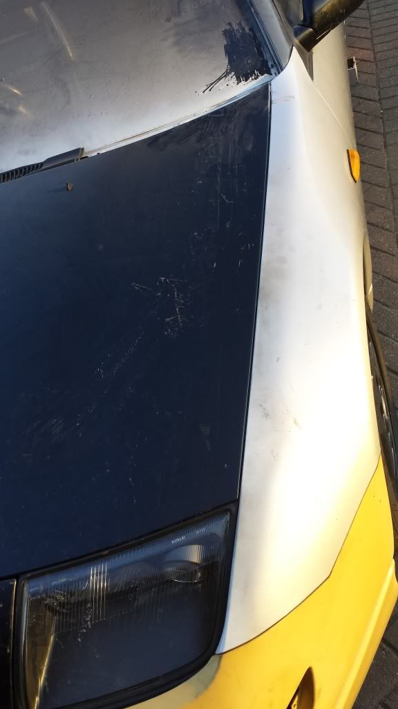

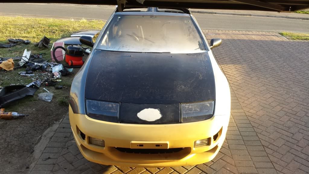

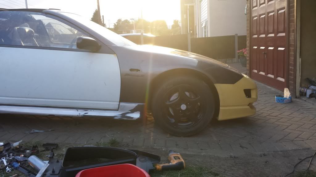

Heres some more pics....
fitted all the panels and bumper etc to make sure they fit right, trying to get all the gaps small and even has possible,
I think its starting to look pretty good....just need it all in white lol....

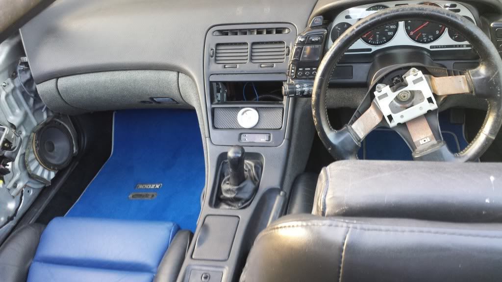

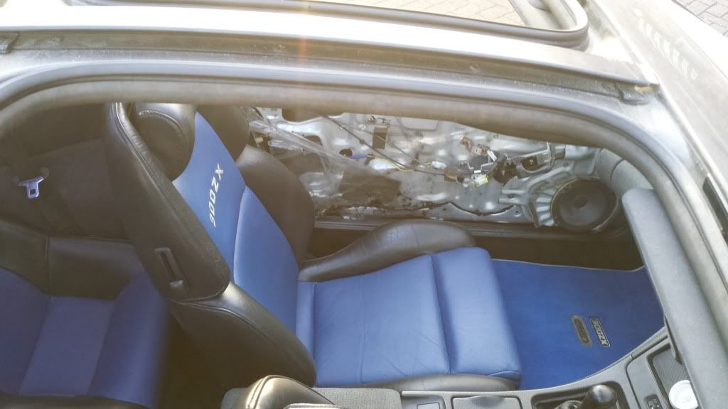

I got some new seats....just need to cover door pads and all the dash trim in blue....get rid of that tweed.

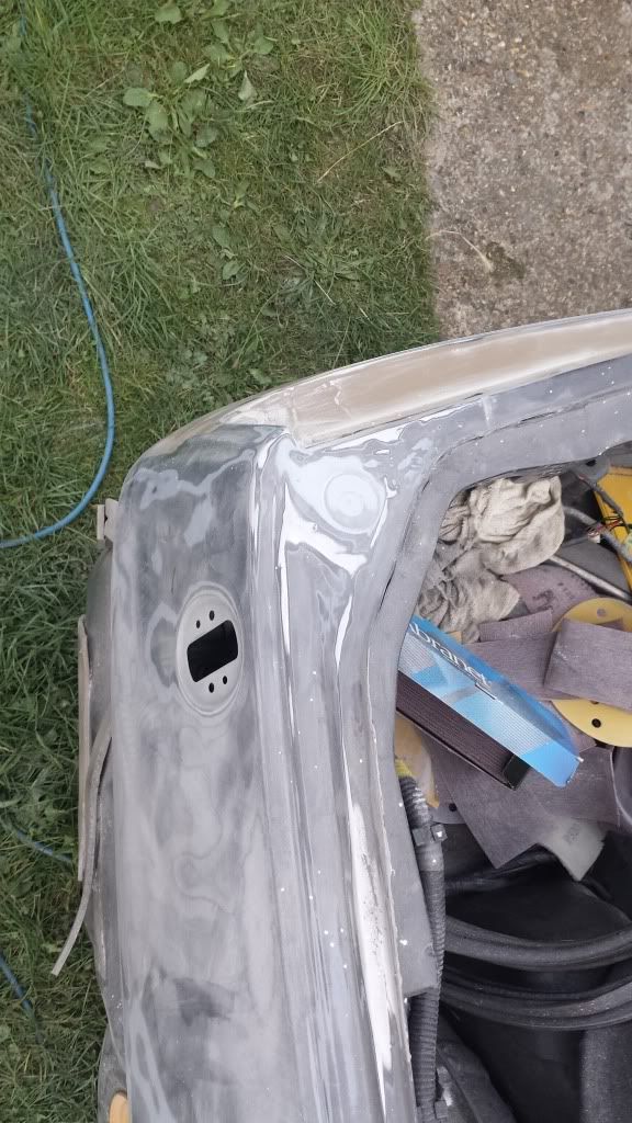

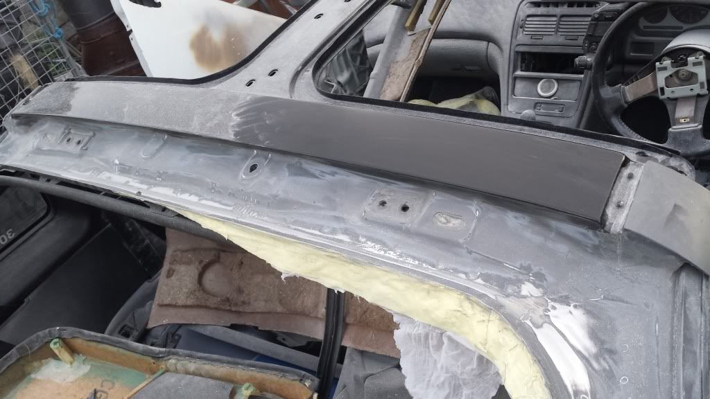

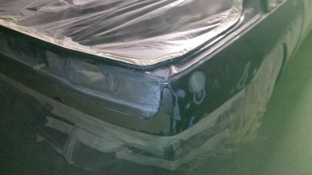

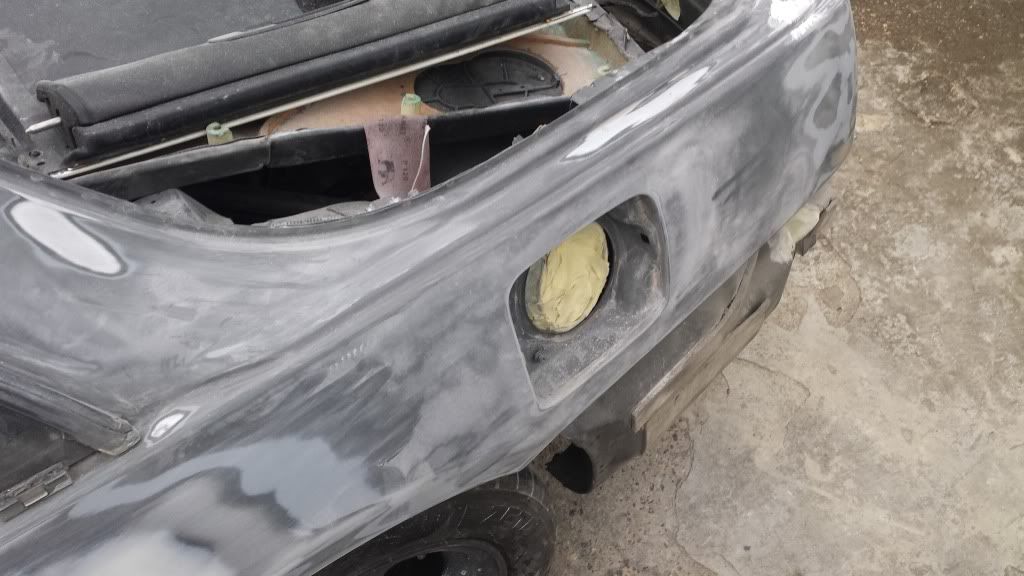

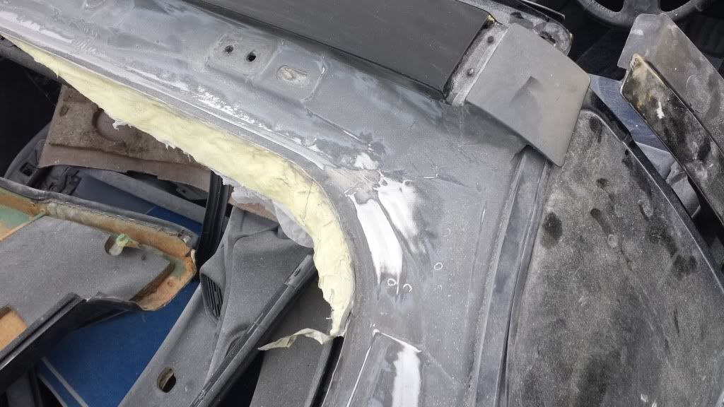

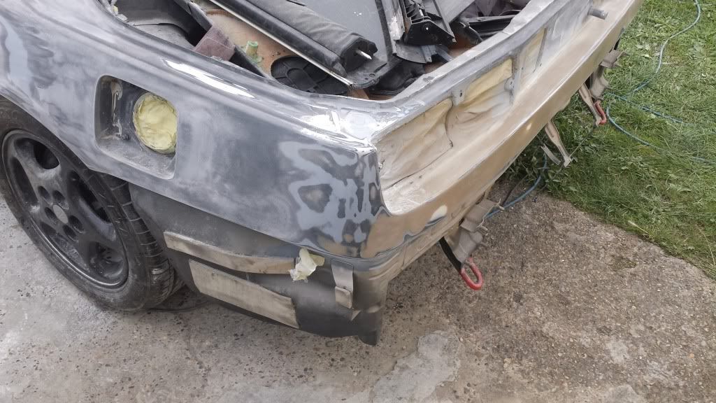

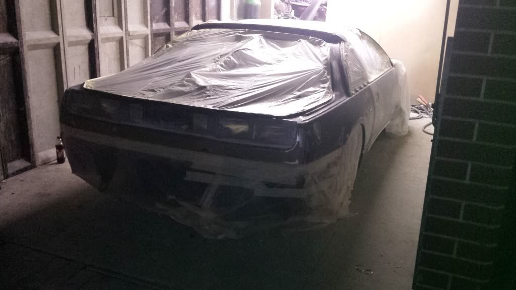

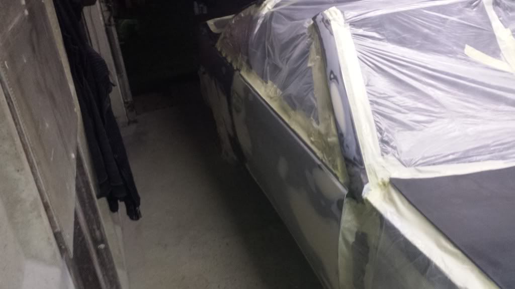

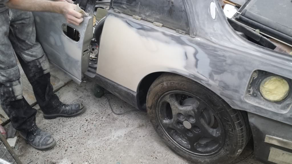

Hi guys loads of pics above of the zed, got it at my father in laws the filler work on the shell and doors and bonnet all done now.
and its actually all in primer.
There was to many fumes to take pics of the primer on the car I'll get some tomorrow.
Took a pic of him painting the bonnet, thats all I could hold my breath for lol.
We used quite a lot of filler in the doors and rear quarters, there not actually big dents we sort of skimmed it to get waves out.
We are gonna block the primer tomorrow, then put another 2 coats of primer on and block that too.
the doors and rear quarters seem quite wavy on zeds his trying to lose it and make it flat.
