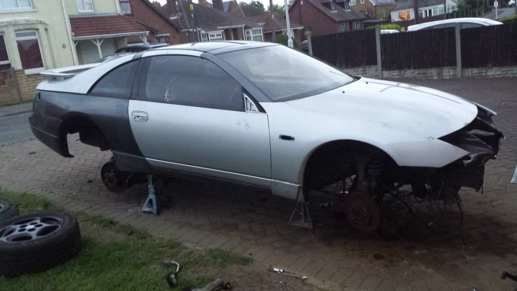

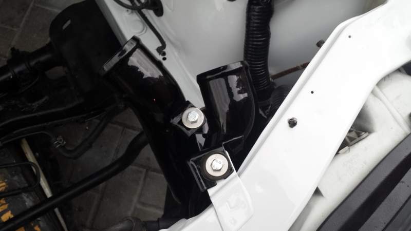

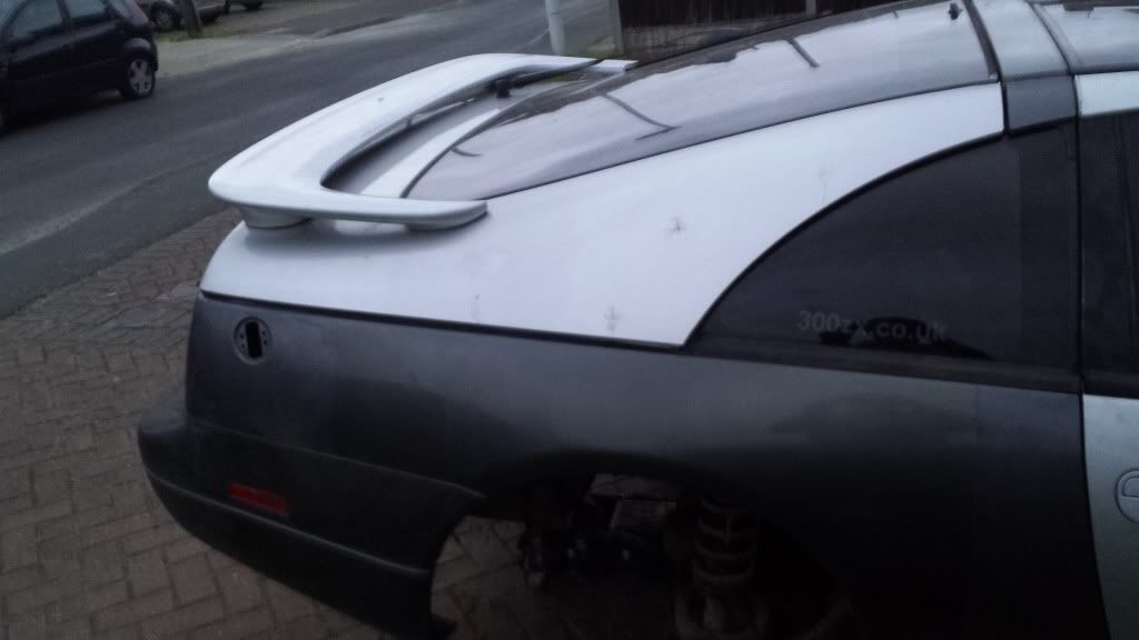

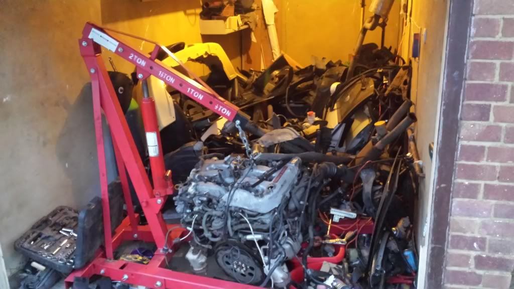

Hi guys,
My new shell came today, from sussex stu.
so got on a mission, took the doors, bonnet, wings, tailgate off.
swapped them with my ones.
stripped the engine bay, got to jet wash it tomorrow.
Removed rear diff, subframe, got to remove front cross member in the morning thrn stonechip arches and underneath the whole car.
one of the sills were dented, from a jack and I've sorted that.
Heres a couple of pics, I'll put some more up tomorrow.
Hopefully couple weeks it will look like this again..

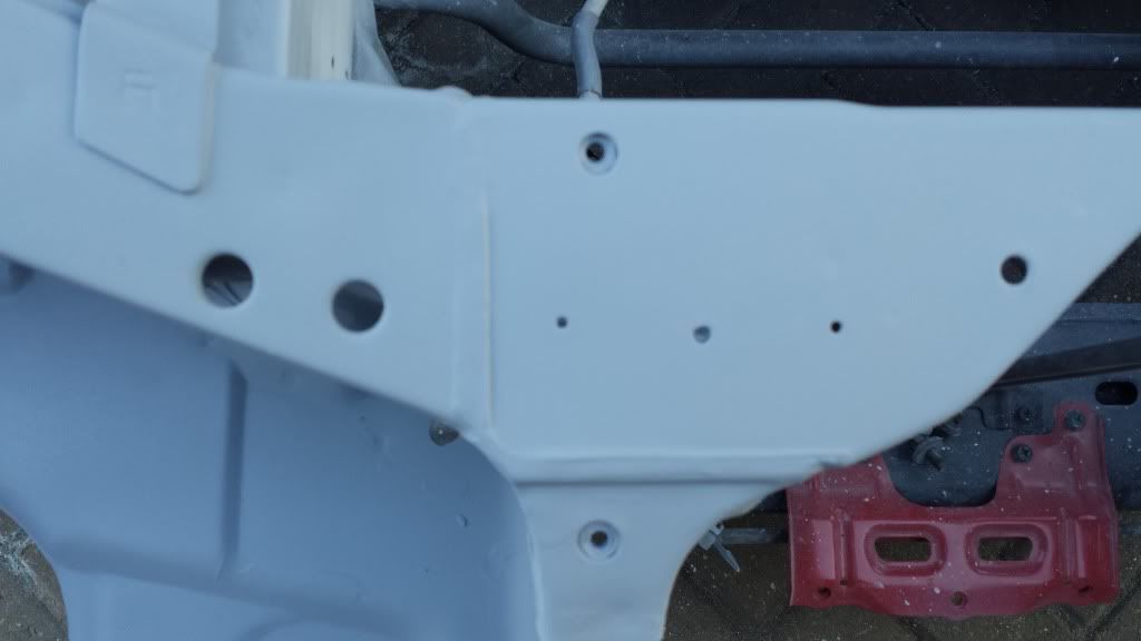

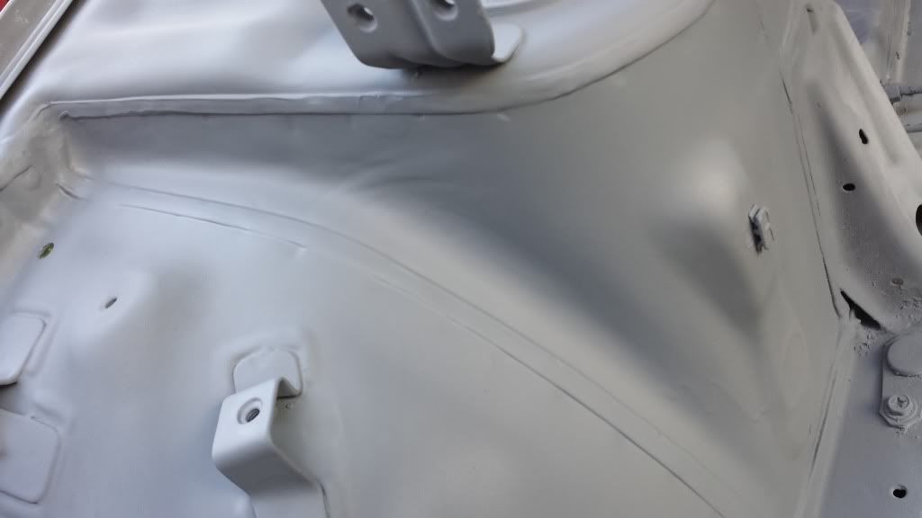

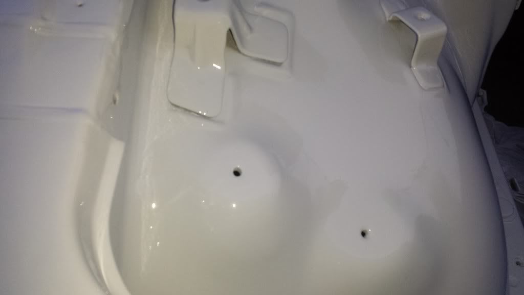

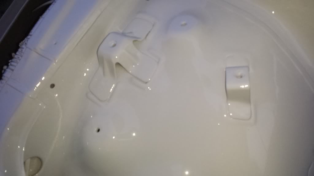

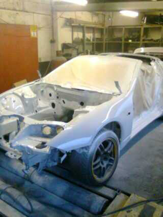

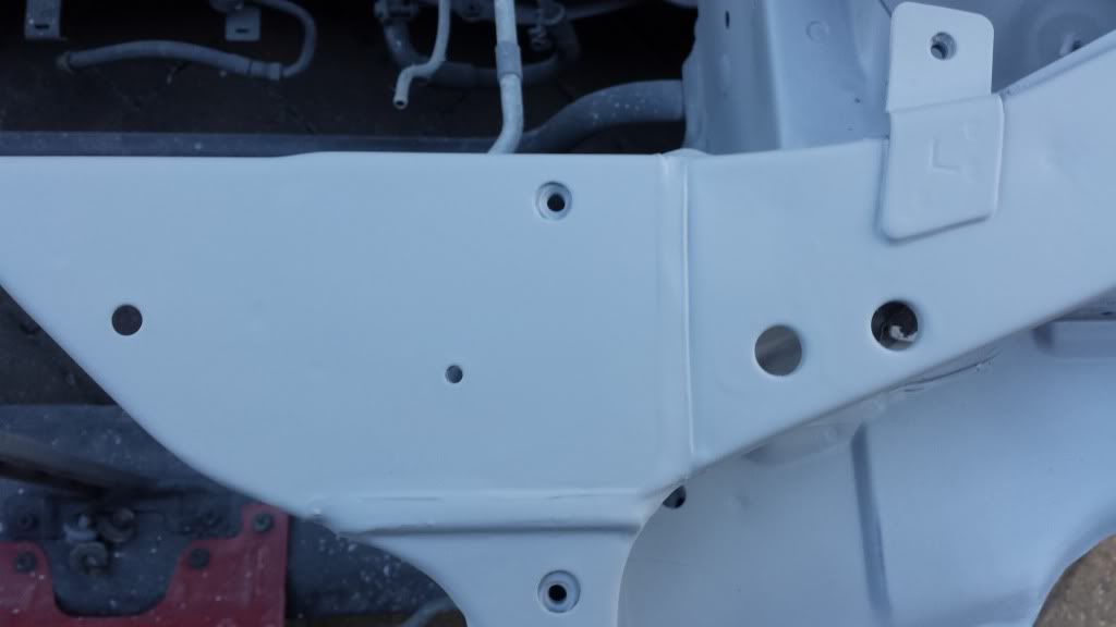

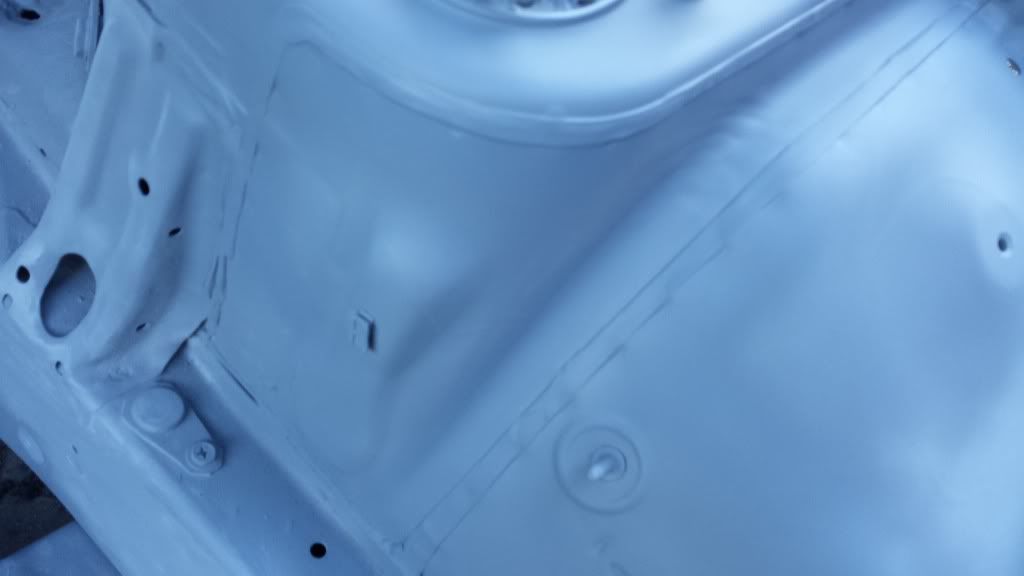

Hi guys,
Had no time really to do anything to my car, but managed to get engine bay back to metal where needed.
was weird cause there was rust where paint had chipped but when dealing with the chipped areas noticed that under some of the paint was rust.
god knows how it got there lol.
but all the rust is gone now.
This is what ive done..hope its right..
stripped to metal,
Etch primered,
Seam sealer,
2k high build primer.
no laughing at my seam sealer its bloody hard to get neat or the runs in the primer Im useless at spraying I allways go to far and it runs.
Atleast its ready for the bodyshop now for its paint.
heres some pics...
Looking really good there mate and yes you have applied the correct spray in the correct order. Great build thread, keep it up matey.

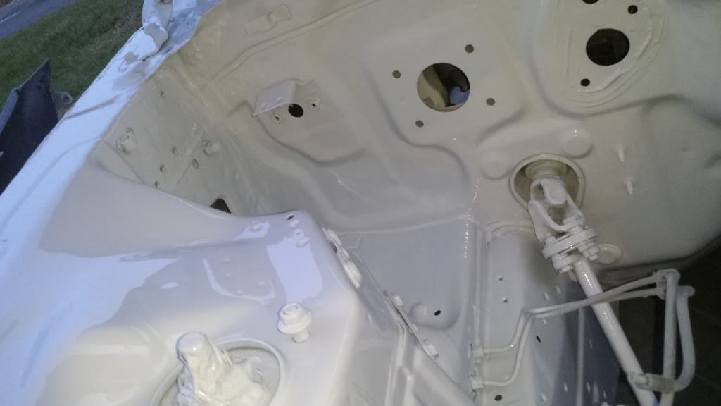

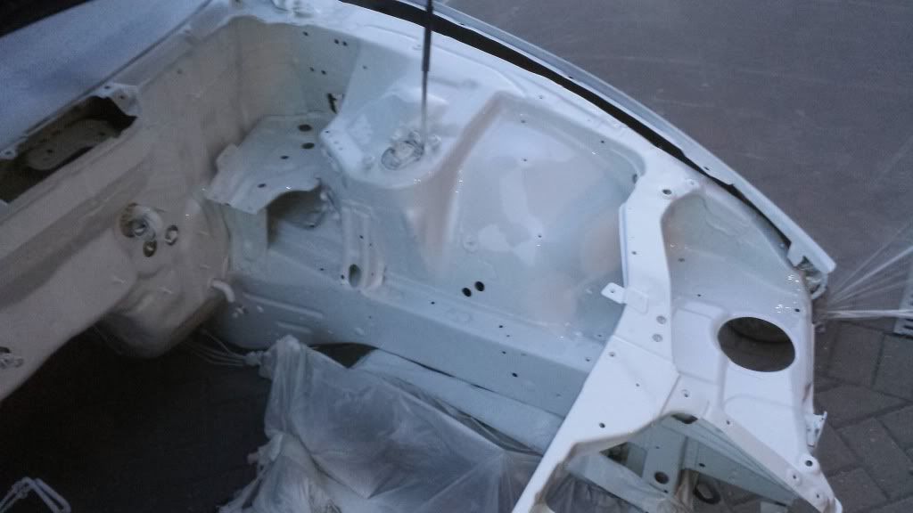

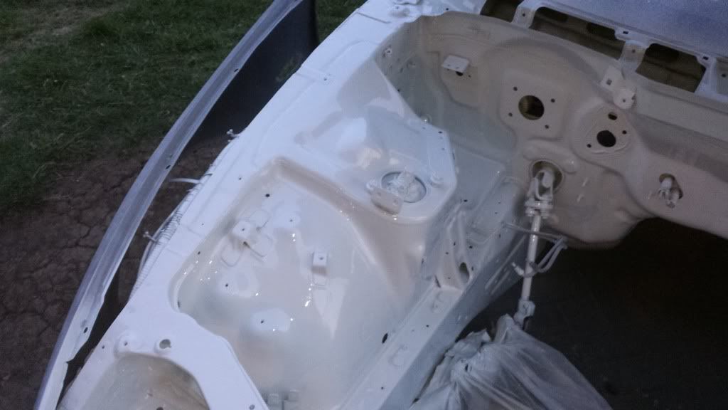

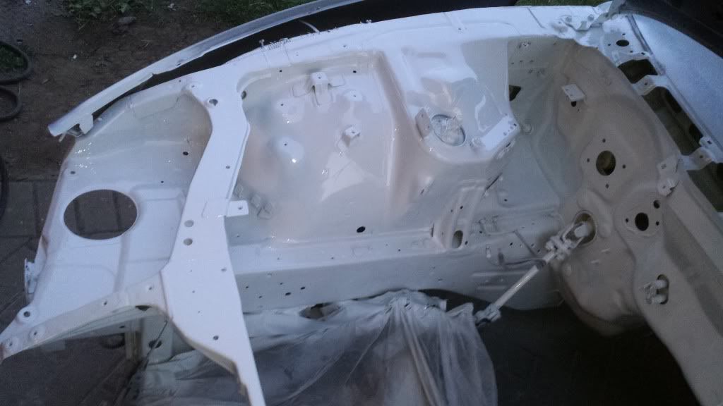

My bro in law came over tonight and painted my engine bay,
Now I can start getting all the bits back in there...
Im glad that bits over, feels like ive been messing with engine bays forever lol.
Painted it on my drive so theres some dust in paint but were hoping it will polish out...but it looks bloody shiney and clean only see dust with a torch lol.
heres some pics.
Im happy with it atleast I can move on...
thanks for reply.
Looking good mate. Out of interest why didn't you mask the steering column?
I got another one so putting that on...
was just being lazy lol.
also got spray on front window but dont care its having a new one too..
