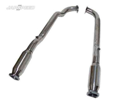

these are japspeed 300zx decat pipes

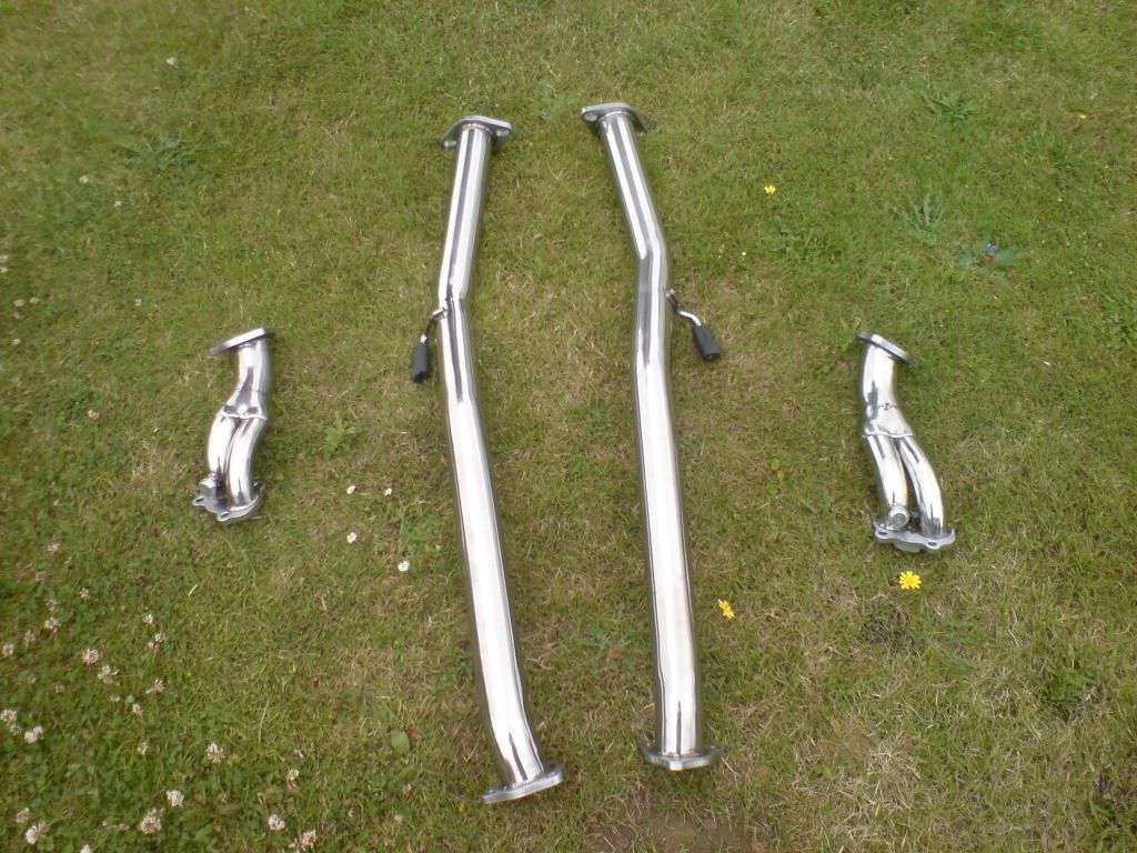

these are standard turbo elbows
the end of the elbow with an 02 sensor sticking out of it joins the turbo
the studded end joins the decat triangular flange.
the greddy turbos you have, must have an equivalent of this rusty looking elbow. thats what your downpipes will connect to.
the other japspeed divorced downpipes, come straight off the turbo and look like this:
these do come straight off the turbo, as they include new elbows. These will not fit your greddy turbos, so you need to find out what elbows are on your greddy turbos, so that you can have some downpipes/decat pipes made to fit. I think it would be quite easy for someone to fabricate if you cant find a ready built one, and wouldnt cost as much as you think.

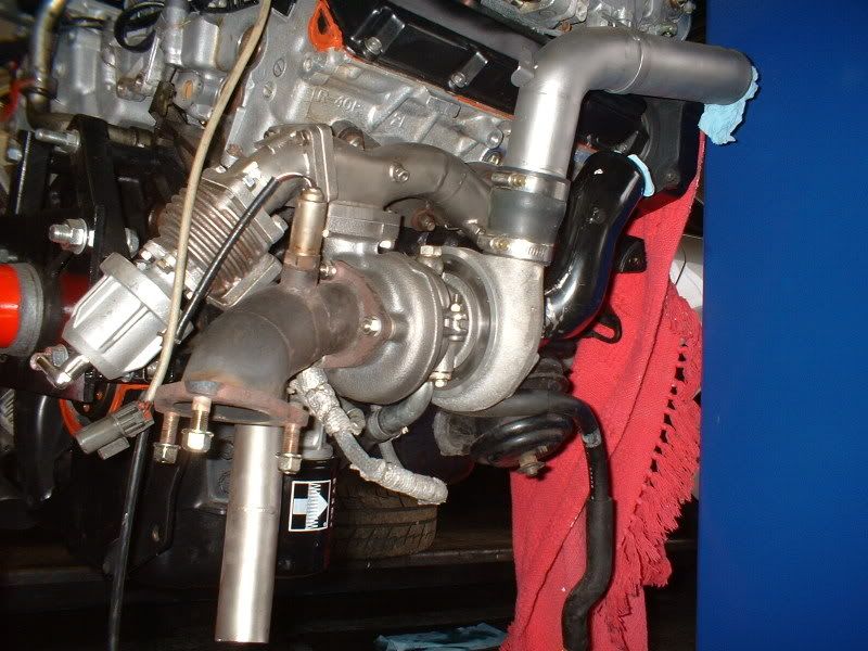

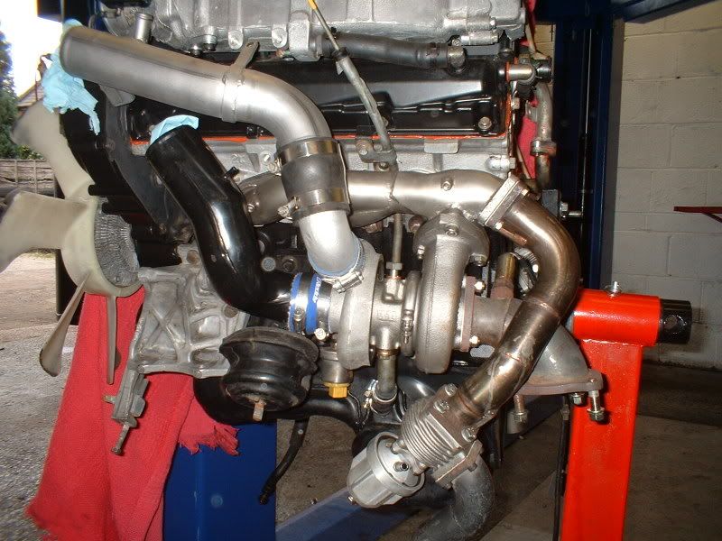

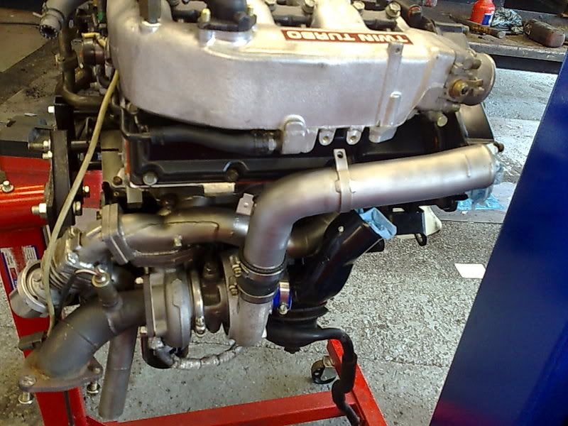

So here are some of the engine with them on

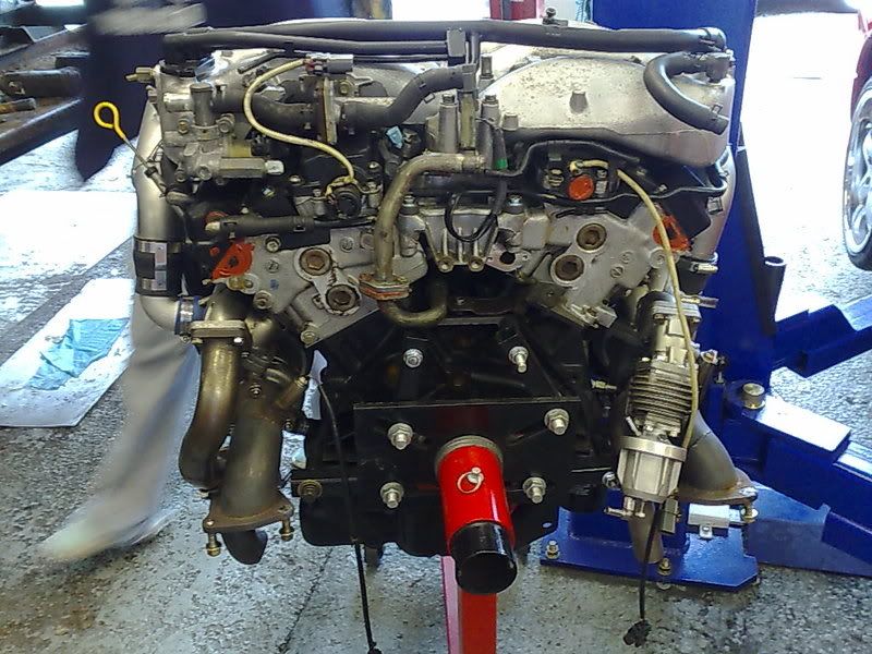

dont forget that those turbos will need a wastgate adding to the Exhaust Manifold
hey mark, i think there is already a gated screamer pipe in the setup above no? correct me if i'm wrong, but i think i see it poking out behind the elbow, with a large wastegate actuator thingy in front of it
my only concern there being, i only see one on the drivers side. shouldnt there be twin actuators, and 2 screamer pipes. one for each side.
ignore my last post, there are wastegate actuators on both sides, just the screamer pipe setup on the passenger side is a touch more intricate!
yeah in the pics of post 8 there is but for some reason i thought they wasn't your pics ...
and u only had standard down pipes and decats
So post 8 is actually my engine but I now have pent roof. Style manifolds. I really want to go bak to the log type but would ned some making
Your going to have so much fun swinging that into your engine bay trying not to **** the screamer on the chassis rail lol, going to sound and go well though I recon.
there old pics mate...birds had that set-up for a while now
