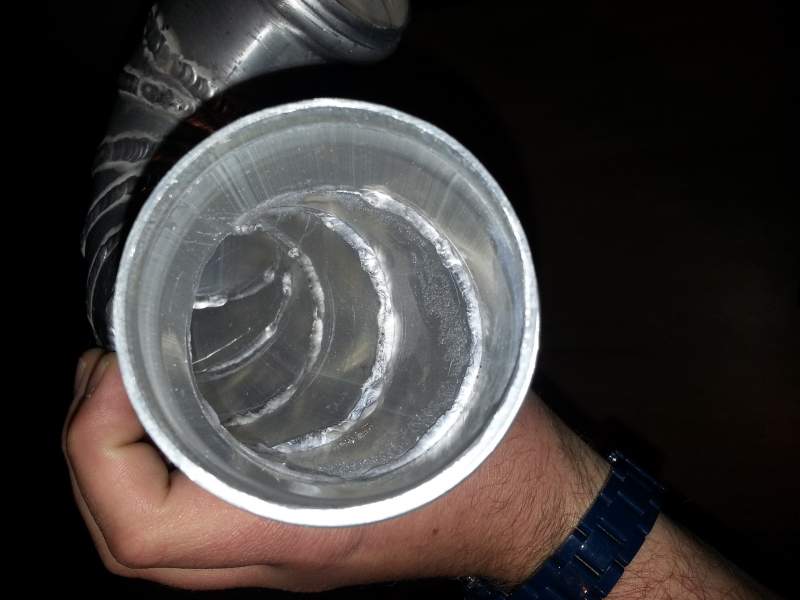

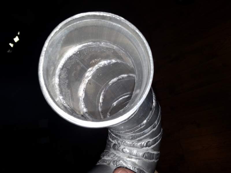

Hi all,
Im having trouble de burring the intercooler pipes I had made. Starting to be a right pain in the arse.
Has any got any ideas what can be done or where to take them to be worked on.
Thanks Dan
Hi all,
Thanks Dan
Got any pics Dan?
Edit...ahh you should of de-burd as you came out with each segment. Use a flexible buring tool
Got any pics Dan?
Bob on, however really I wonder how much of an issue this will even be.
Cheers guys I got 1 of those flexi tools but the grinding stones I have are not man enough. Just ordered some die grinders hopefully this will work.
I had them made a while ago just need to get the ball rolling again and get the car finished. Not touched the car since building a work shop and garage for the car at home. The unit I had was creating problems
Edited by GIBSTER-TT
yea stones will not cut it,must be die grinders but keep the rpm,s down with those flexi drives as they get hot.Are you going to use a drill or die grinder mate?
Cheers for the info. I'll be using a electric die grinder mate.
ahh ok mate...iff you did,nt have one i was going to offer mine for a lend.
