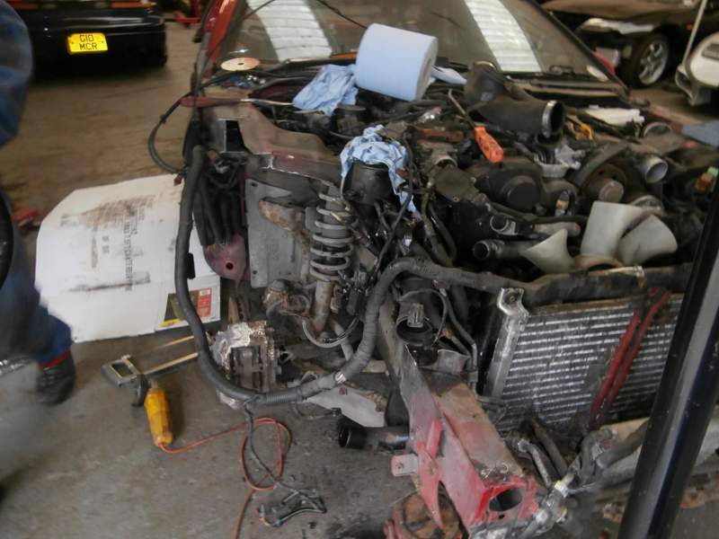

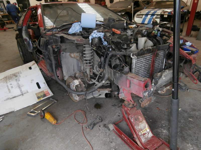

So after much deliberation should it be repaired or should it not be repaired with 14 years of ownership the decision was made and work has begun, though it might be interesting to share the progress.
That is a whole lot of unpicking welds and cutting, the main fram is good but the front corner is a mess, have some more pics to upload later, ENJOY

Looks nasty - but as you say Jeff, it could have been a lot worse!!
It's great to see another ZX living on though... I am pleased it's being saved!
Richard:thumbup1:
Yay!! Nice to see someone take the (not necessarily financially wise) decision to save a car they love! :thumbup:
The cost is certainly not been a factor in to repair or not to, or the it would firmly be a NO!

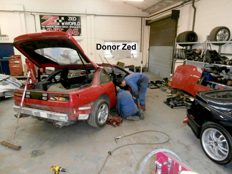

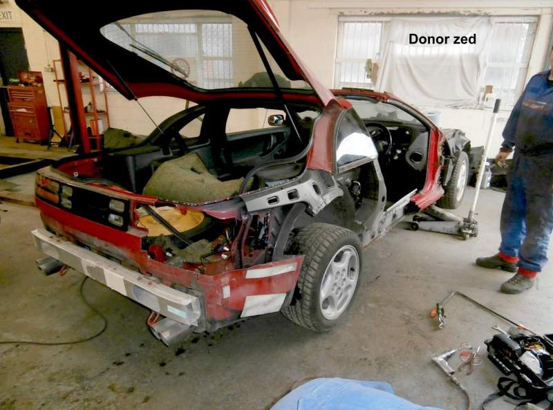

So the repair parts list is huge however with a donor zed at hand we have started the process.....
so a little taster until I can upload some more later.
So the donor zed.
donor 1.jpg..

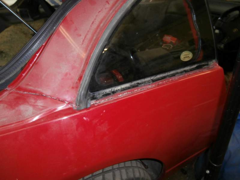

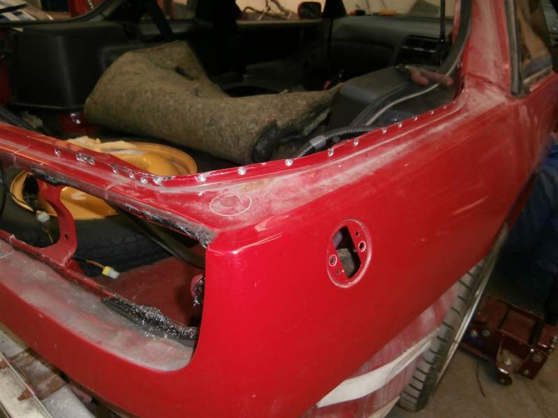

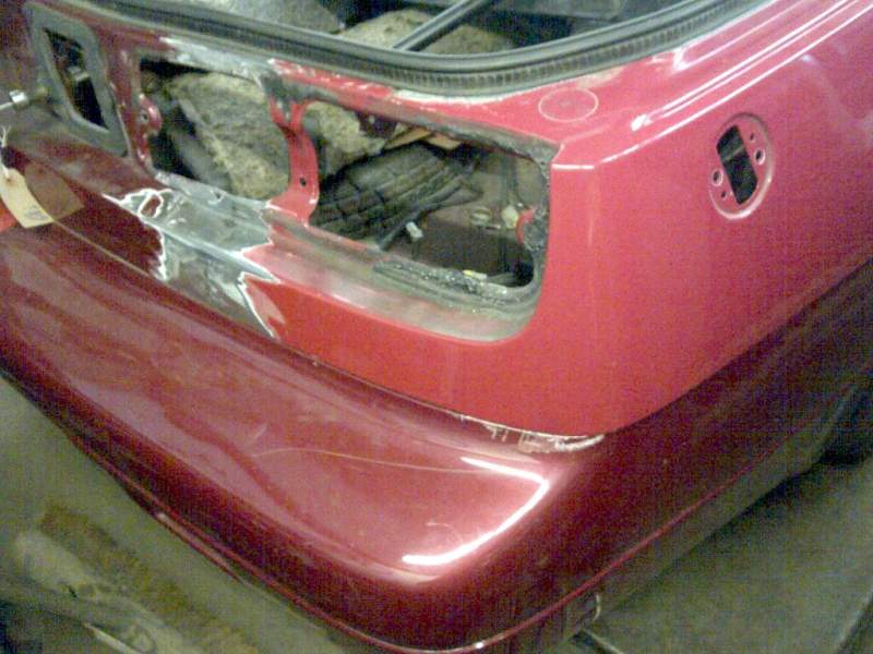

Just like magic!!!!!!!!!! certainly not, took a full day to unpick and comletely remove in one peice.

Great work so far Jeff, I was hoping it was going to be saved
This thread makes me happy. I'd hate to see a day when there ae no Z32s left. Good on you guys! Keep up the epic work.

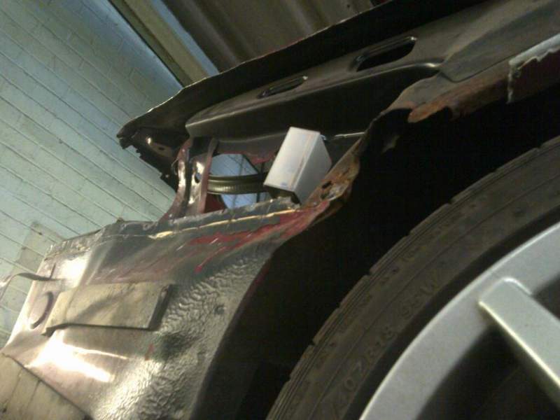

Very interesting seeing how the 300 is constructed under its outer skin.
my thoughts exactly
No chassis damage then or has it been on a jig already?

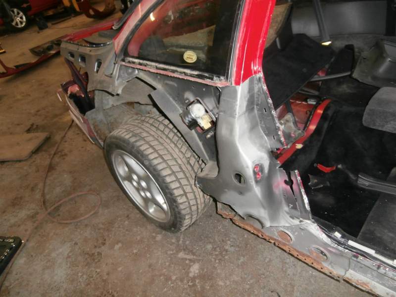

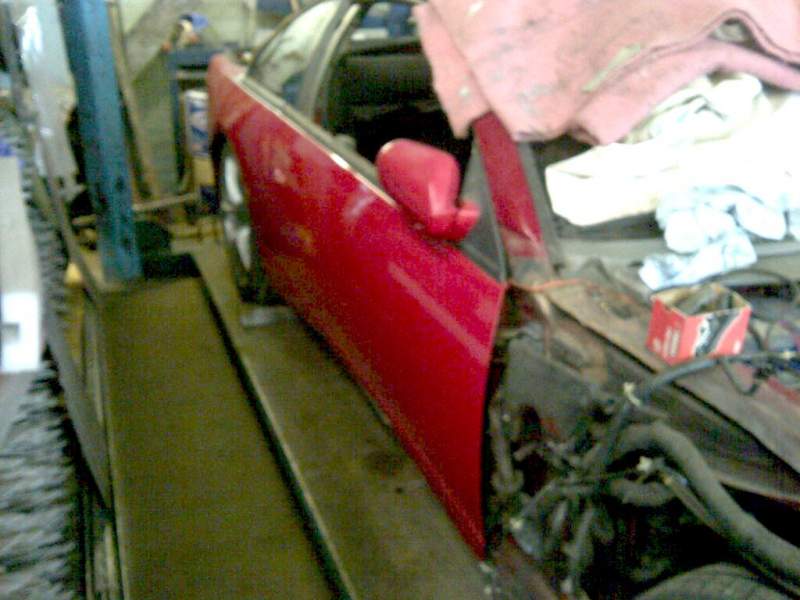

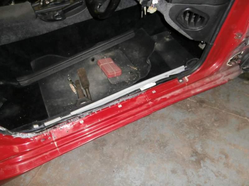

Small update, rear quarter, sill and door in place.
Jeff TT
im totally gob smacked!!! make me proud to be part of a community that goes to so much effort on what lots of people would say is "just a car"! stunning work Jeff!!!
Its taking shape :thumbup1:
Seconded - I could not have said anything more myself!!
Richard:bow:
