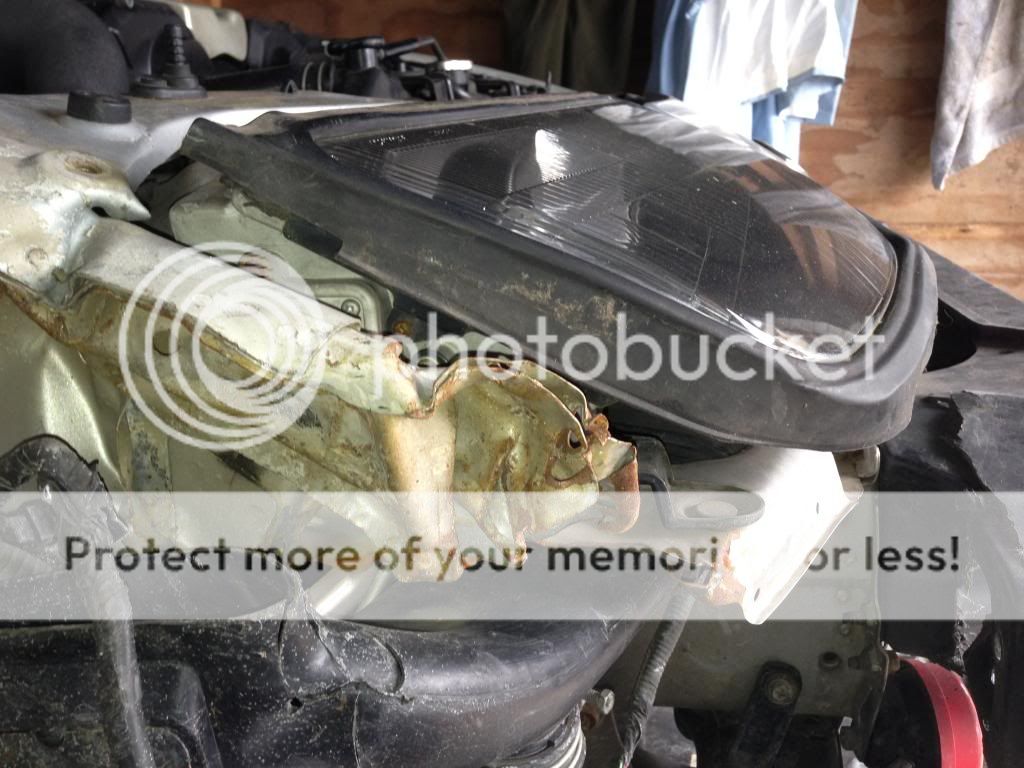

Well i started to strip her down and upon removing the R/h Wing i found this abomination!

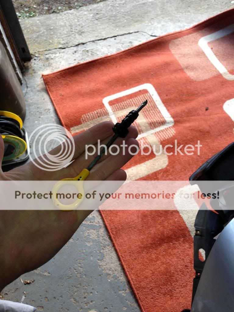

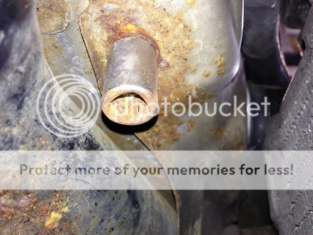

Then obviously having to remove the engine and planning on stripping the underside i start removing the engine beginning with the Fluids and find a certain something peeping out the sump! (the dipstick i knew about when buying the car and the look on the owners face when i asked him where the rest of it was was priceless)

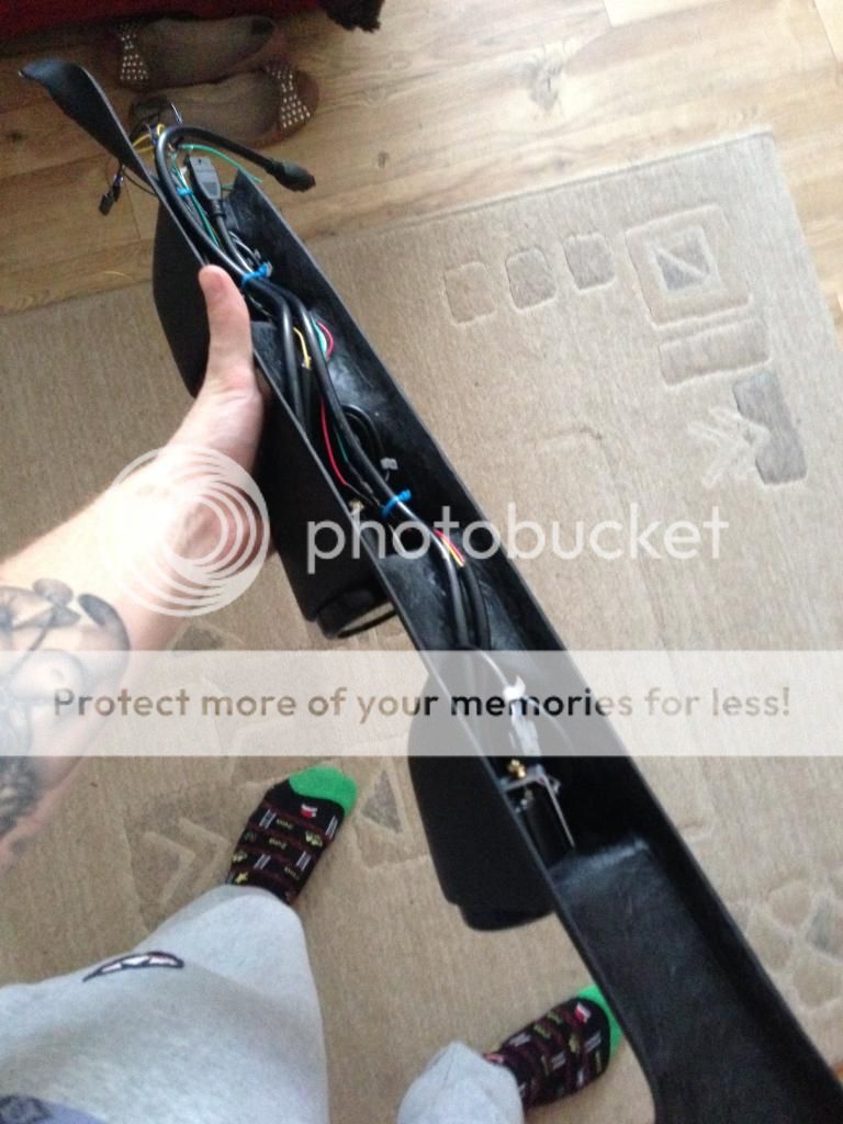

This next one isnt detrimental but i thought, at least I've gained something so far from buying this.....

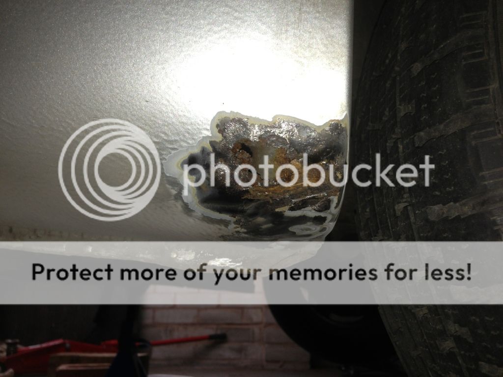

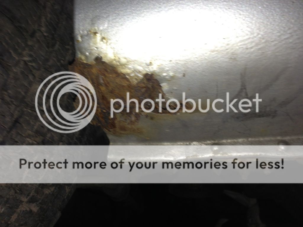

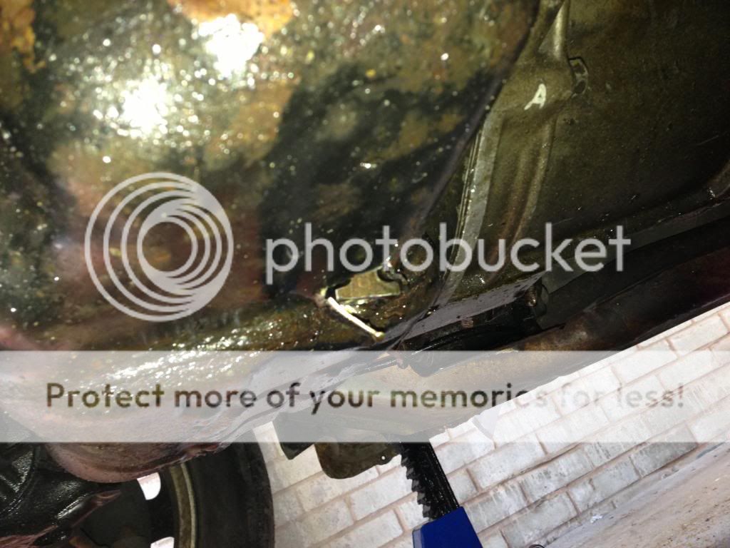

Now for my favorite surprise ive had yet...
L/H Sill
R/H Sill

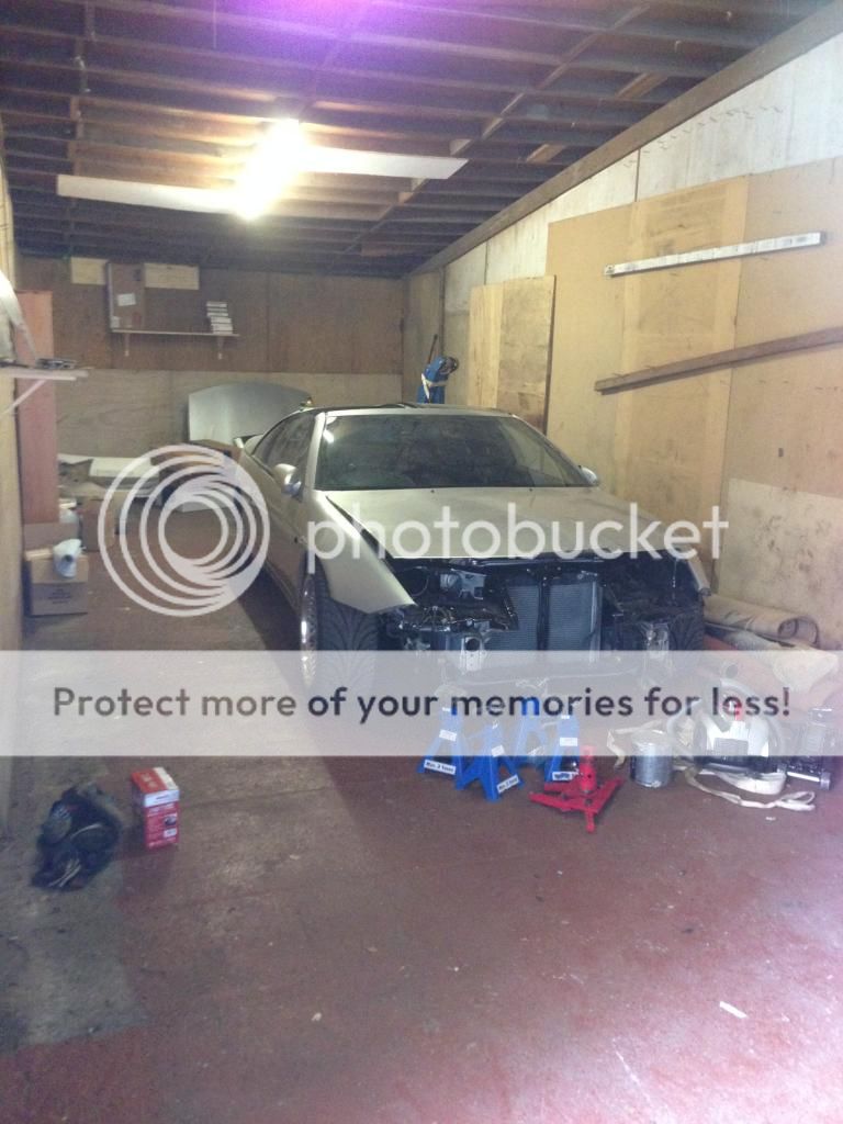

Yeah had a leak in it the other day but person I'm renting it from is all over it.
Things I've done since last post are
Ecu wiring loom
Solid gearbox mount
Custom one piece prop.
Other casual stuff...
Yessss :thumbup:
Good to see you got the car up here ok. Is it martys old unit on the right? Or the left hand one?
yeah its martys old place, he is just over from me now so we can send love letters to each other. you should come down soon, and we can all hold hands.
Yeah its still the z32 box but its been pushed back around 20mm so ive had to chop up my g/box mount and weld it myself. also had to shorten the prop. nothing too crazy
no idea why but the gear lever now sits an inch over to the left...

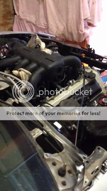

i fitted the gearbox with the one piece prop jeff made (slightly shorter) and ran into a problem with my flywheel touching the bell housing so i couldnt turn it over. with the gearbox being slightly higher it made putting it on a right nightmare. i had a 'pre-ground' bellhousing but to be extra safe i shaved them down a little more and to find out it still touched was irritating. however i managed to sort this with the gearbox in situ as removing the gearbox would have damaged either flywheel or my stupidly expensive soft ally adapter plate.
That is sorted now and i have put 4.7 liters of some fine oily stuff with more to go in which is good as i thought i had reduced the oil capacity too much, and even better...no leaks!
shimming the starter motor was not fun at all as i found the lower bolt hole was all cross threaded and messed up which was irritating, but with a longer bolt it holds so thats good.
i have a little vid of a dry crank just to hear it as its been a long slog up until now. This also means my tiny battery is powerful enough.
My s2000 clutch master is doing well and is super small so no contact with anything other than the bulkhead. i do however have to space it away from the bulkhead a couple of mil as the pedal doesnt come back far enough to allow oil into back into the cylinder if i was to lose any. (adjustment thread is already at max)
i haven't yet found a replacement for my fan as ive confirmed that it is way to big for the gap i have at the front of the engine.

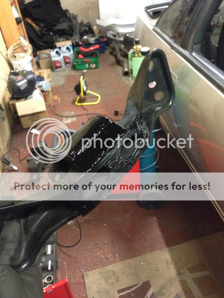

This is my solid G/box mount. kinda had to make it while it was in position which was annoying, but it really is solid..

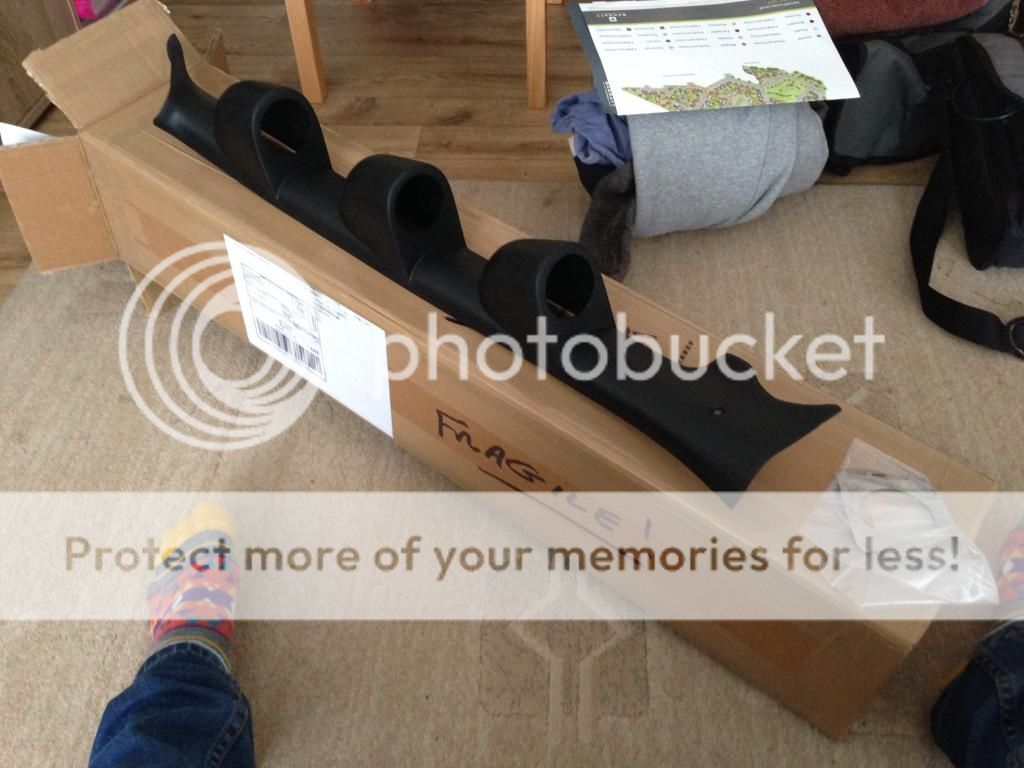

My 3 gauge pod pillar, as im sure many of you have seen before

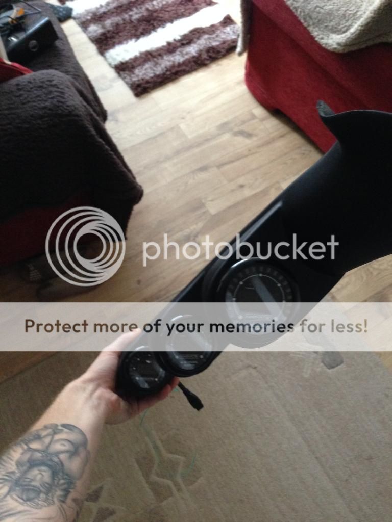

My gauges fitted

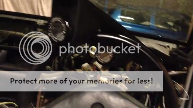

And the wire set up behind, allowing it all plug and play. fairly normal but i liked it.
I do have another gauge which is my water gauge which is going in my door vent.
