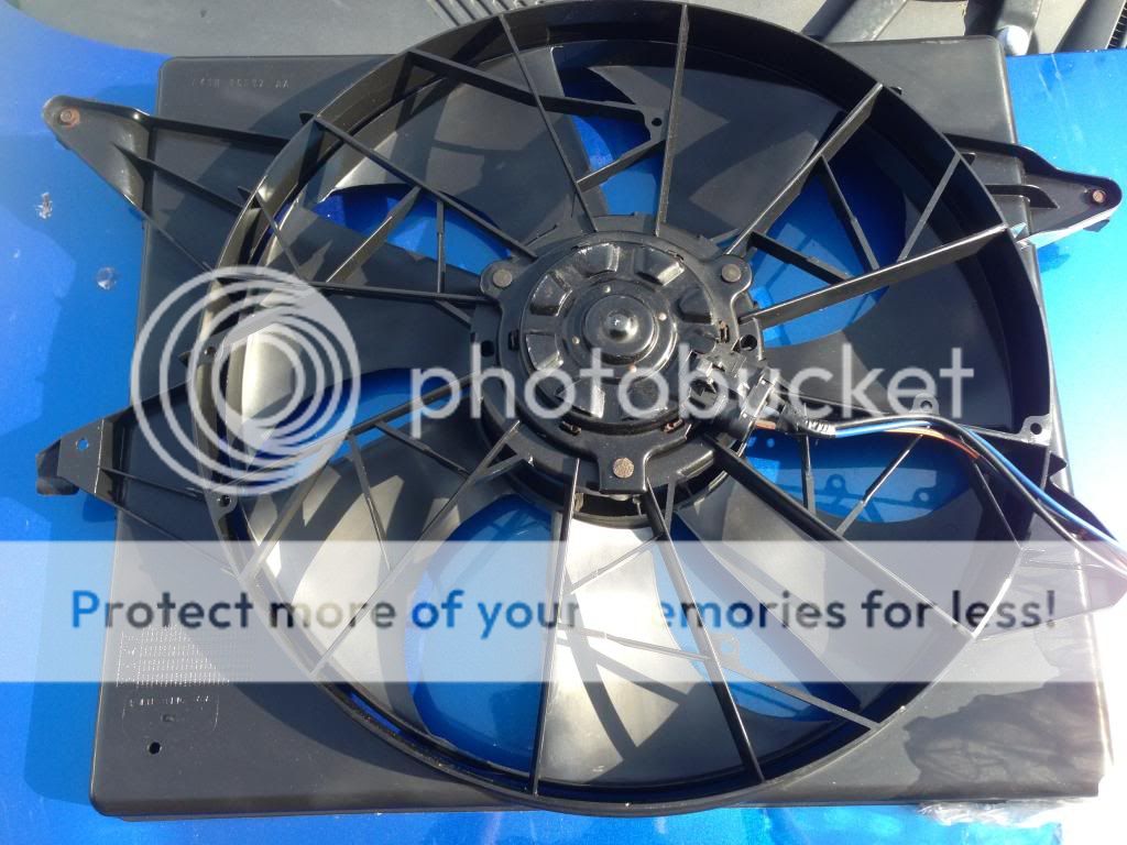

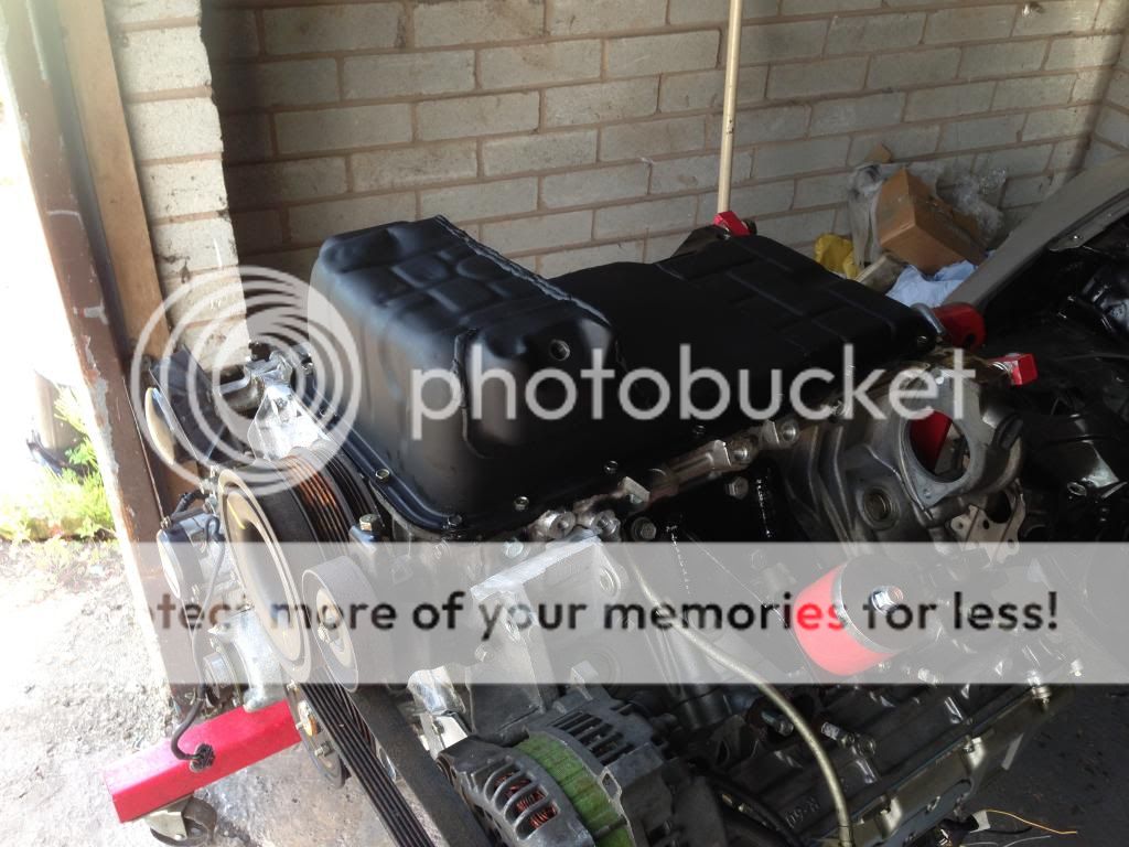

Here is my replacement fan which of course electric. It comes from a lincoln Mk8 there are a number of reasons for choosing this over the stock viscous fan but one of the being there wasnt enough room for the viscous fan.
And some other random shots
Yeah it stank man, although it was shipped from Canada with oil still in it. What I drained looks nice but that was horrid.
Someone did a lab experiment comparing e-fans and this one produced around 3400 on hi speed.
On the same experiment he tested a spal 16" which was rated at 3200cfm but actually produced 1800 :thumbdown:
Should be more than capable

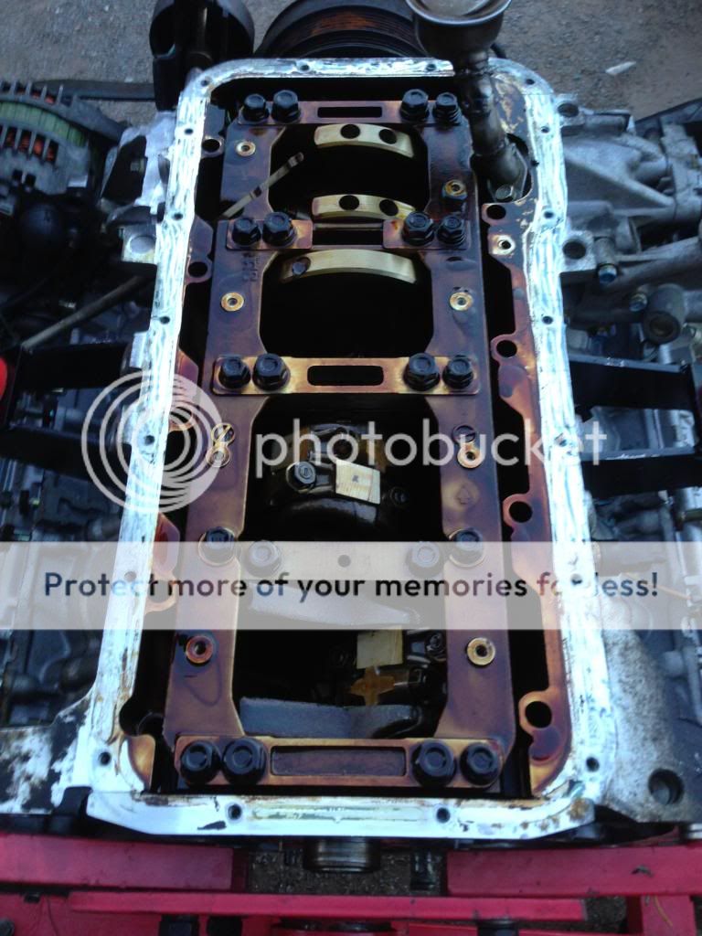

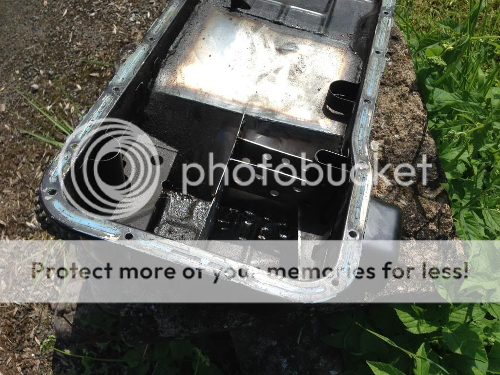

Some more sump photos

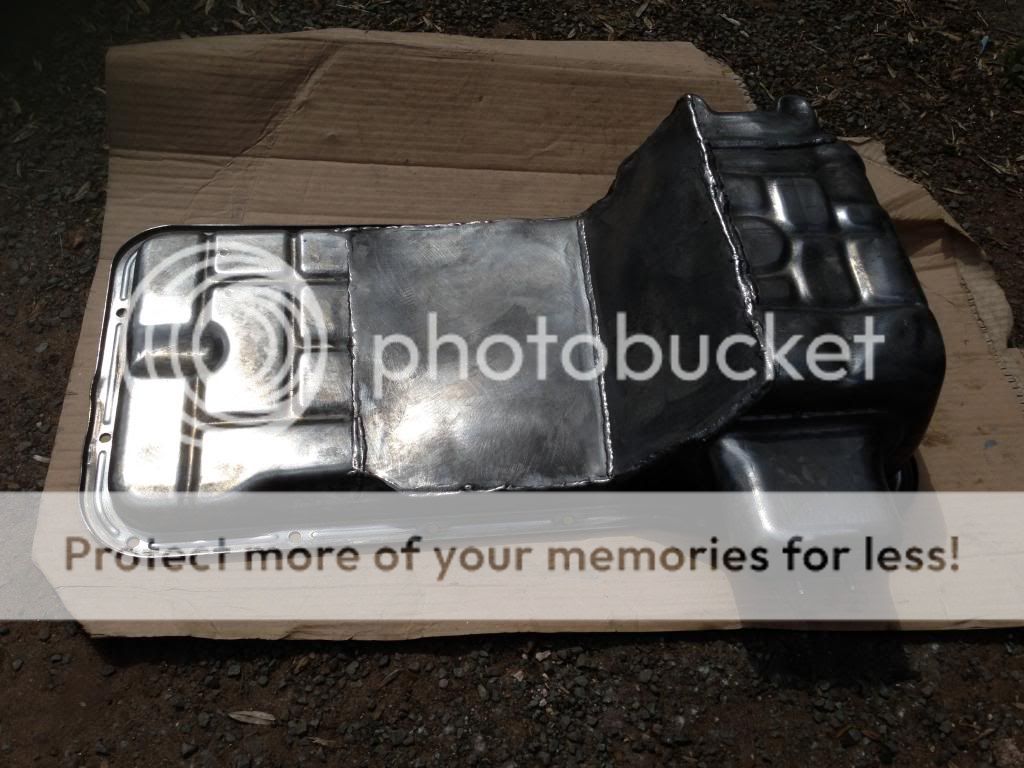

Before it went to the blasters

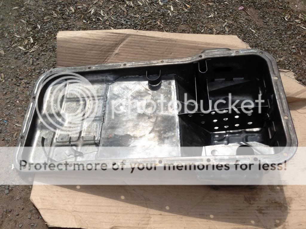

In the second picture you can see the baffles i have made to stop the lower capacity of oil being a burden on the engine, even though i plan to increase it anyway.
The baffles are orientated like so due to the pickup being towards the left of the sump.

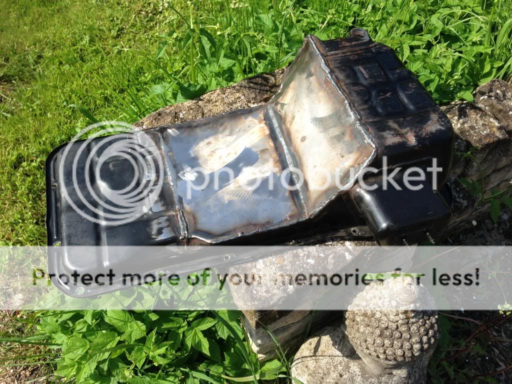

After the blasters
And fitted!
The fitment of the sump and the welding of the pickup have been a right pain in the ass but all done now and on with the installation!

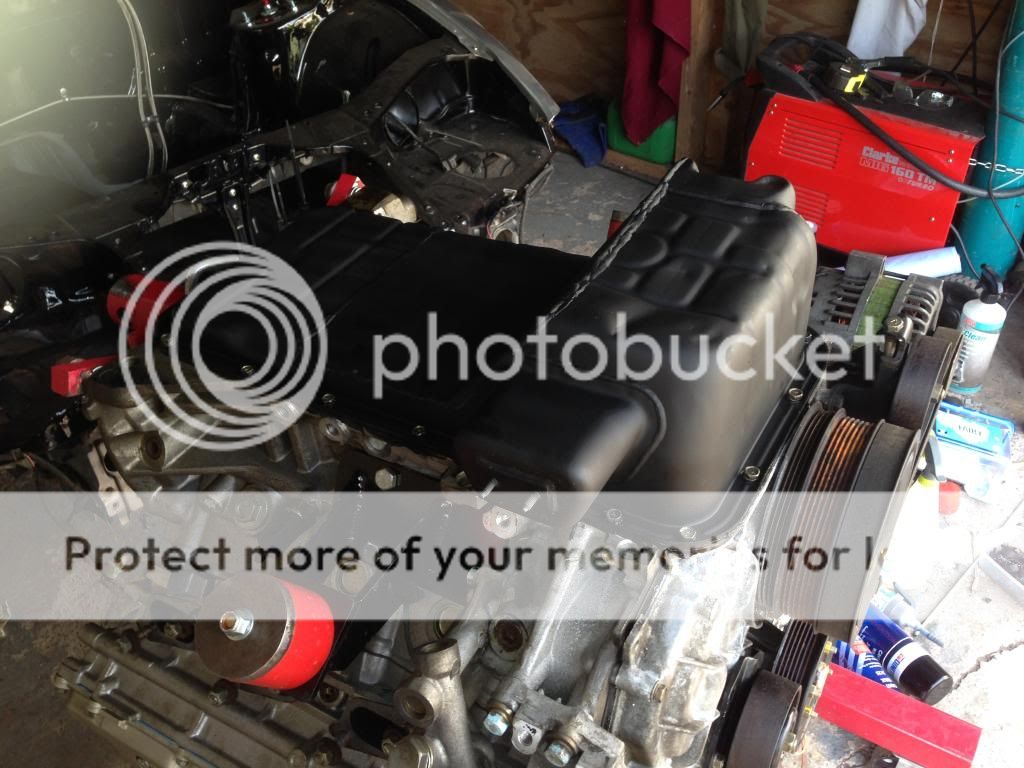

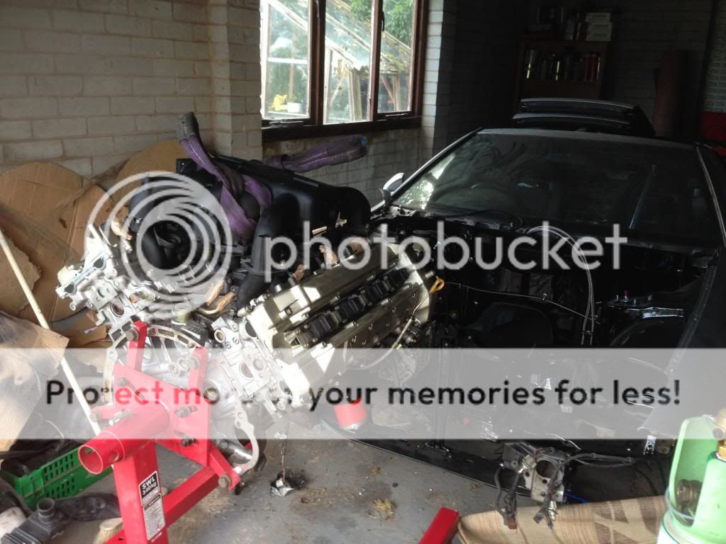

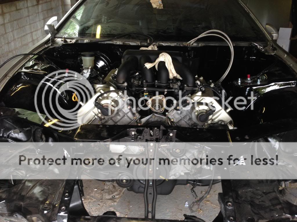

Well erm, ITS IN!!!
God damn finally and not without any cut knuckles or tears, and yes it slightly wonky at this point as a spot weld on the exhaust is propping it up one side it is literally that close!

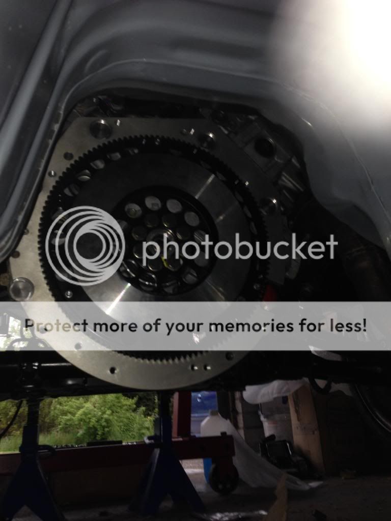

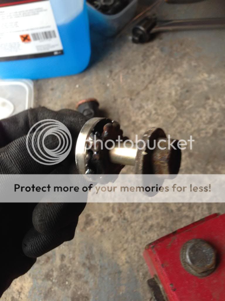

How I removed the auto pilot bearing. Yep that's a camber bolt.
All I managed to do after that was adaptor plate and flywheel as my clutch never came with any bolts
Problems I currently face which I have noticed-
Manifold fouls steering shaft
I have like 2.5" for a clutch master cylinder to fit in
Fuel lines run too close to manifold
My new fan won't fit without chopping it up :(
Won't be believing anyone else's measurements for this conversion again!!

It went in okay ish considering I was on my own. But all it's ancillaries need modifications. I've even had to modify the aftermarket conversion bits...
Great work mate, I know how crap it is hauling engines in and out to make adjustments to make things fit so I can wholeheartedly sympathise :)
