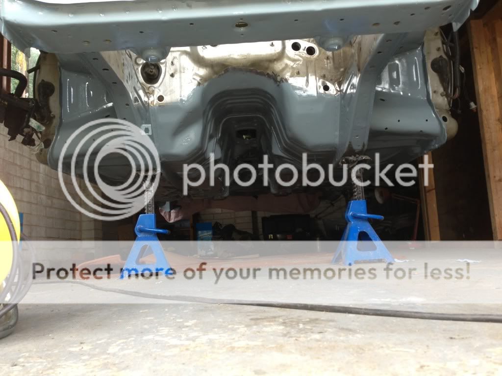

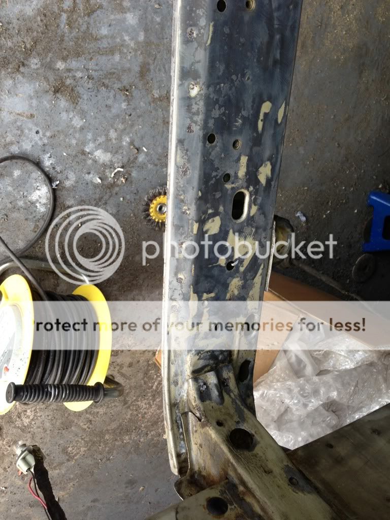

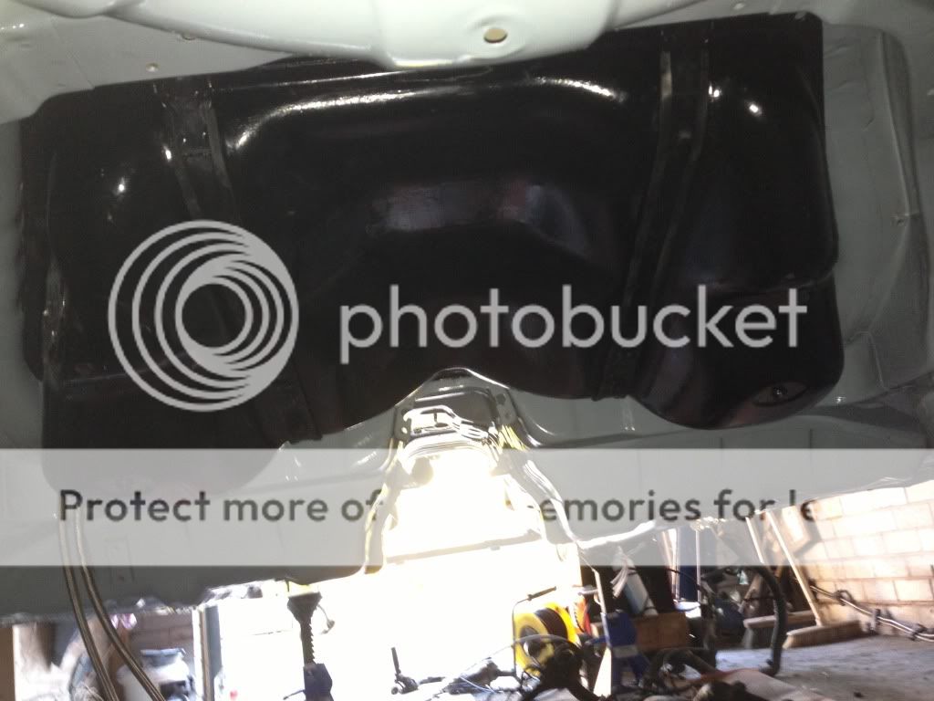

wooo pic time.... Did a few more bits of grinding
Lower Cross Member as it looks like its been at the bottom of the sea on some cars..
Then some Paint,

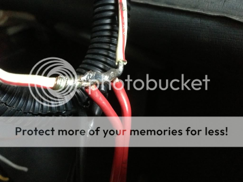

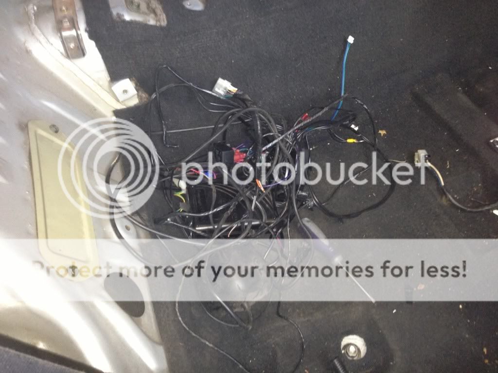

This Birds nest of wire is the alarm i removed it was a clifford 650... It never locked the car, set the alarm off whichever button you pressed, and also tested your patience when trying to remove the immobilizer...so i thought id rip it out and it was an atrocity under the dash!
This was my favorite wiring joint for the alarm to the ignition barrel..

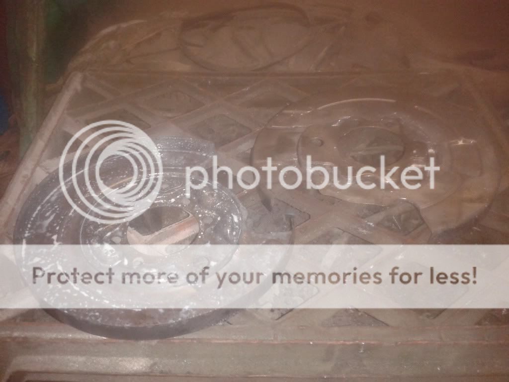

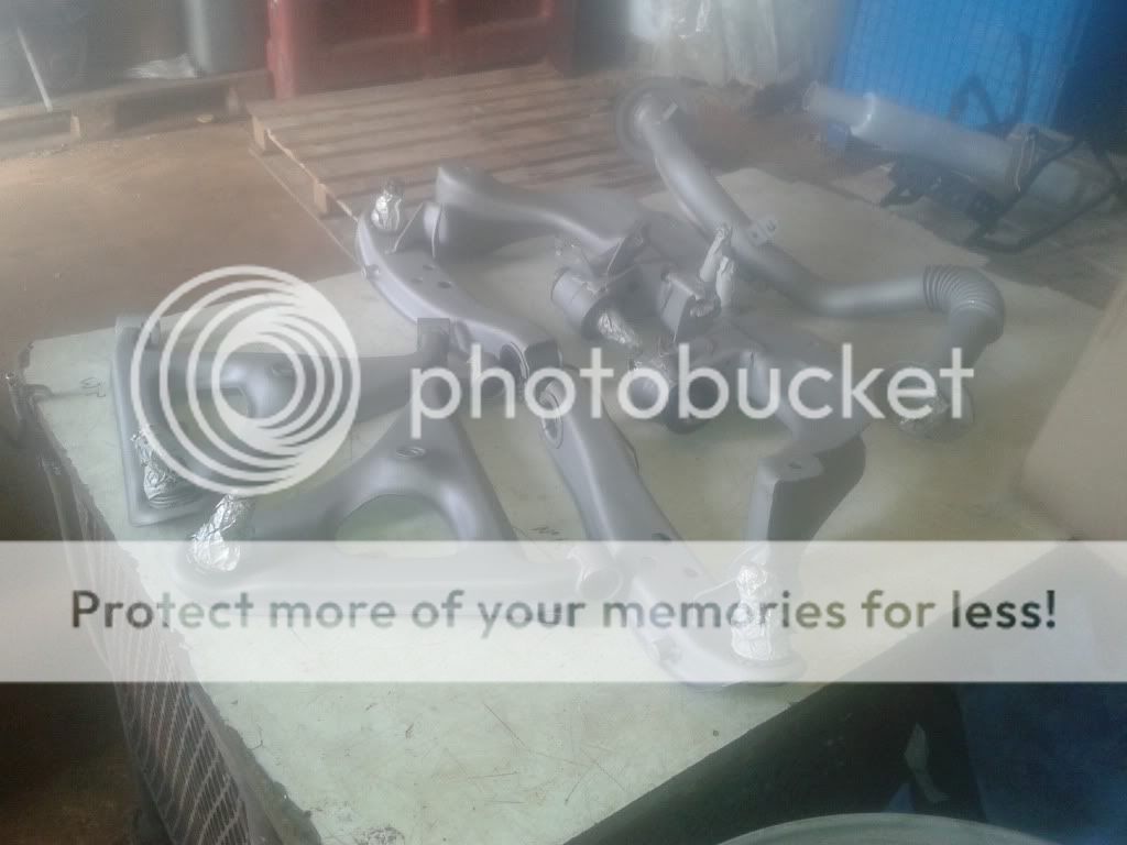

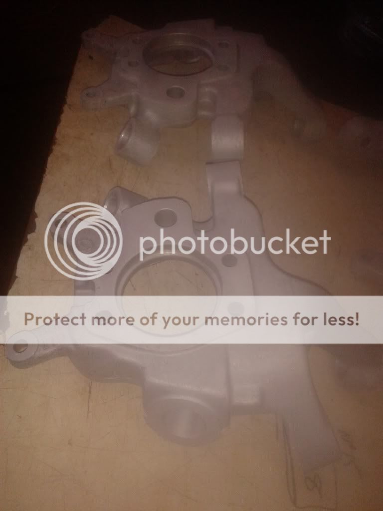

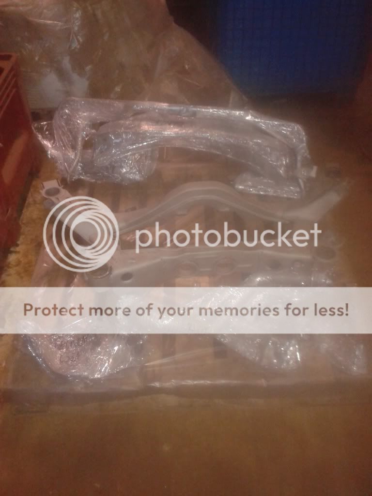

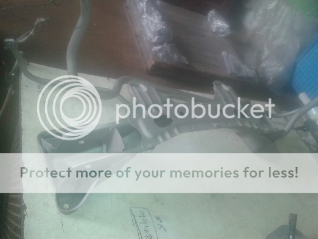

Changing subject now i got all the arms and gubbins which connect to the front and rear subframes and other stuff blasted and powder coated and here is my pile of 'stuff' i mean Christmas couldnt have come sooner!
Here are a Few after the blasting and dipping...
Now here is a few pics of how i received them...

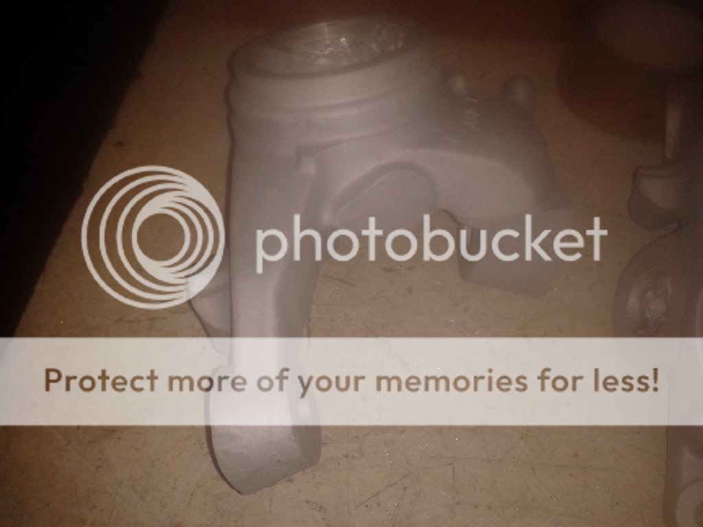

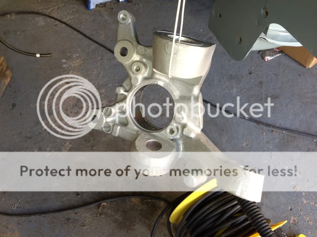

Front hub after a few coats of lacquer
I think the finish is pretty good but the obvious is they coated inside the bush housing!!! idiots, i did ask them not too but hey ho..

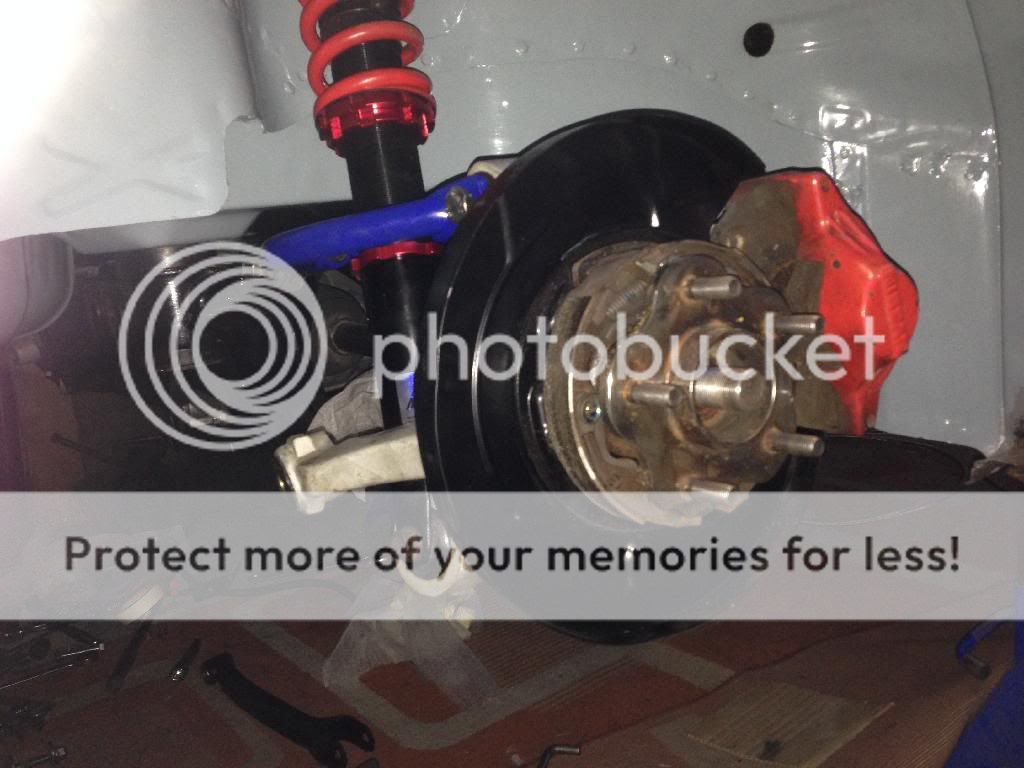

Here with the energy suspension bushing fitted.

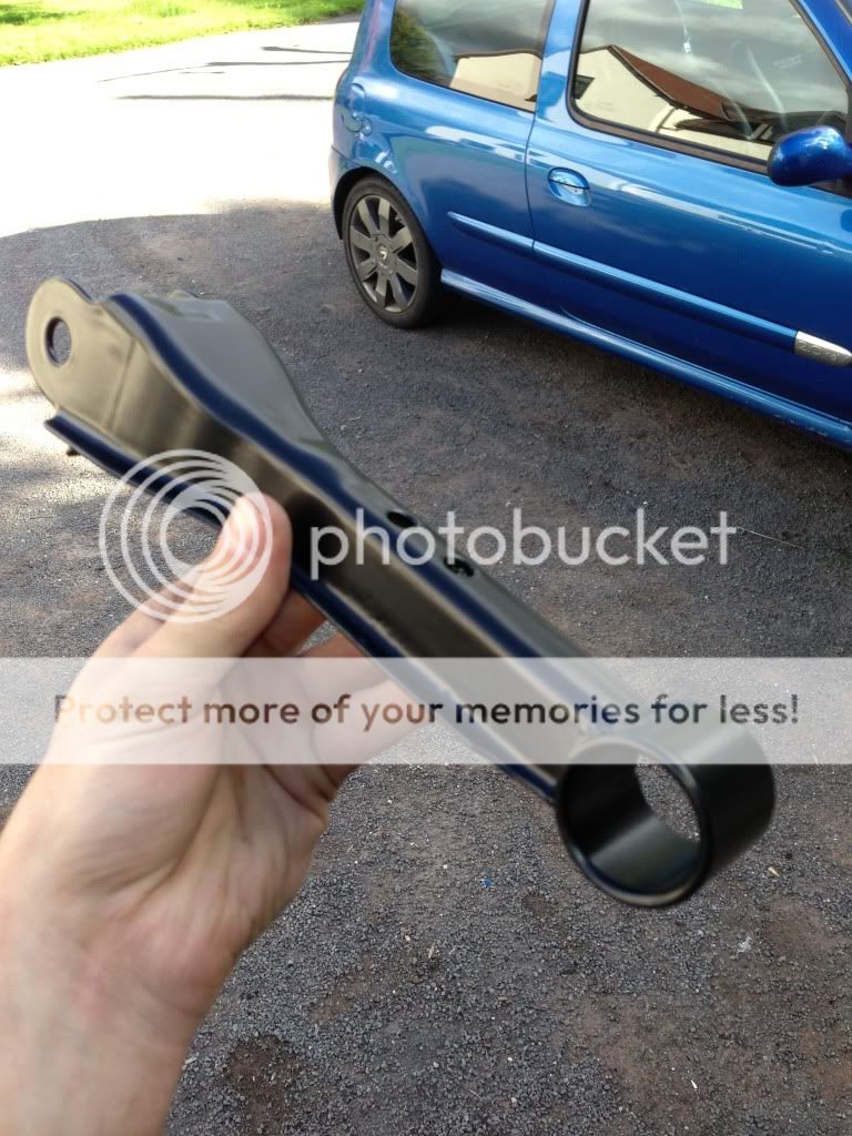

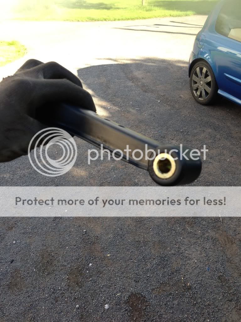

Rear lower control arm
Unfortunately thats all i really have pic wise of the powder coating at the moment as my other half insisted on me glossing the house :(

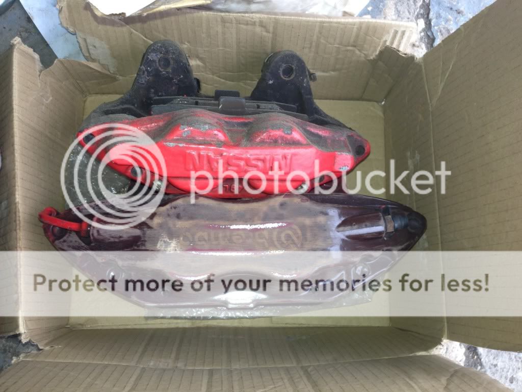

But i did however pick my new front calipers up today!
And a pic of them compared to the stock calipers.

I was just refitting my loom tonight and was wondering if I should remove the alarm or not, still undecided but the wiring isn't much better

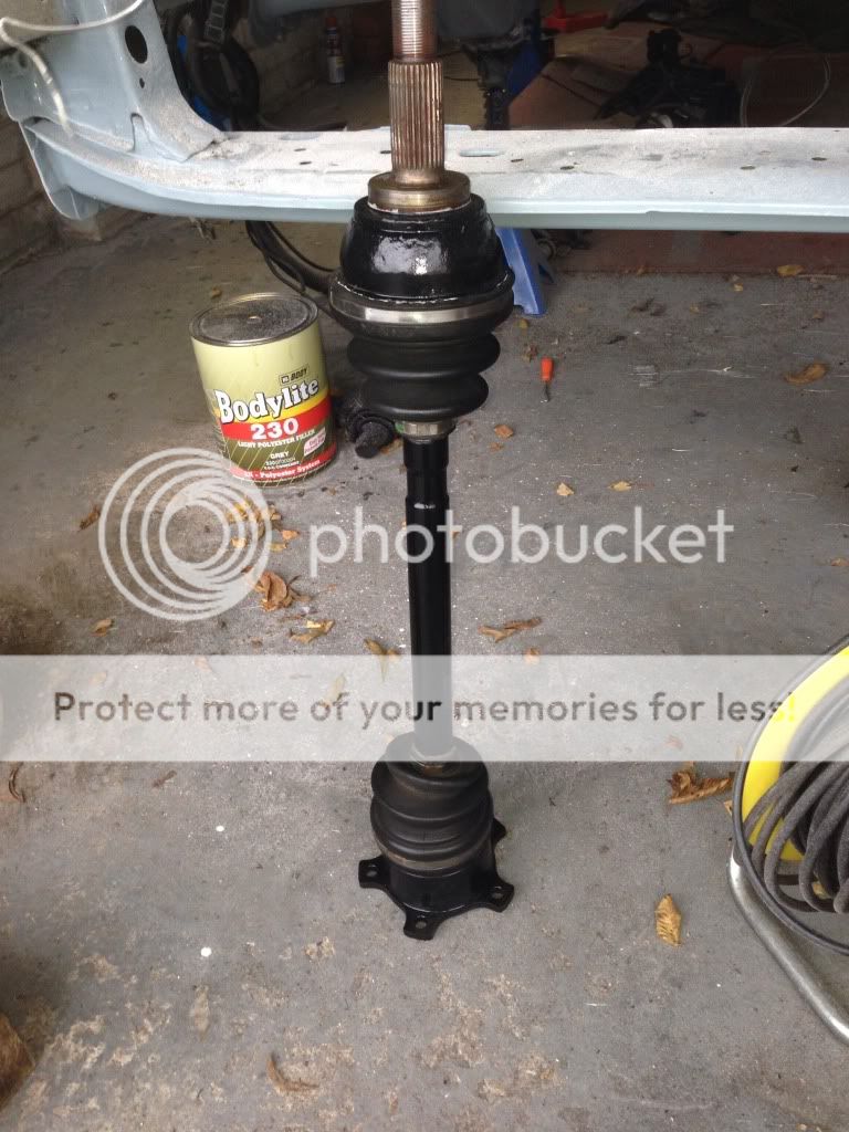

Taste of my front wheels...
