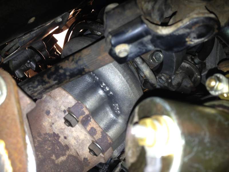

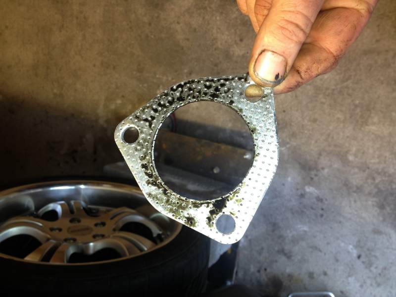

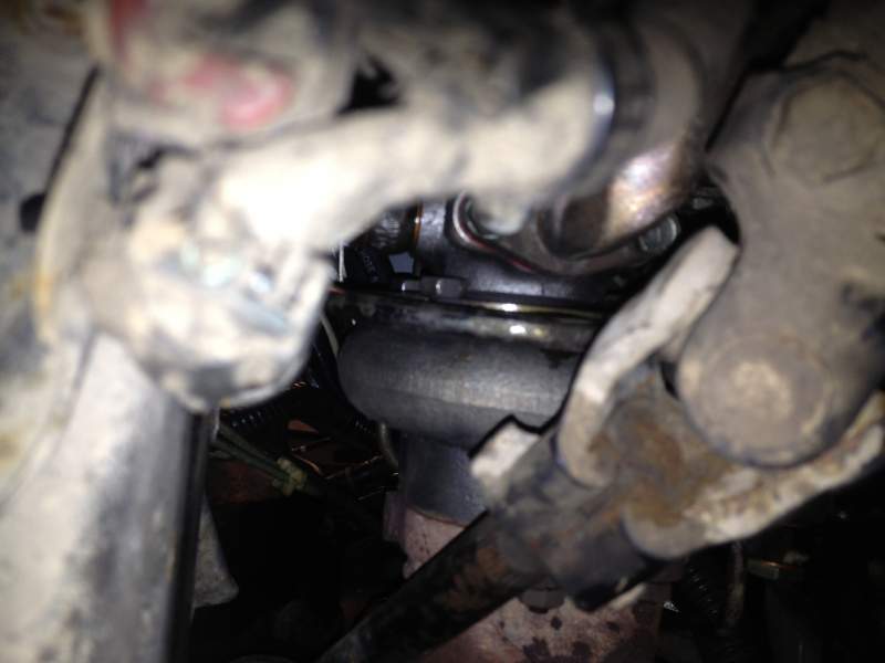

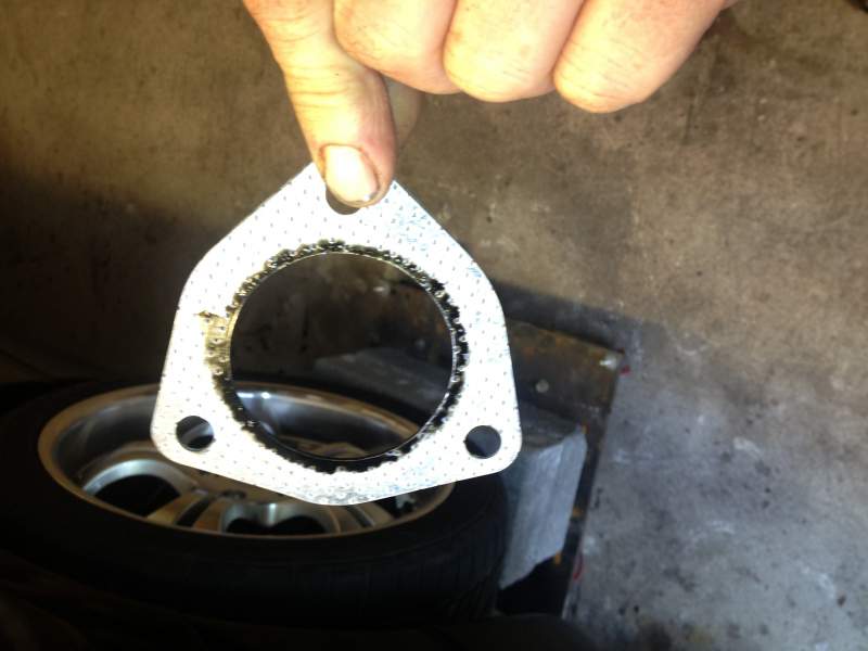

Take 2 good turbo,s that were perfect and none smoking,producing good boost to have 360,s fitted and a bit of tweaking on the housing and blade fronts...fitted them and put the motor in over the w/end and then brought the oil pressure up with the fuel pump fuse out and after good oil pressure let it fire up and idle for 5 mins to be confronted by so much blue smoke i thought ide had a cataract over my 2 eyes. Got under the car and noticed oil weeping from the exhaust housing side on both tubs:angry:...Took the down pipes off and found this...to say ime pissed right now is an understatement,looks like he,s forgot to fit the seals:eek: please Discuss:yes:

that's a lot of oil, blue though......? id expect very thick grey/white smoke, the exhaust seal tends to cause this as the oil isn't combusted, merely vaporised. if its blue its being combusted, have a good look through your intake tract. who sorted the tubs for you? I really feel for you mate, been here myself.
the oil is not on the compresser side,all pipes clean.Its getting into the ellbo,s as per gasket pic and vapourizing. Just cant believe this motors got to come out again for another faulty part:headvswal:headvswal Ime getting sick to the back teeth with bad service and parts

either hes full of caka or hes not using the right terms, there is only one "circlip" in the core, this holds the front plate on, theres no hardship to it, its easy to access and even cleared poled. inside each bearing id held inplace by a circlip type things which has another name. neither of these would allow or cause oil to pass. either they have damaged the rear sealing face of the core or the real seal itself is ****ed!

snap rings...they would leak ime sure iff there not there or have allowed the seal to become unseated
