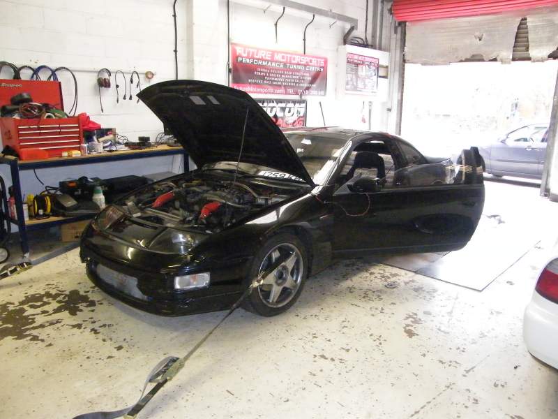

As part of the final stage of development on the Turbonoz Z32, still on stock Auto turbos & injectors but with a Nismo adjustable FPR:
447.6bhp & 462.1lbft Flywheel
389.2whp & 420.1lbft Wheels
Still on 2" IC pipework, stock turbo elbows & manifolds.
At the dyno now, will update if it goes higher. Turbos have nothing left to give: Peaking to 1.45 bar and holding 1.2 bar to the redline. Lots of fuelling left, solid as a rock & very repeatable.
Might upgrade the FMIC & pipework, otherwise this is it until larger injectors & turbos.
For information: my last 1/4 mile run of 12.74@111mph was done at 415.4bhp.

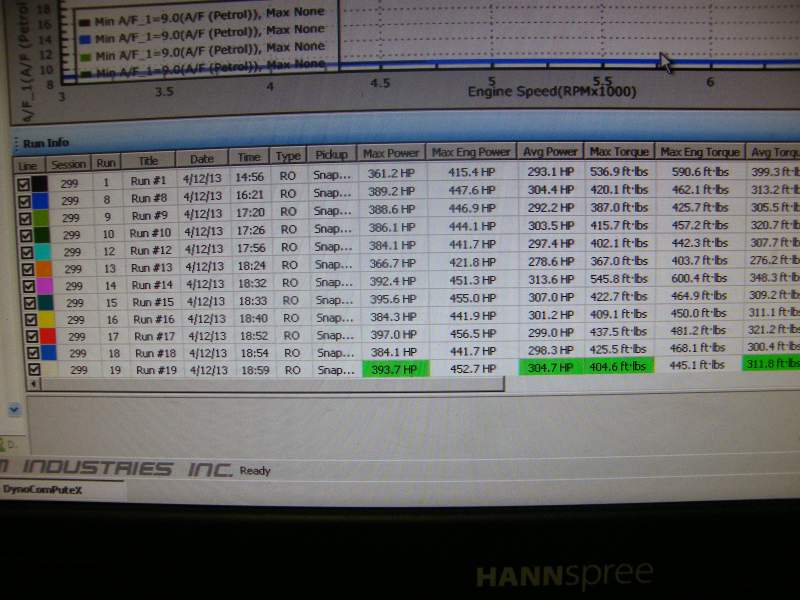

FINAL RESULT FOR NOW:
456.5 bhp & 481.2 lb·ft (Flywheel)
397.0 whp & 437.5 lb·ft (Wheels)

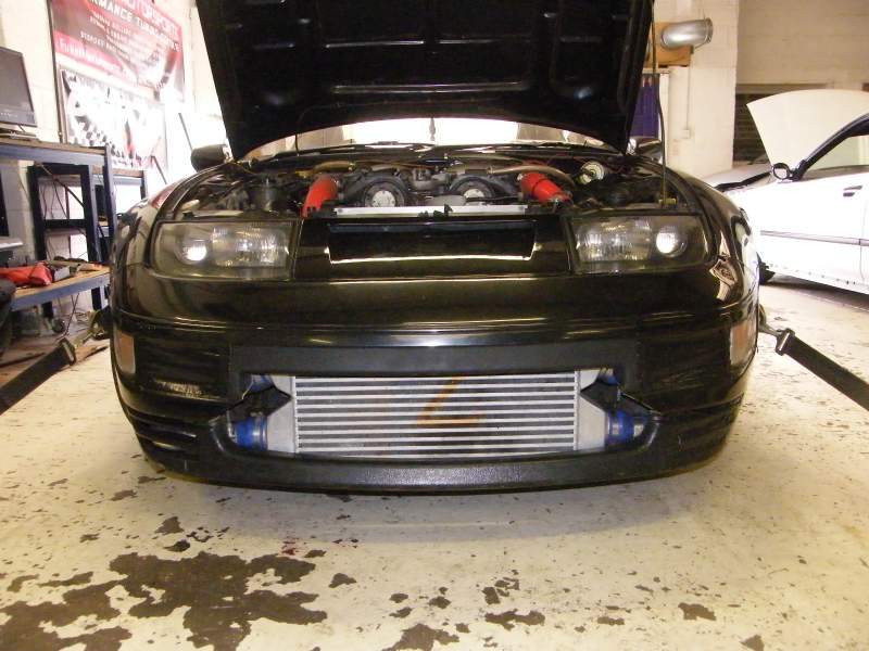

Great effort mate, is it a stock intercooler setup as well I couldn't find the old thread with more info?
Final results of the day:
I think there is potential for more, truth be told my aim was 470 on pump fuel, so I was 13.5 bhp below my target. I've completely rewritten the fuel map from last weekend's drag effort, and it drives a whole lot nicer for it.
I'm going to try a different fuel (these runs were done on Momentum99), and obviously an upgrade to 2.5" pipework plus a total rethink on the generic FMIC would be ideal.
19 power runs, about 25 pulls in total.
Cheers mate. Generic FMIC with paltry 2" pipework.

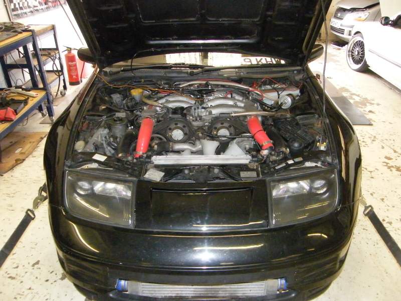

Cool so are you running the twin short intakes where the side mounts normally locate or the stock single MAF?
Dual short intakes with the MAF relocated into the engine bay. Suffice to say, even that hasn't stopped air being forced up the filter causing a rich mixture at speed. I have no fog lights or rain guards, so I'll have to re-block the holes in the bumper. Annoying!
