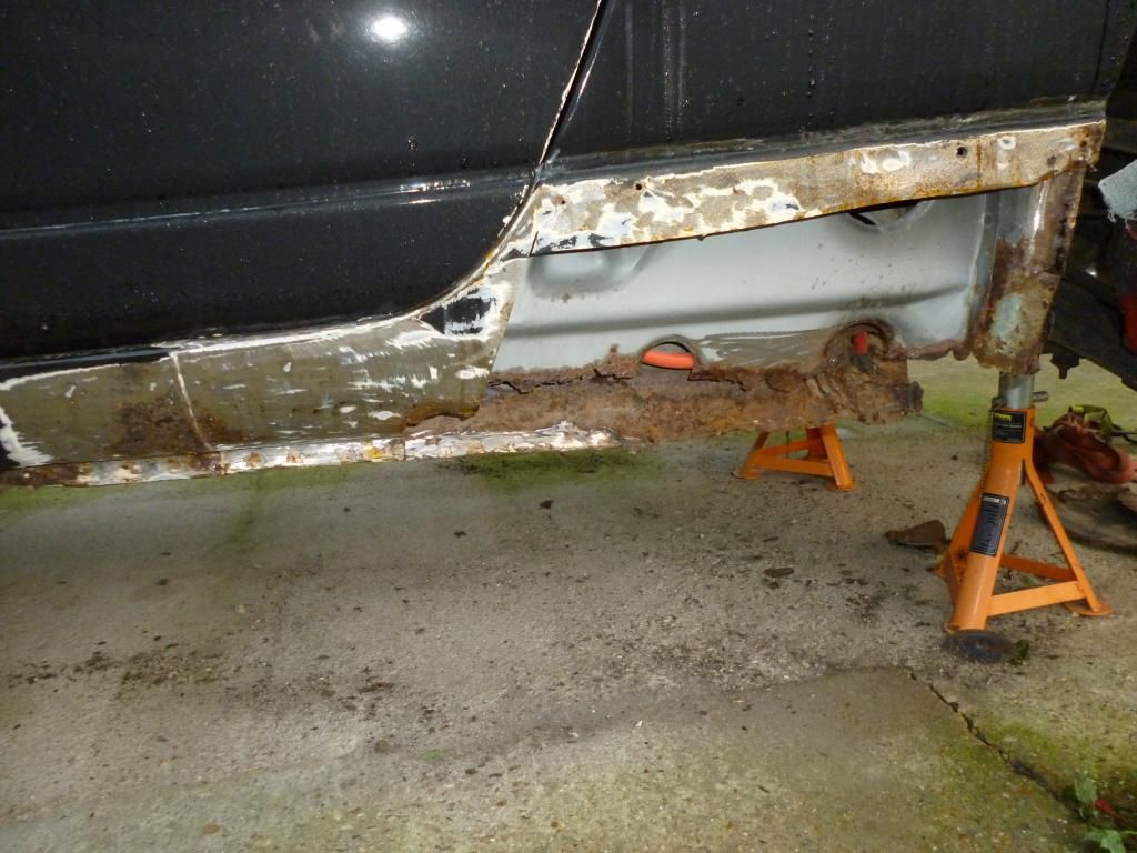

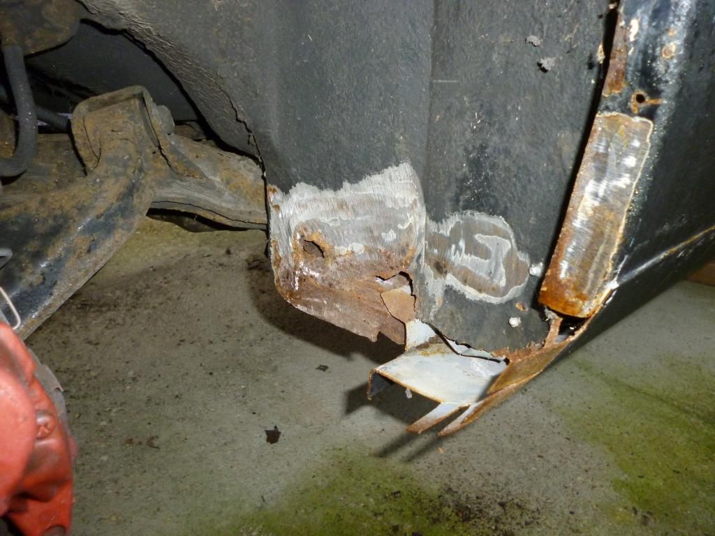

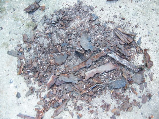

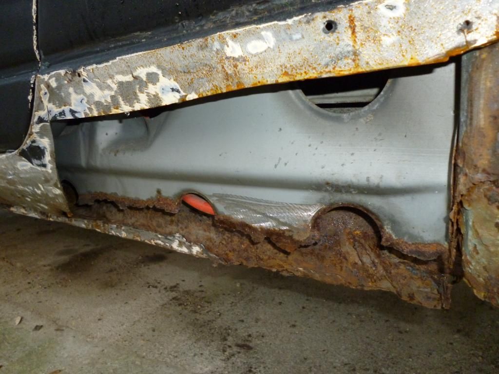

2 years ago, my tax ran out of the zed, sorned it, and started doing various jobs, whilst trying to save cash and doing all the jobs myself, ive replaced with new interior, suspension, and loads of other stuff. BUT MY Main issue was removing the veilside skirts, and it opened a can of worms. rot in the sills, targas draining into them and what started as small areas of rust soon developed into nasty stuff.
After choping it all out, it was getting very worrying, as i thought this is the end of a very late spec UK TT Manual.
But after a bit of time, i replaced the inner sills and returns with new, and had them welded up. so at least the inside stuff was good.

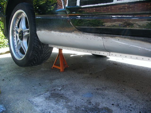

I made new out sills, for both sides, only riveted as to get the shape.
for ages i wanted to get it all fixed as it has to be seam weled for MOT, this i cannot do, as my welding skills are not bad, but i cause more damage whilst trying, and due to money problems the zed was put on hold.

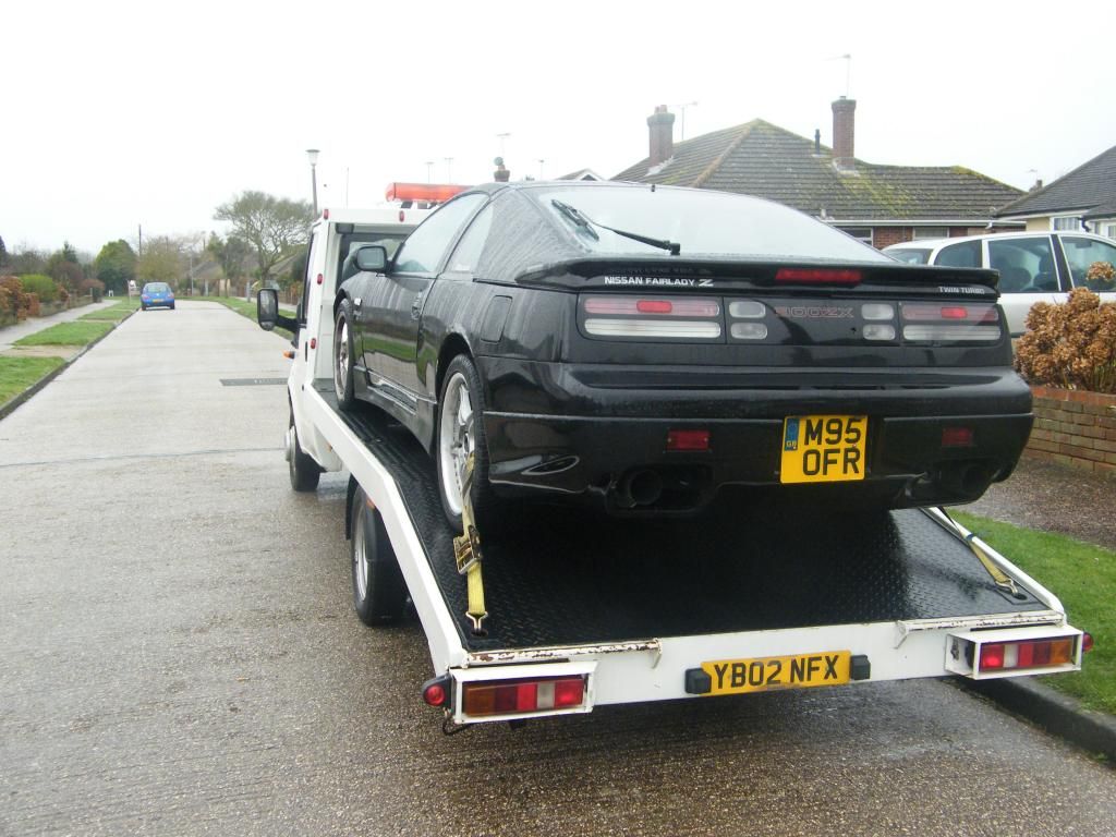

Get a phone call this morning, "stu, your zed is back on your driveway, all done"

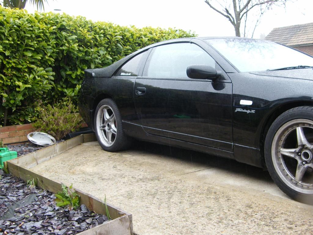

Like a kid at christmas i zoom home to find my lady sitting there.
All new sills both sides, any areas of rust have gone, new targa drains replaced with copper / brass
I can now say i have a rot free UK zed,

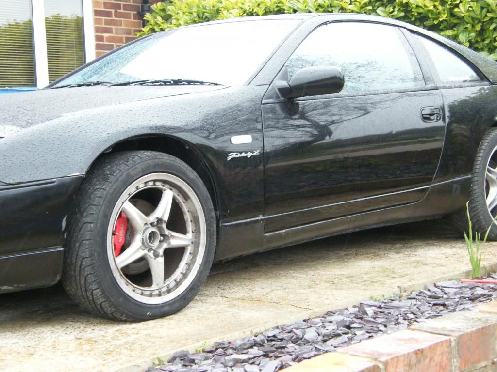

Well chuffed is an understatement, turned the key and she fired into life instantly, a little bit tappy, but this went within 2 minutes. everything working, purring.
Need to put the interior and seats back in, and and check everything. but hopefully ready for MOT.
