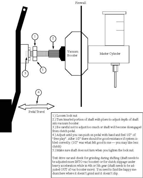

You can adjust the clutch pedal throw, it's a right pain but doable. It's also possible to adjust the push rod in the booster but that requires taking the MC off to get access to.

and this for reference on the pedal.
So what im gathering is,
Undo the clutch switches locking nut and rotated them back until the threaded part of the switch is level with the welded nut they are screwed into.
Undo the locking nut on the clutch rod coming from the back of the clutch pedal that goes to the clutch master cylinder through the fire wall (would be the same even with a clutch booster between them)
Rotate the clutch rod to press further into, or further out of the firewall until the green pad starts to close the switch pins into the switches.
Once the little green pad that hits the clutch switches closes the switch, but with out applying pressure on the switch its self (the switch housing not the switch pin) lock up the restraining bolt on the clutch pedal and the switches and you are done.

Well had ago at adjusting it today, that pin for the clutch adjustment is a pig to get to and turn, but certainly didn't stop my clutch slipping, so its defo new clutch time, though the bite point is still just after you put your foot on the pedal?
Some advice would be to remove the plastic tubing for the Air coming from the fan blower under the steering wheel, you get a lot more room to play with lol
The majority of the time, if the pedal adjustment seems to alter, it's the clutch wearing/worn.

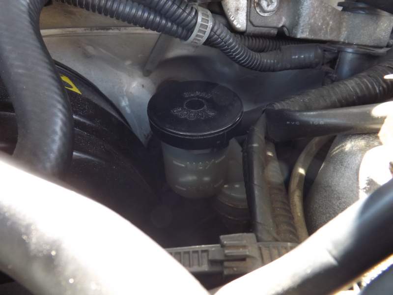

so suns out ,so i had alook at the clutch
on inspection i see there was no clutch fluid in the pot,strange as ive no oil leak or any sign ,then again never checked it from the day i got it ,anyone got any ideas where it may have gone?
all so is there a bleed nipple on the clutch or is it a case of pumping the pedel?
and the lid of the pot does it twist and lock as i see theres 2 lugs on the side but i could only turn it then it stopped at the lugsDSCF0756.jpg
