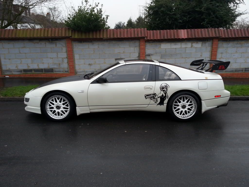

yeah and thats what i have now .. but wanted 19" .. the stance is nice now but i think the wheel looks a little to small in the arch's

according to this site and to your wheels and my ones on a 25et ... to go to a 10.5 wheel i need an ET of 38 ..

i got 10.5 et 38 rears with 285 tyre and no work was done to the arches or camber
do u have a close up pic of your arch and all so how low is your car too
