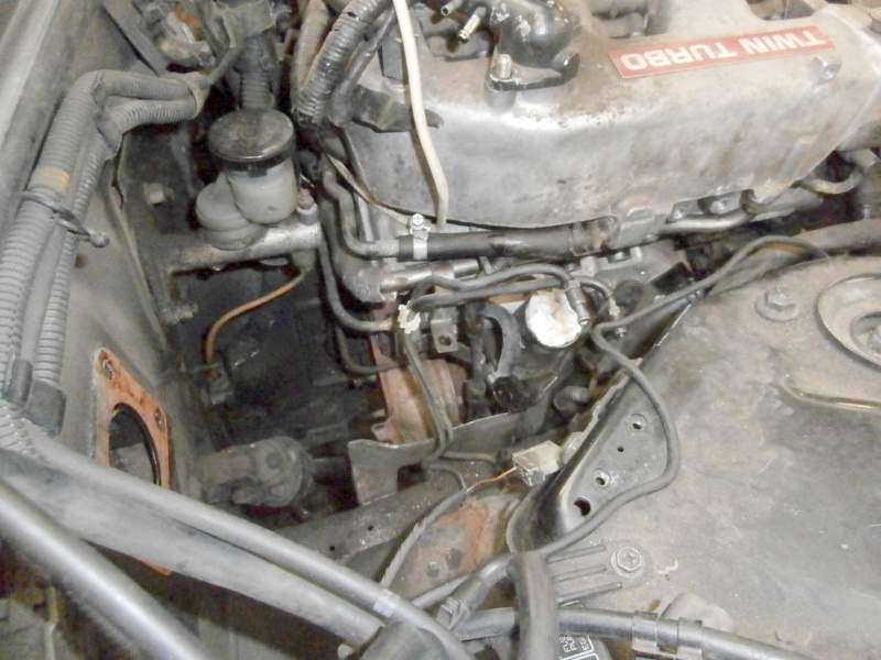

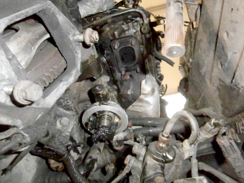

Starting off with the booster and brake master cylinder removed to gain some access.
[ATTACH=CONFIG]69203[/ATTACH]
[ATTACH=CONFIG]69204[/ATTACH]

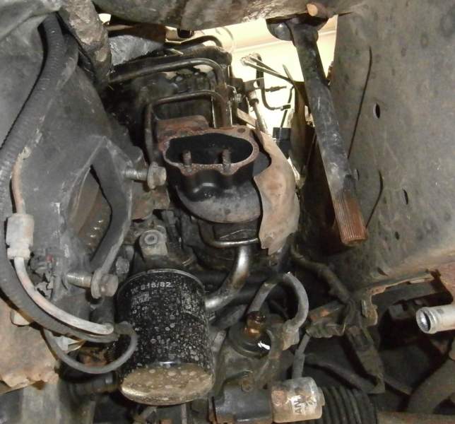

Down pipe and starter removed gives some more access.
[ATTACH=CONFIG]69205[/ATTACH]

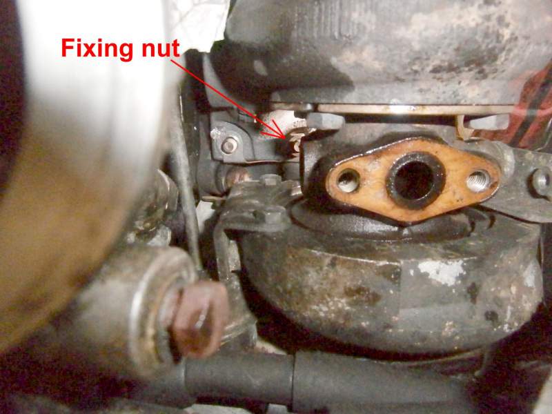

Removing the water feed banjo bolt gave the first view of the "awkward " turbo nut the two other rear nuts are a doddle.
[ATTACH=CONFIG]69206[/ATTACH]

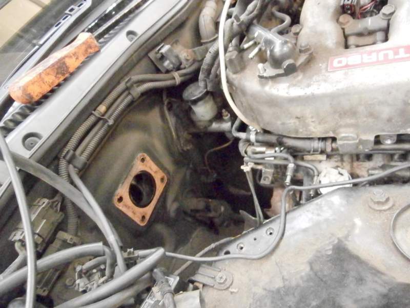

and with some ( lots and lots of ) fiddling and twiddling and as if by magic the turbo is out!!!
[ATTACH=CONFIG]69208[/ATTACH]
[ATTACH=CONFIG]69209[/ATTACH]

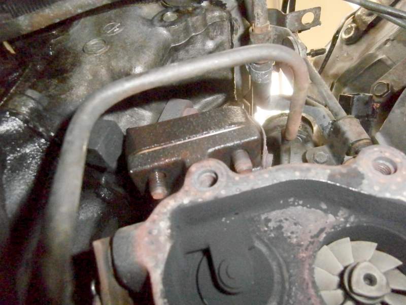

With the manifold nuts now easy to get to, the cause of all of the grief .... the blown manifold gasket!
[ATTACH=CONFIG]69210[/ATTACH]
[ATTACH=CONFIG]69211[/ATTACH]
[ATTACH=CONFIG]69212[/ATTACH]
