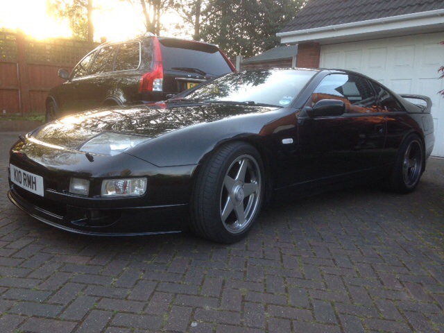

Washed and polished today, ready for Weston Park

That looks bang on.

All washed and polished ready for weston park tomorrow:-)
Wrap looks good, though that's a serious angle of attack on the wing!

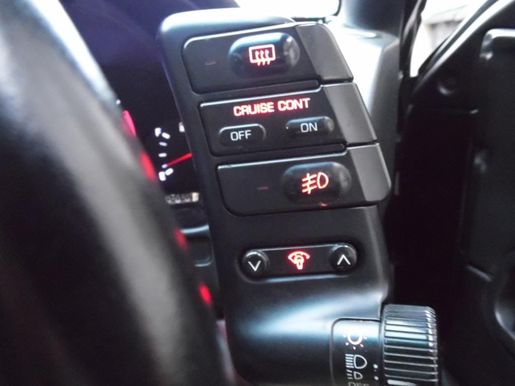

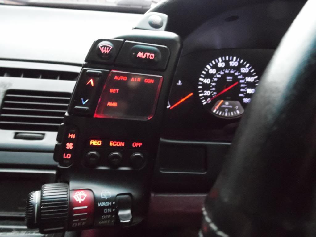

So today found me finally making time to replace the knackered speedo with one that apparently works (thank you, Johnyboy - very much appreciated!)
Whilst I had everything in pieces, I thought I might as well redo the LEDs that light all the gauges. Et voila:
I went for white for the main dials as I wanted a subtle, crisp look. The pods gained a bright red glow about them, though:
Hopefully tomorrow will find me a happy Mondo at being able to tell how fast I'm going!!

Looks good mate, love the white dials!
I had my pods done in white, as like you said about your dials, looks subtle crisp and ment to be.

Mate that looks great, was it fairly straight forward?How long did it take you? I have the LEDs ready to do the same thing.
I used LED strips inside the case, Tom. Seems to have produced a much more even spread of light behind the dials. :)

What LEDs are you using for the main dial faces? So bright and crisp! Mine look like horse shit in comparison!
^^ at least you have better oil pressure and more fuel lol :lol:
My ignition wasn't turned on...!! :lol:
Si: I bought a reel of white LEDs off the Bay ages ago - that's all I've used. I pulled all the clocks out of the housing and strategically laid the strips in there. Basically so every notch on the dials receives pretty equal illumination.
Time-consuming, but it looks so good in the flesh! :)

Si, have you got any photos of what you did?
Sadly not, mate. If you can picture this though: when all the clear and black plastic shrouds are removed, you can see the dials in the white plastic housing. All I did was to fill pretty much all the gaps between the dials with LED strips (stuck to the base of the housing) so the illumination behind the dials themselves is infinitely better than using the four stock bulbs (or, in my opinion, replacing those bulbs with LEDs).
Does that make sense?
