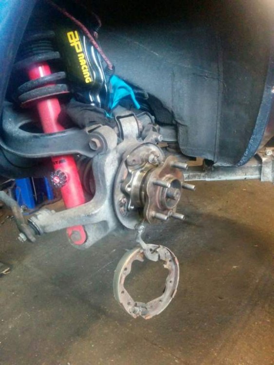

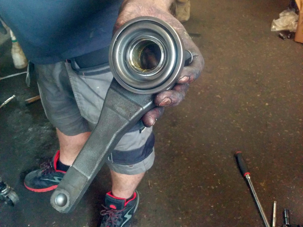

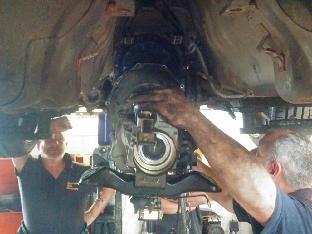

Trip to PowerZed yesterday for new rear wheel bearings and a 350Z clutch fork kit and new release bearing install.

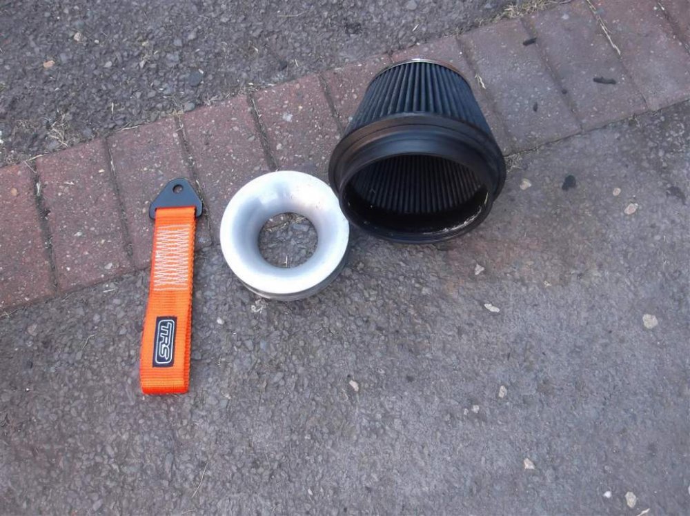

Today I did some mundane stuff.... Changed the tow strap for a new one. While I was in there I emptied the catch tanks and cleaned the little breathers.
The air filter looked a bit clogged up so that had a pressure wash with TFR and a compressed air blow dry.

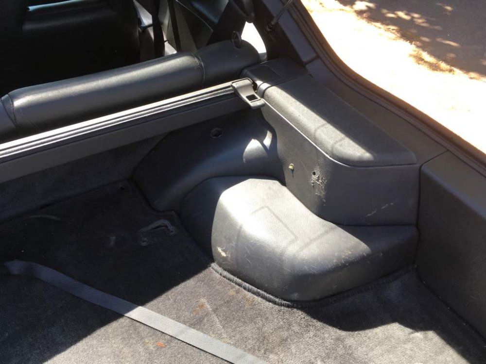

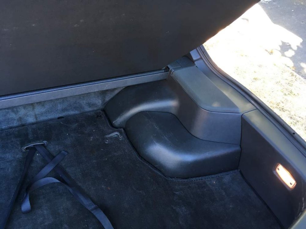

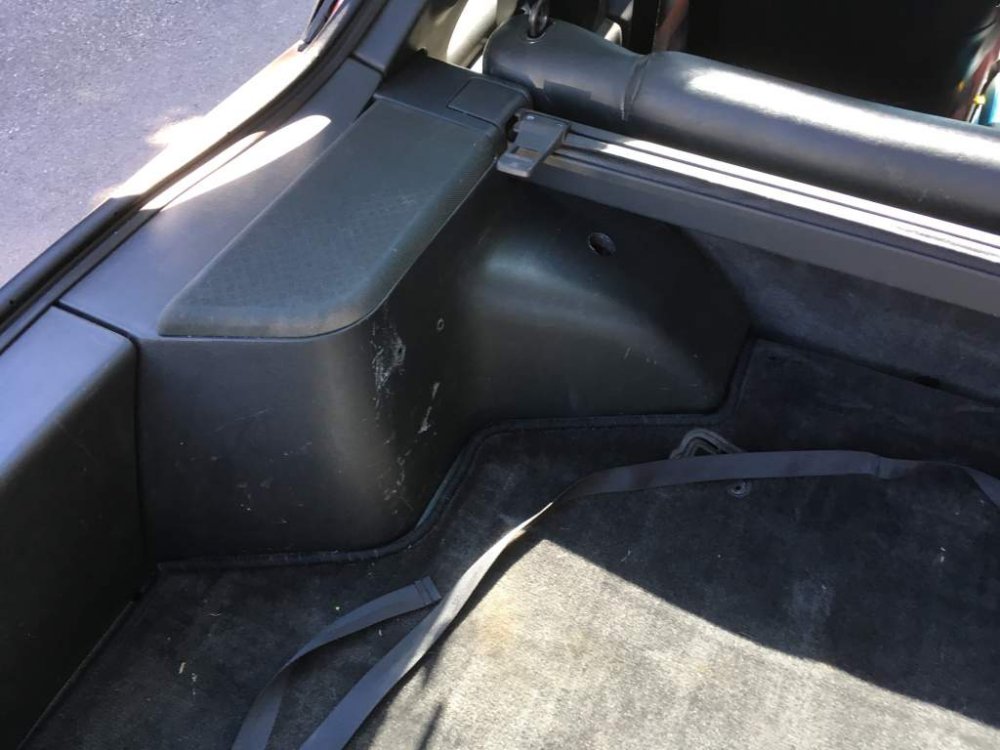

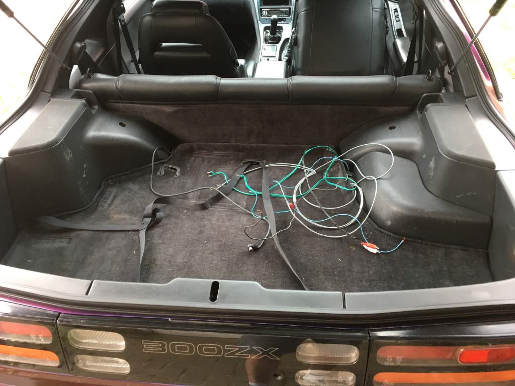

Today I had a bit of time and took the opportunity to change the badly damaged and drilled boot lining over the arches. The original set had several deep scuffs in them but the real issue was where the previous owner had drilled holes to fit a shelf for 6x9s and holes to easily access the adjustable suspension. I removed the shelf some time ago but I’ve attached the picture to keep the progress together.
Now it’s starting to come together but I’m still on the look out for even better. :wink:

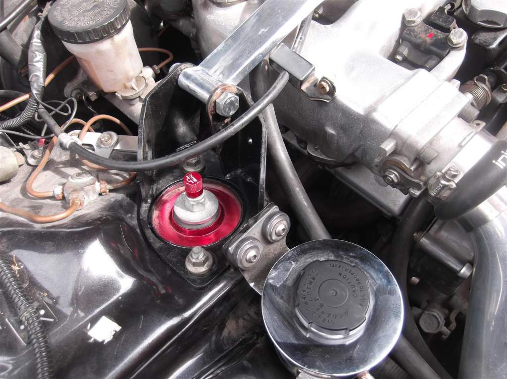

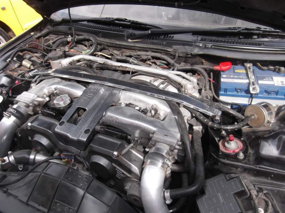

Went to Coventry meet AGM on Sunday
Bought a strut brace from Mike Sandford.
Sourced some bolts that were missing.
Polished it
Fitted it today.
Does it do anything apart from add weight???:whistling:
I think it may help front end rigidity "a bit":yes:
Or is it just useless Taiwan Bling Tat??:lol:
Who knows!
Well if it is properly engineered then this is what should be going on:
[ATTACH=CONFIG]113489[/ATTACH]
[ATTACH=CONFIG]113490[/ATTACH]
Our suspension doesn’t work like that though does it? From wha I understand...It’s double wishbone. The vertical force is applied to the upright and any horizontal force applied to the inner wing. This is why the strut can be held in with a pair of small bolts that require low torque settings, the strut is simply located by them. As far as I’m aware the Z32 chassis doesn’t benifit from a front strut brace, particularly those that aren’t solid. There’s some minor benefit to be had in the rear to reduce lateral flex of the shell, some. The major flaw to be rectified and braced is where the front rails meet the main part of the chassis. Those trianglar braces that go behind the wing.
The vertical loading is transmitted from the coilover to the top mount, this is always in compression and the 2 small bolts only serve to keep the top mount in position.
Triangulation is the best way to make anything stiffer just like in engineering or roof construction, a brace from the top mount to the bulk head (like bmw) is a much better solution aslong as the attachment point on the bulk head is designed to take the loading placed on it by the brace.
