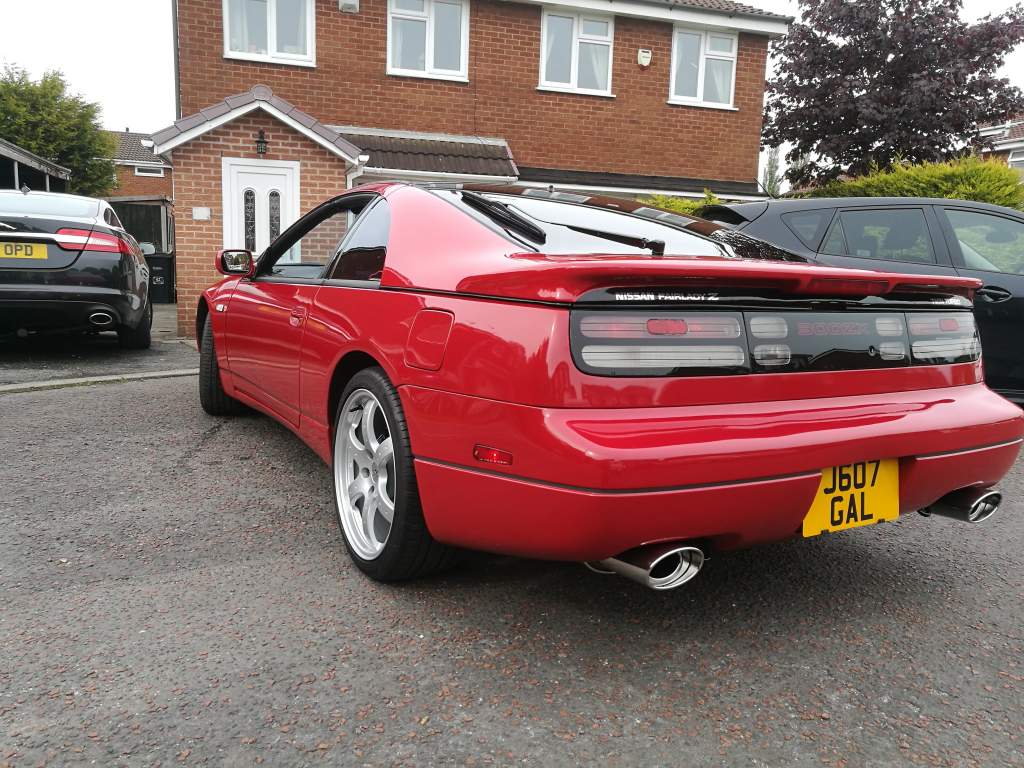

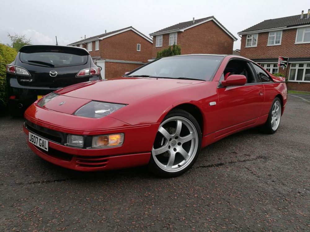

Changed the spark plugs tonight after diagnosing that my misfire was down to a dodgy one. Sounded so nice when I fired it back up, purring as it should.
Then gave her a quick wash and dry and did a couple of small stone chip touch ups. I'm still happy with the black strip on the rear as there appears to be no bubbles or creases!
I'm going to use it for work tomorrow to clear out the exhausts and check it's running ok for Sunday.
Saturday is going to be a polishing day!! :)
[ATTACH=CONFIG]112213[/ATTACH]
Looking GOOD mate....:thumbup:
Thanks Richard. It desperately needs a good polish though.

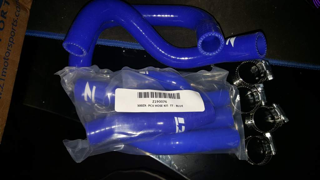

oo new shines from z1 motosport, pcv and heater matrix pipes gonna stick with the blue pipes theme in the engine bay.

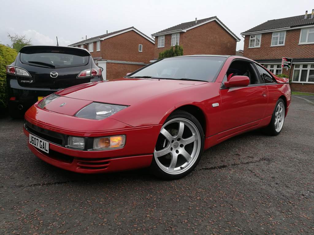

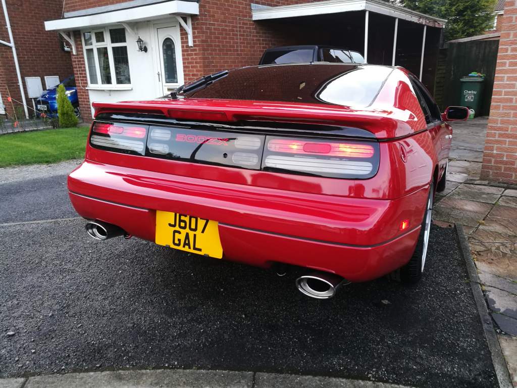

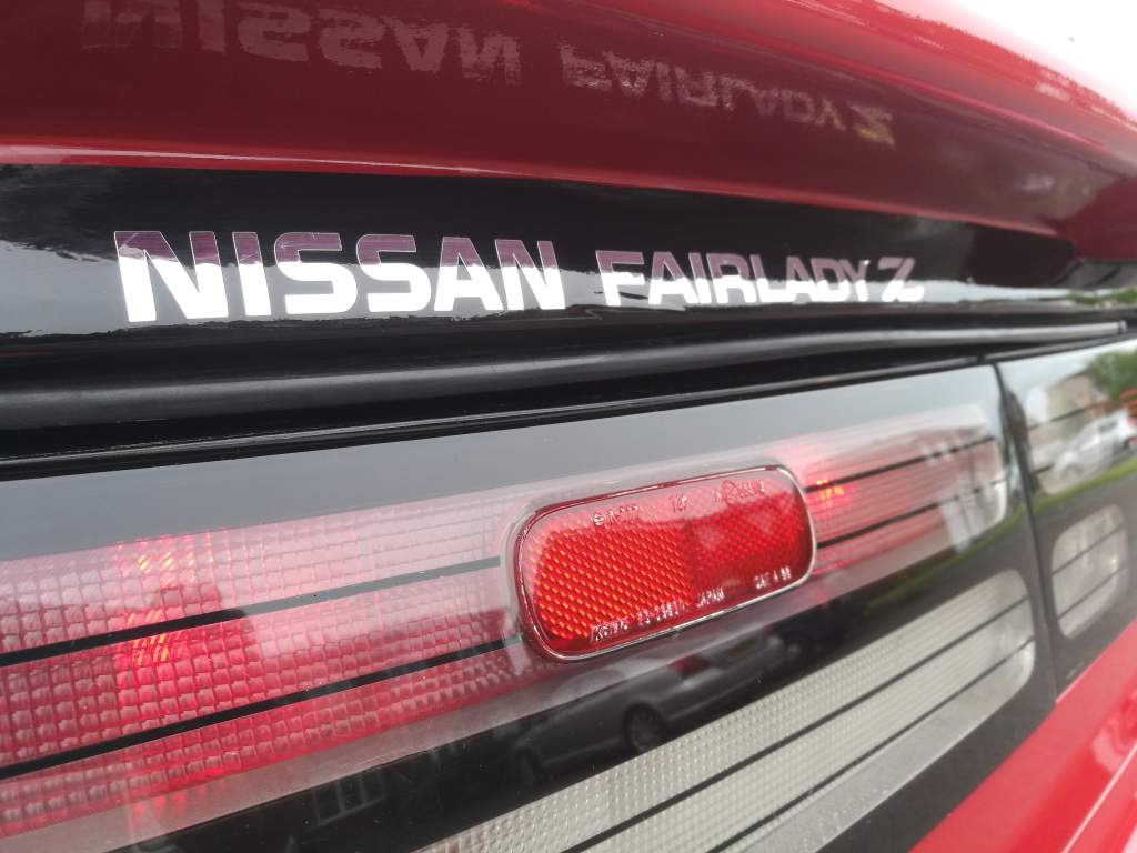

So before "Total Retro" car show tomorrow, the deep clean happened today. Clayed, Polish and Sealed..... Wheels included!
Then a few paint touch ups, trims restored, exhausts polished and then a deep clean of the interior. All leather conditioned and then a quick spruce up of the engine bay too.
I then finally stuck the "Nissan Fairlady Z Twin Turbo" stickers on that I got from Phutumsch about 3 years ago!!!!
Finally, the car seat was fitted for Alex's maiden drive in a Z.... I reckon she looks excited:)
