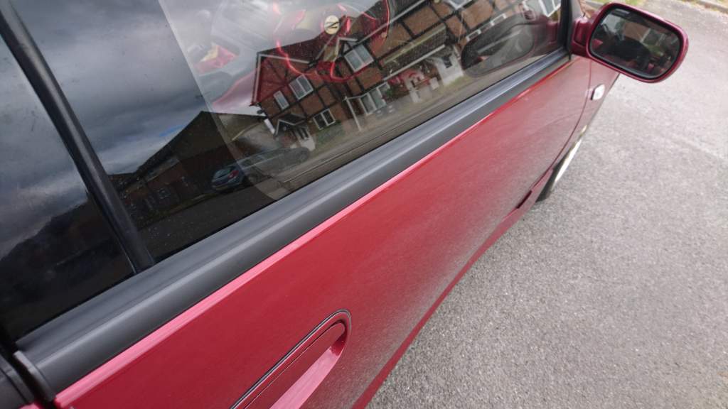

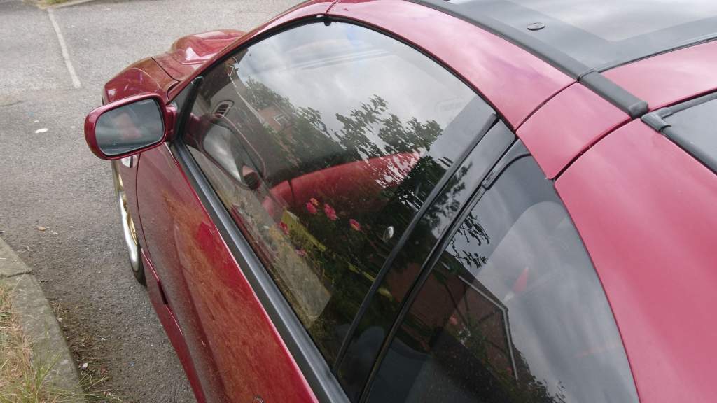

All the trims replaced now! Targas both done and the new door strips fitted aswell.. Now hoping the targas don't leak after the rebuild.. I can finally move the windows up and down without that nasty squeak and the glass is no longer being scratches to buggery either..
