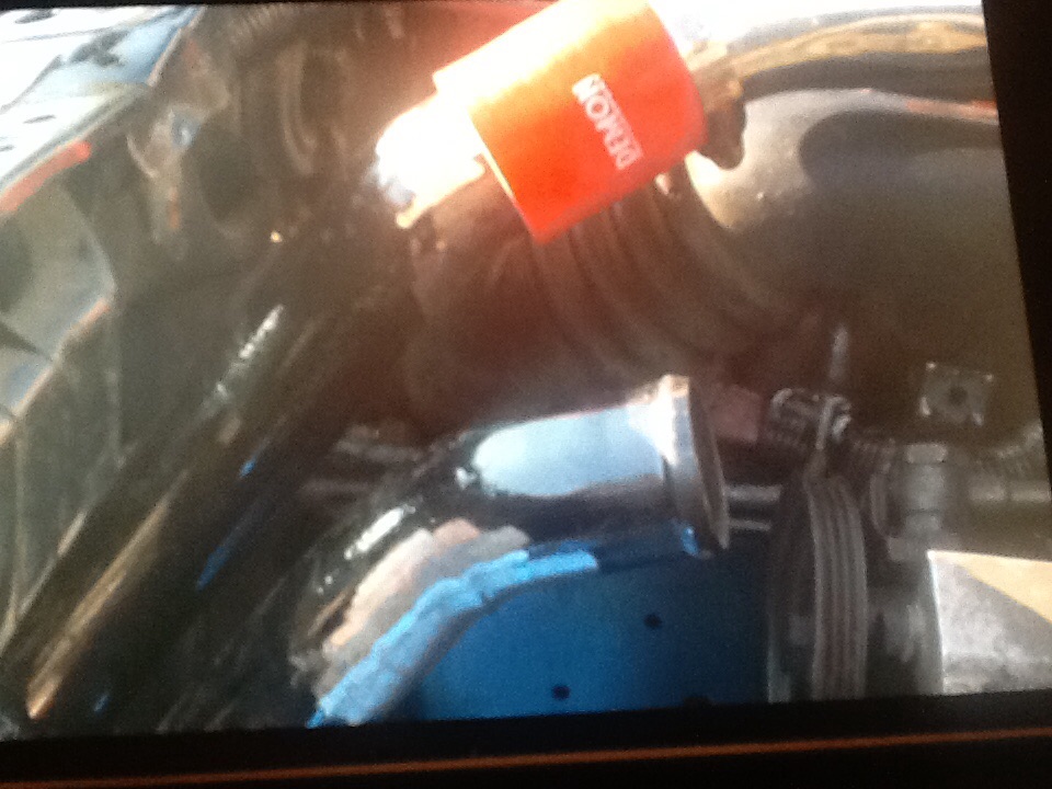

Well a productive day aiv deleted carbon canister gone grinded the brackets off the intercooler hard pipes didn't like them just need to clean them up and paint them turbo water hard pipes capped off going to remove the rest off the air con pipe work tomorrow and new injector fitting kit done image.jpg

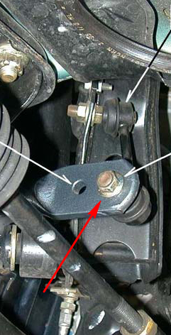

Today I managed to find some time to track down the source of a slight knocking from the front drivers side suspension. I first noticed a very slight noise a few weeks ago but hadn't had the time to investigate, I initially suspected it was the exhaust knocking but I managed to isolate the noise the the front drivers side.
Up on the ramps and a good prod around revealed that the nut that mounts the drop link to my Stillen anti-roll bar had slightly loosened.
Ideally, I'll replace the nuts for locking nuts, but for now I took the nuts off from both sides, reinstalled them with some loctite 222 threadlock and torqued them back up. I then spun the car around and checked the rears for security which were fine.
I then took her for a spin out to prove the fix (which was now tip top) and nailed it through some bumpy A road country lanes, love this car, it really does pull like a train. #stockboost #9psiclub
Some piccies from my phone:

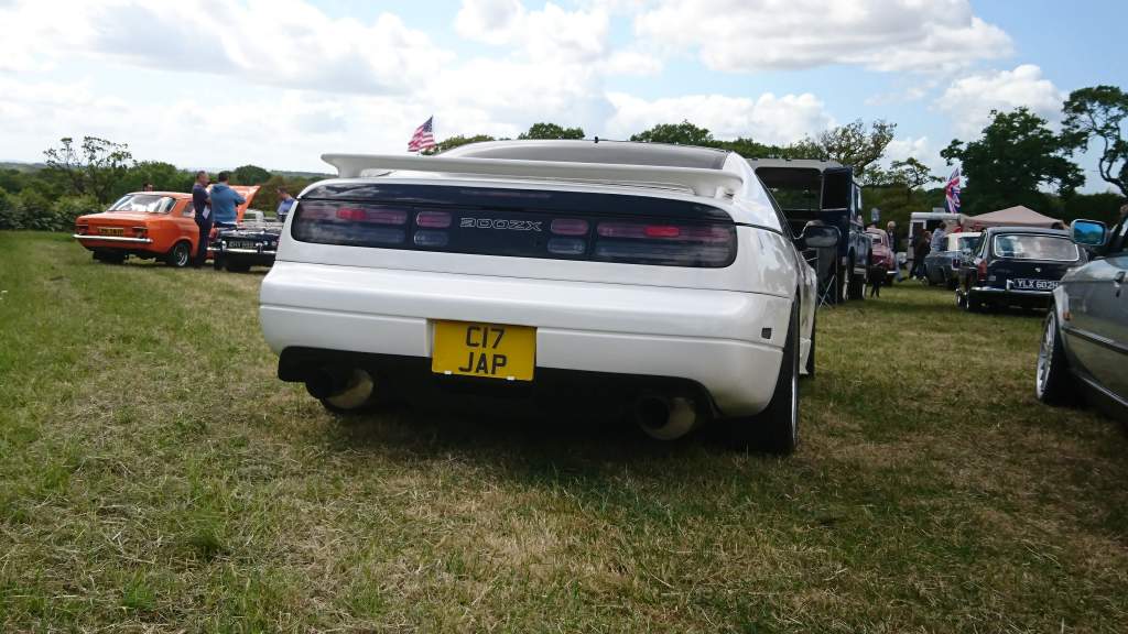

I went to Battlesbridge Classic Car show with Paul and Chris...... Unfortunately the wife had a sudden Carshow Migraine and I was forced to come home very early......
But was good while it lasted.........
And my Z made it there and back for a change..... lol
Great to hear she's running well Russ, any worthwhile pics??
Went to a local car show today. Weather was perfect. Got some nice comments about the Zed too.
Was it a good show Tom? I would of popped along but I needed to spend time with the wife and grandchildren as I was out all day yesterday:)
It was really good mate, lots of different types of cars, must have been around 200 cars there. Spoke to a guy off the forum who only lives round the corner. Will keep a look out for the next one & let you know.
