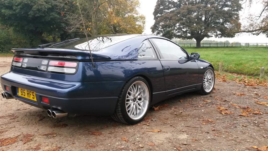

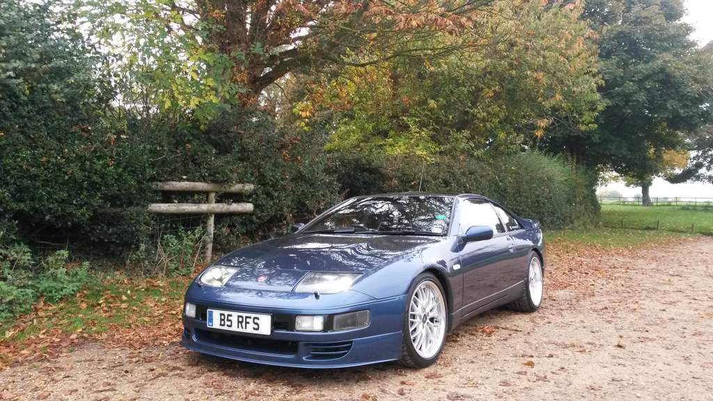

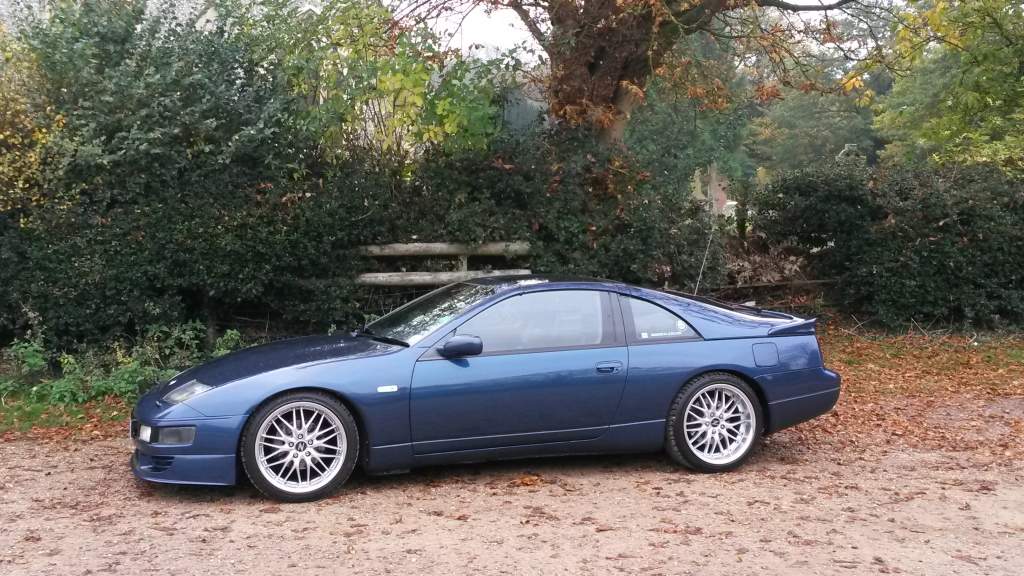

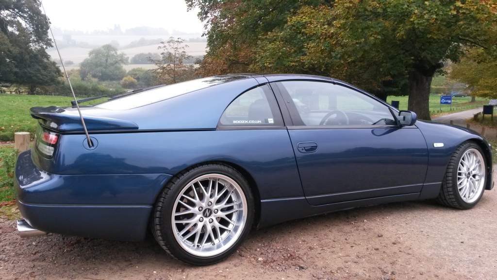

I took mine into High Wycombe on my Saturday morning Sainsbury's run.....
......And then stopped off at Hughenden Manor to take a few pictures of my Zed in Autumn's glory.....:wink:
I thought it would serve to kick off our latest competition:
