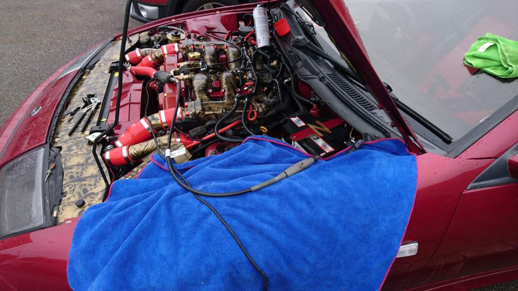

OK, progress report number two on the mysterious misfire..
After running tests on just about everything from ecu to plugs and everything checking out, I was at a loss.. However, the first test on the injector showed up that the injector was working fine with 013 ohms reading across the terminals..
As the car had begun firing on six again for a shirt time on Monday, I trusted that the injector wasn't at fault. However I have been out with the meter again today and guess what?? Injector 6 shows no reading at all.
Thus the conclusion is that the injector is fried.

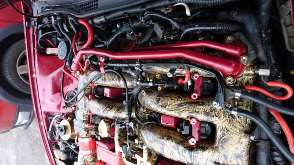

OK well I decided that for now I'm only going to change injector 6, so following jimmers helpful guide to butchering your plenum, about 20 Dremel s bits later and we're in business.. :thumbsup:
Anyhow, the good news is that the injector change has been done and...... She's alive :biggrin:
About to take her on the first test run but things are looking and sounding as sweet as ever...
Here's some pics.
