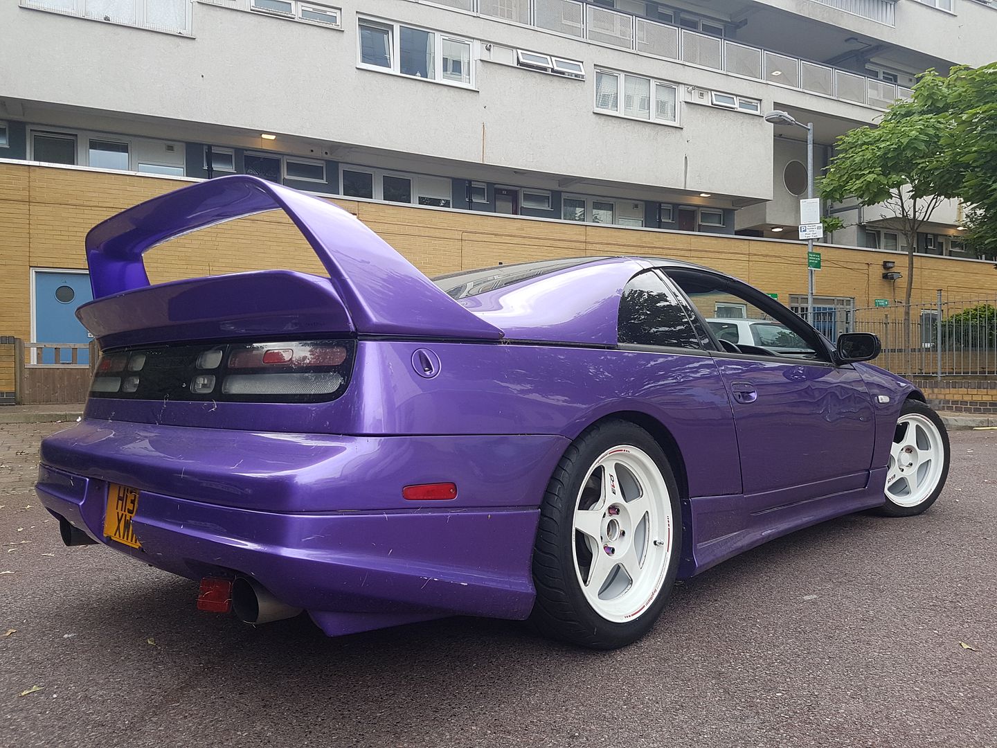

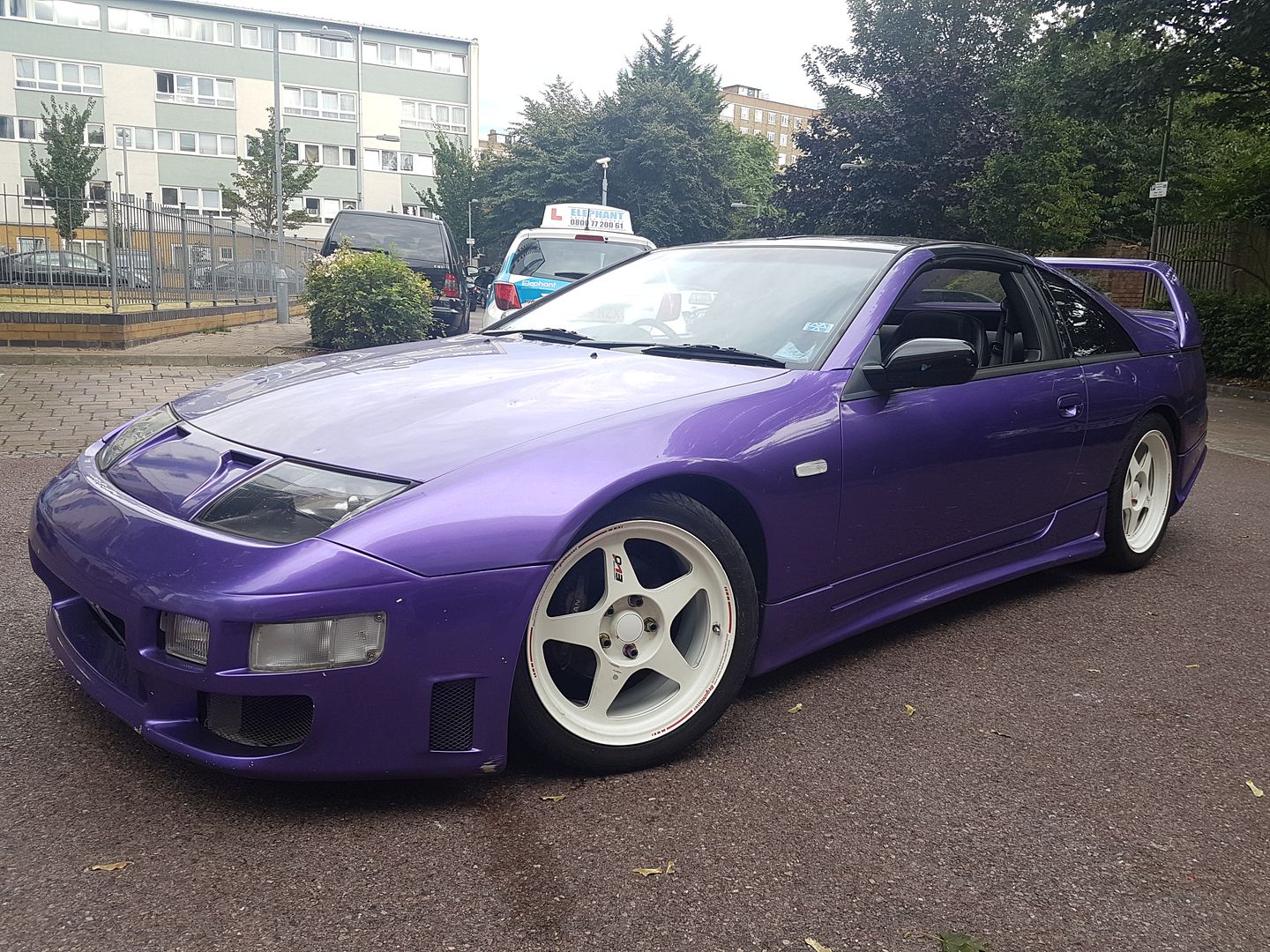

Bought some wheels for my DC5 last weekend but before i can get them fitted i thought i'd see how they look on the Zed...
