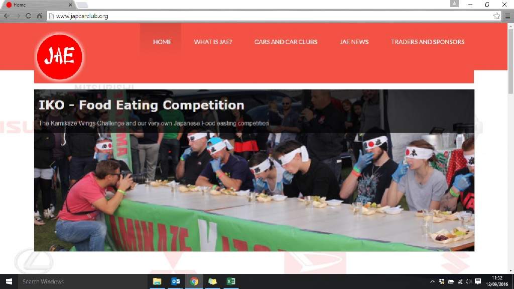

Did anyone else get an email yesterday from the JAE organisers?
I did, and it basically said "the weather and turnout have been a bit crap this year, so why not come down on Sunday and just pay £15...?"
Had a bit of a chuckle as I deleted it..... :lol:
JAE 2016 has been one of the wettest in recent memory but now the rain has stopped and the sun is trying to break through. The off-road 4x4 has certainly been exciting - a lot of puddles and a whole lot of fun! This year's IKO has been curtailed but we will replace that with a Sunday morning special of IKO, fun and car shows. The 2016 Show n Shine has been the best ever, held indoors for the first time.
For Sunday we now have general access available. £15 on the gate and concessions for under 12s who still get in for free. 4x4 tickets are still available as ever at £20.
Come and join the fund - Sunday looks to be dry and we still have plenty to entertain those who missed out today. See you at JAE 2016!
