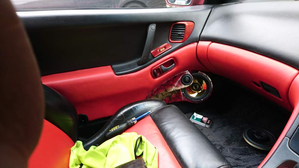

I traded a couple of hours of sleep to try and get my door cards in today.. Was a complete sh#t as I was tired and have fingers like saveloys, but managed to get the passenger side in.. Tested the speakers and found I'm gonna need an amp, as the 40 watt output of the stereo isn't man enough to get much out of the 400 watt speakers.. DSC_0355.jpg

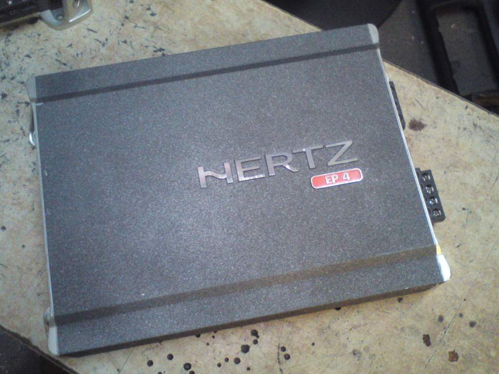

I might be able to help you there......
[ATTACH=CONFIG]100986[/ATTACH]
Ahhh, Mr phutumsch... That's a rather interesting looking box you have there! 400watt 2 channel amp by any chance?
