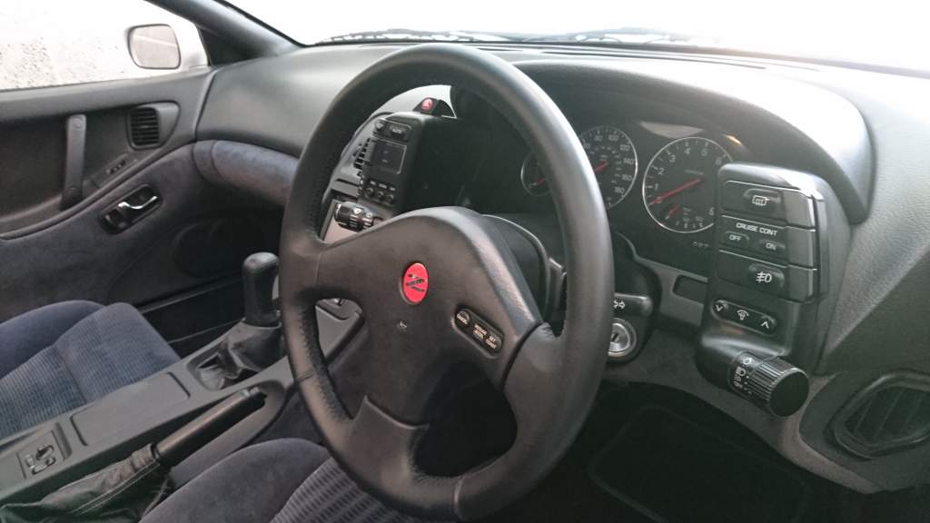

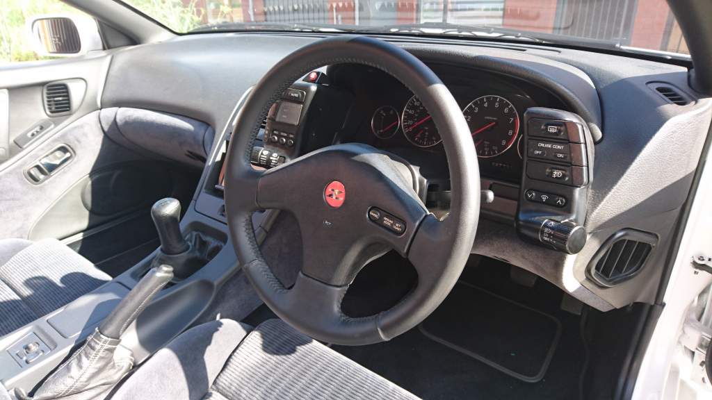

Fitted my Mondo trimmed wheel today, rewired the cruise control harness so that it works via the slip ring rather than the CC paddle. All works and very happy with it! I love my Nardi wheel, but this feels much nicer and it gives better visibility to all the controls and switchgear. I can now see my CC illuminated and my indicator stalk! I also prefer having the cc buttons on the wheel. Whilst the early steering wheels are still not my favourite in style, they're more functional and feel better IMO.
Also fitted a newer style indicator stalk which has the flasher decal on it and obviously a replacement upper steering wheel shroud. Some keen beans may also notice my UK-spec hazard switch. ;)

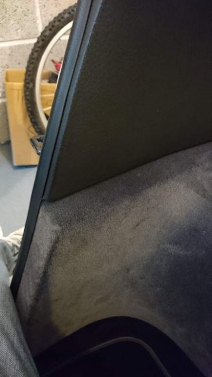

...and finally! Decided it was time to fit my US-spec rear quarter panels. Those of you who have either changed your interior from S1 to S2 or have done the new belt change might be familiar with this, I wanted to keep the belt locations where they were, so the lap belt and the door pillar belts. Only way to do that was to modify the door cards, which was done. However you're left with a cutout in the rear cards where the B pillar belt would go on newer ones.
Well, in the US, for about a year only, the belts were in their original configuration, but with the fabric interiors. I managed to get one from a junk yard in Los Angeles with the help from a friend and then the other, I found online in Pennsylvania. Well, they both eventually turned up from different sides of the US and my theory and fitment worked! I have a full retro-fitted S2 interior with the S1 belt locations. Very anal, but I love doing stuff like this! Took me about a year to track both parts down and have them shipped over, they're really difficult to get as most of them have belt cutouts!
[ATTACH=CONFIG]100046[/ATTACH]
You're lucky they haven't faded that much...
They don't appear faded at all and match the rest of the interior perfectly. It looks like it always came that way. So happy with the result.
