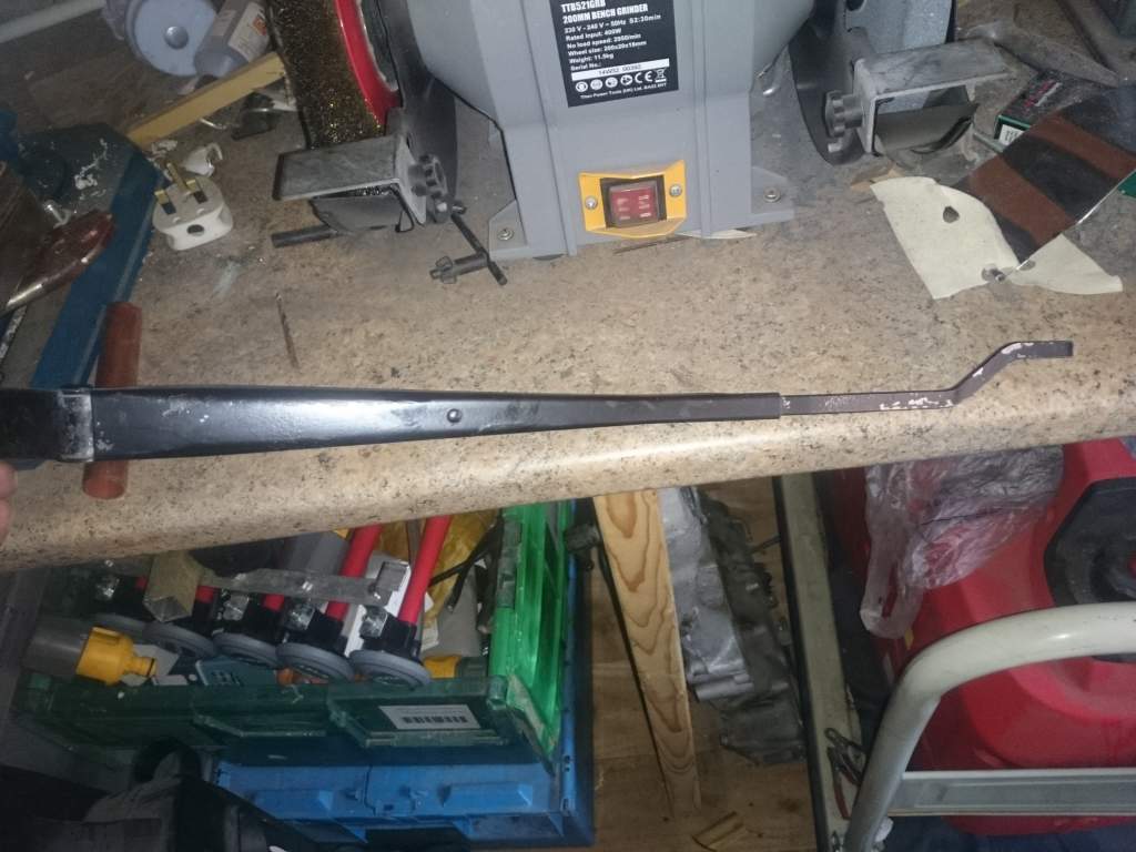

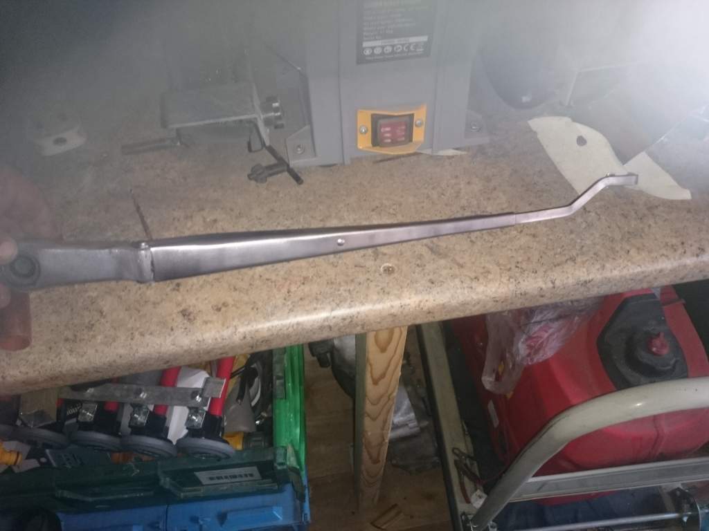

I'm getting bored and anxious without my Z here so I'm finding things to occupy my time.

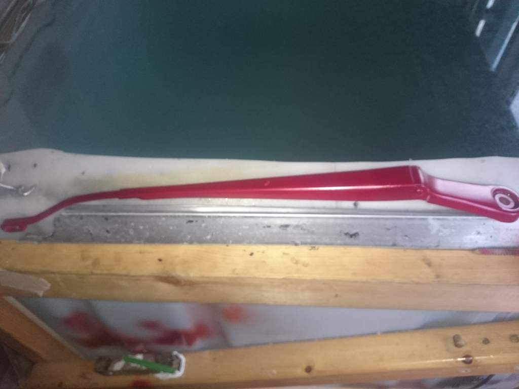

I took the wipers off the scrapper today and went to town on them..
[ATTACH=CONFIG]98695[/ATTACH]

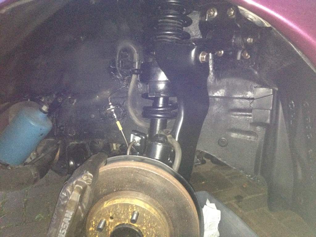

Finally put the new brembo brake pads in the N/S front and rear callipers and fitted my nice new shim kits. I polished the metal pins and calliper spring plates while I was cleaning it all up.
I have also fitted Goodridge speed bleeders to the callipers to help when I fill the brake system with some new fluid.....
All painted and ready for me to start the O/S rebuild.....
a few pics quickly snapped tonight....
I think I need some new grooved brake discs to go with all this work now........ lol
Nicely done Russ.
Cheers Stephen.... spent days getting every single bolt cleaned up, let alone anything else.... lol
Cleaned them with degreaser, then 4 days soaking in apple cider vinegar with daily agitation, then fine brass brush by hand, followed by brass drill attachment and finally soaked in wd40 for a day.....
Now all of them have come up as close to new as I could wish for. I can't believe how well they turned out...
I've cleaned the inner wing plastic lining and sprayed with satin black, I replaced all the 8mm plastic clips with brand new ones, fitted the new Carbon coloured Goodridge braided lines, new brake line clips, painted all suspension parts in satin black.

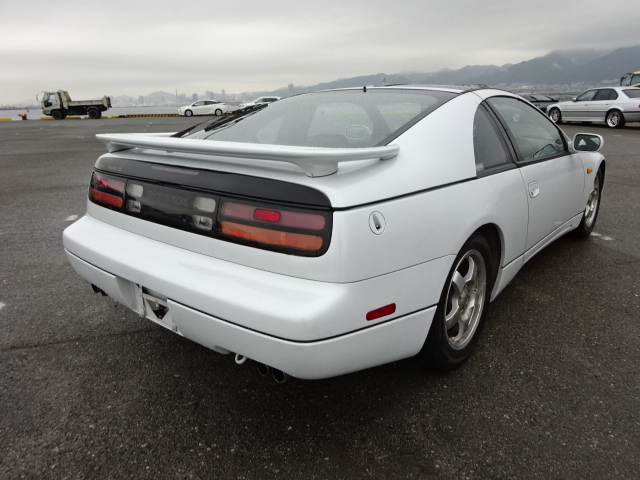

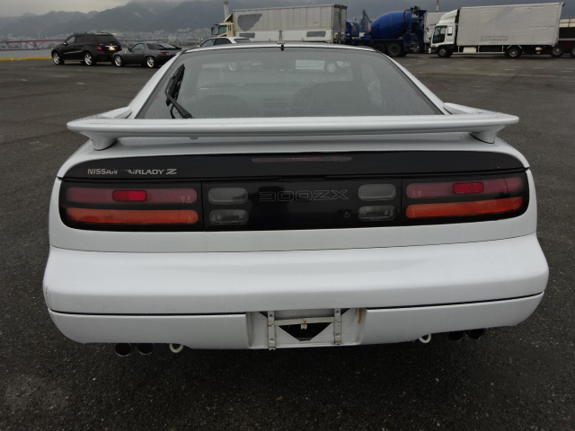

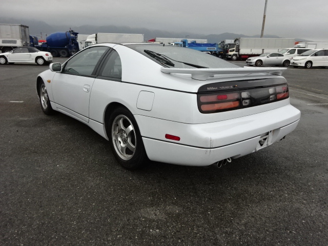

Gazwoz sent over some pictures of my new zed from the docks in Japan :cool3: Looks like delivery will be the end of August so still a long time to wait yet :sad:

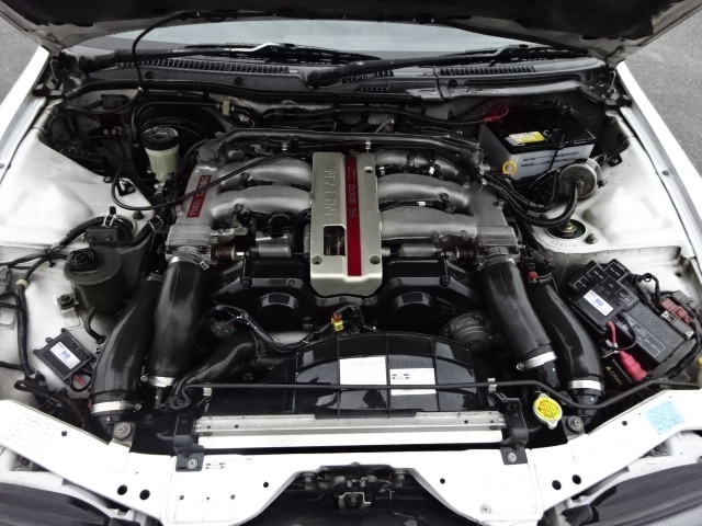

Couple of bits that will need looking at but I'm still very pleased with it :yes: got worried for a second when I couldn't see the power steering thing under the bonnet, but then I remembered it's got the electric hicas so I suppose it's that!
Does look clean! Very nice! I hope the first thing you do is replace those appalling wheels though!
Oh god yes I won't be able to jack it up quick enough! :hammer:
Interested to find out what the suspension is as it looks lowered to me, auction sheet just said "possibly lowered"
